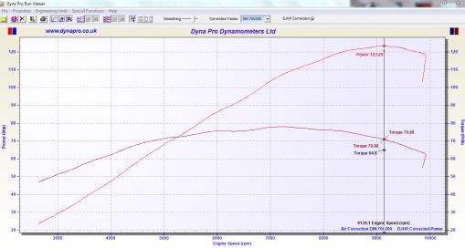

    Mr R's lardy 851,916,955,984 with its corse parts and extra valve!!! Makes 128Bhp & 77lb of torque, a very impressive output from a garden shed.................However!!!!!
    On the basis of weight my lil 'Bandy' makes 123Bhp & 78lb of torque (Compared to a standard 2valvers 73Bhp & 58lb of torque) & comes in at 167kg fully wet.
    So on weight alone the 'professional built motor' - but bike cobbled together in a garage in Callington (Not a lowly shed) by a submariner with no Ducati experience makes 133bhp and 84lb of torque!
    I wonder what it would make with bigger valves (Will stay away from the extra ones as they weigh tooooo much!) Corse cams, light weight parts walldy, walldy, walldy ......and 2300cc big bore kit!!!
    Lil 'Bandy' keeping up with WSB derived road bikes......oh the shock :tongue:
    I shall wait for response :cool:
  15. Here's a bigger pic - wouldn't want some of the older members of the forum straining there eyes!
  16. Just nipping out to buy pop corn!
  17. I see I should have put bigger text the 10Bhp is on a power to weight basis!
    As for the dyno print out same dyno as yours shippers!
