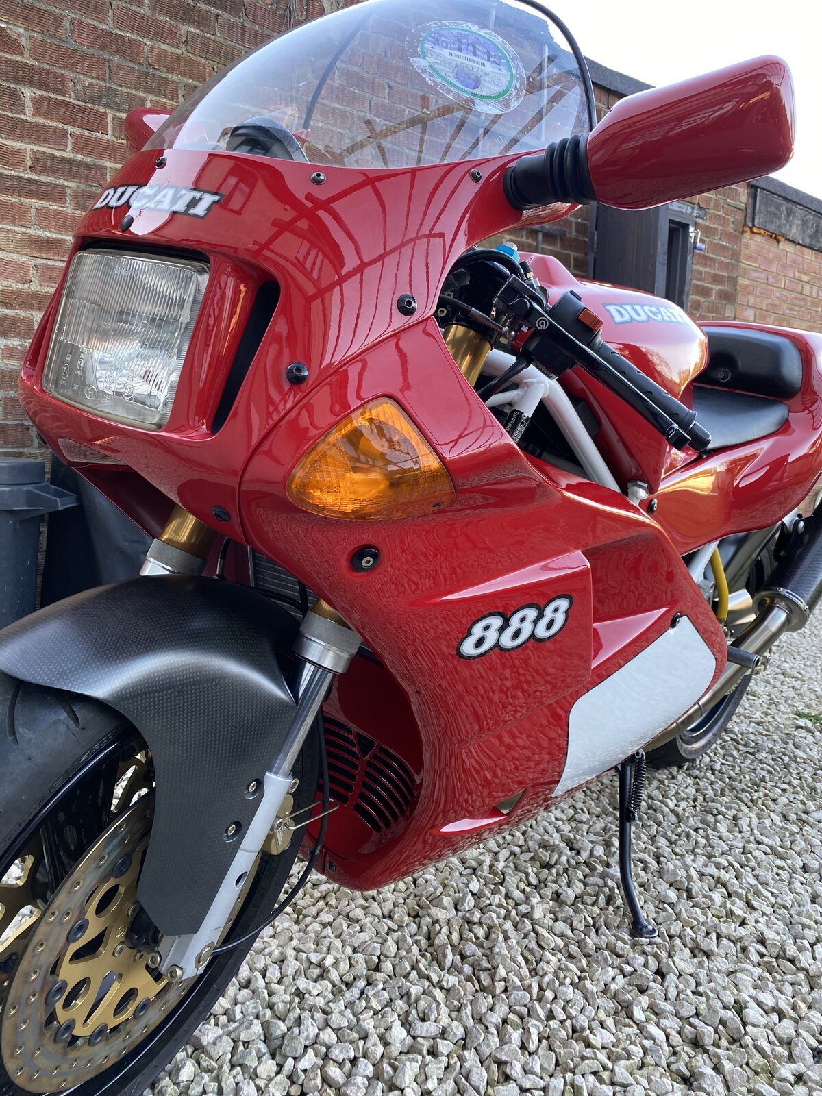

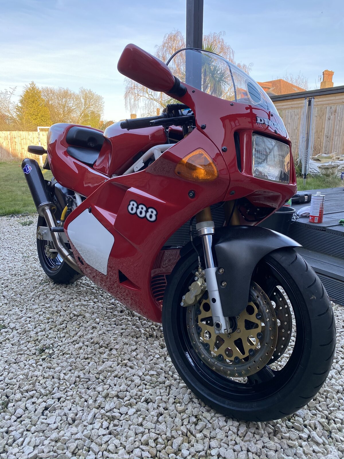

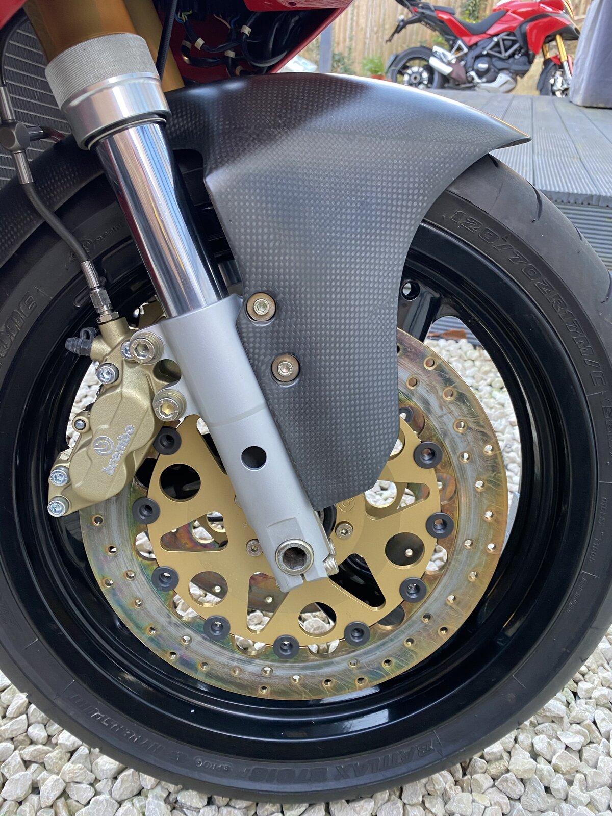

  7. 5AC72AAB-7557-4F52-8AD4-E46D9BC8F8FF.jpeg 95DE24D0-2931-41C9-A00F-4AF3EACDBD8E.jpeg 3278DA59-F071-4A83-ADE4-26AB47F93AE3.jpeg Should look like these
  8. Just leaf those 5 spokes in it,they look so much beter then the stock 3 spokes.
    Henk!!!
  9. Can you please load up a picture of your current Marchesinis's wheels please.:thinkingface:
  10. Thanks for the pictures - nice and VERY clean!! :)
    God those Brembo fully floaters have never been touched by a brake pad have they! :)
