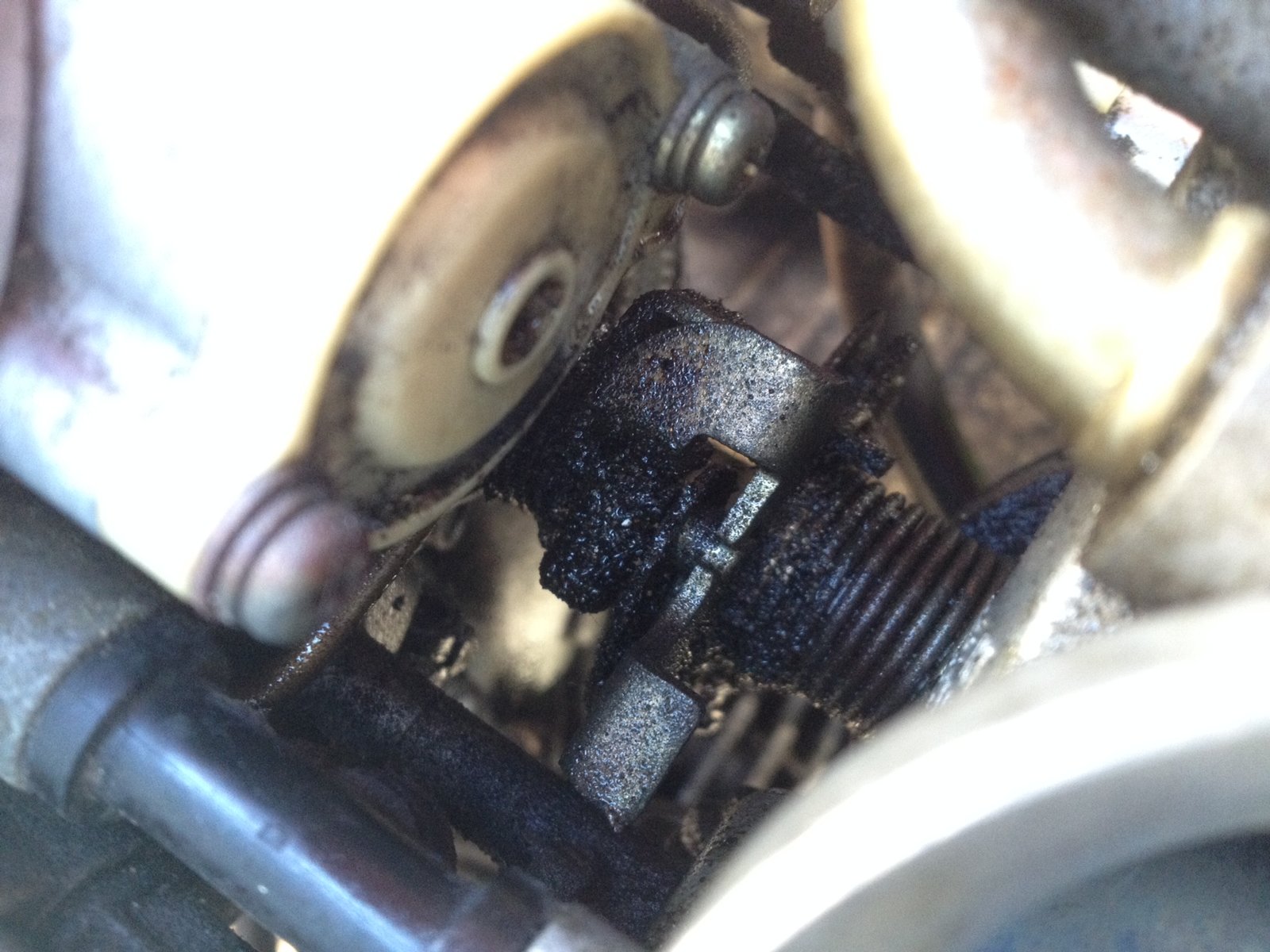

    #2 Sticking Throttle
    Just noticed that the throttle grip isn't returning/springing back to it's normal position.
    It feels sticky, and has to be physically wound back in. Is this likely to be the throttle cable or the internals of the grip itself? What's the best course of action, strip the whole thing down?

    Re the throttle grip not springing back. The last time I had this issue was down to the amount of crud sticking to the return spring between the carb bodies. Very difficult to even see let alone to get to without having the airbox off. Maybe a good spray of WD40 aimed up between the carbs might help

    Sticky throttle could be muck at the carbs as suggested above, cables need lubed or no free play in the cables.

    Cables as above, I would remove them at the carb end and check for free play by twisting the throttle, that will tell you which end the problem is at, carb or cable. Make sure cables are lined and that they run without kinks anywhere as this can pinch them inside.

  6. Sticking throttle - get hold of the rubber grip and force it away from the twistgrip cable housing, so that grip doesn't actually touch the housing.

  9. Well I did manage to hoik out the airbox and access the mechanism where the throttle cables meet the carbs.. Crud city. Plenty of WD sprayed around there seems to have improved things quite a bit. Maybe it's worth replacing the actual cables themselves with new. Not unreasonable for a 23 year old bike.
