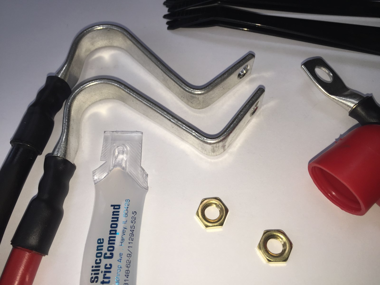

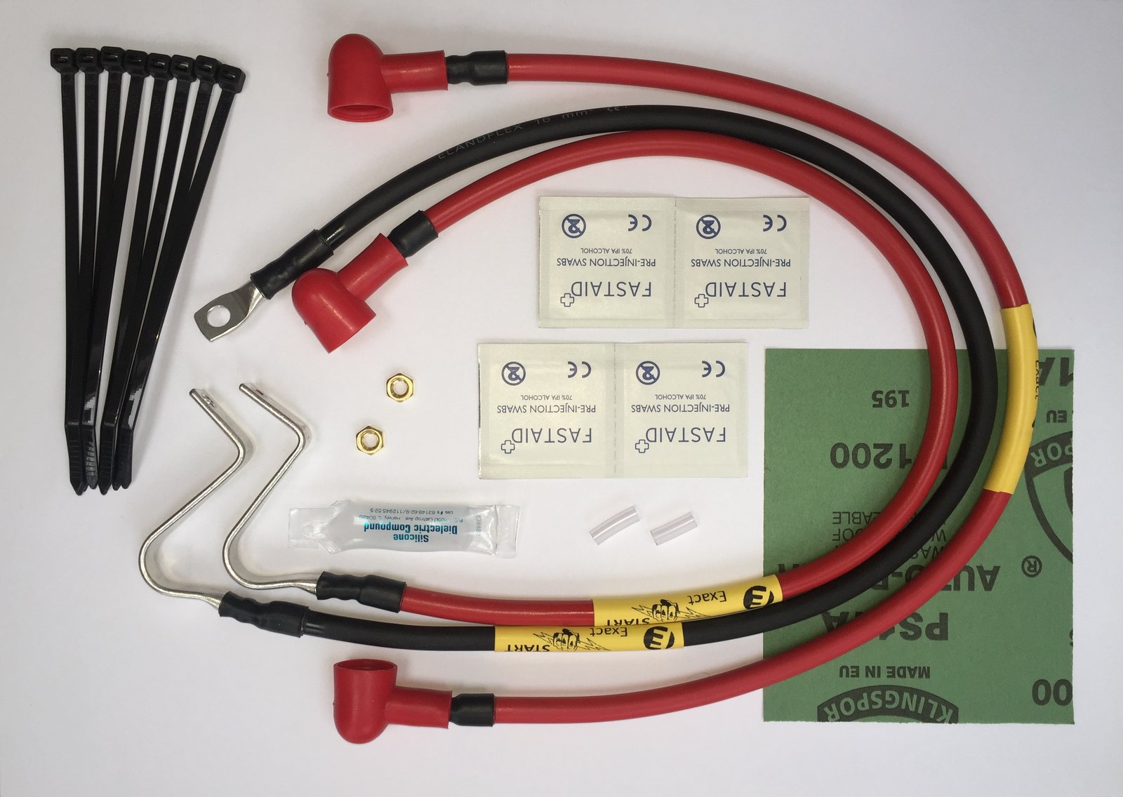

  7. Not sure how many kit's I have sold now - but cetrtainly hundreds with only great feedback which many will have read on here.
    The prototype Sport Classic Kit was fitted to a bike that for some unknown reason ran rough until swapped back - it span up fine but had an issue which is really beyond electrical science if the cables caused it. (unless @AirCon or anyone else can shed any light) i.e. there is no known reason how the could have been the route cause. It is a mystery.
    Many Sport Classic kits have been sold since with no issues and all my own and California Cycleworks products are warranted anyway.
    The Sport Classic kit was enjoyable to work on due to the complexity of the terminal design - this to allow fitment with no modification to the fully enclosed battery box. The 2 terminals alone were initially quoted to me from my specialist manufacturer at an astronomical price which would have pushed the kit price up towards the US kit prices! It took a lot of haggling to get them back down to enable me to get a reasonable price point.
    Here is the Sport Classic Kit: the last picture shows the un-plated prototype terminal fitment (production are tin plated) at the battery box.
