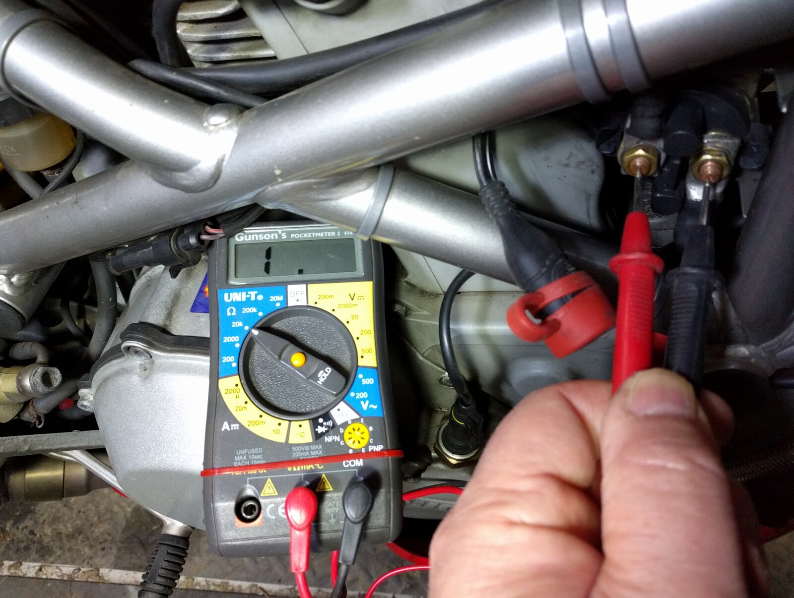

  9. As I have the battery disconnected, I presume I can check for continuity across the battery to starter terminals on the solenoid? If there is, the solenoid is stuck on?
    Thanks Stu, I hope it is just the solenoid! I know you're just winding me up, it's more likely that Steve Wells at Zen may have overtightened! Keeping my fingers crossed. I hate to think what a problem with one touch would mean..
  10. Re: Continuity test, yes, good idea.
    I have the same starter system on two uglies and it’s yet to play up on either of them, no idea how it works as never had to investigate.
  11. OK, so did the continuity test, first time I tested it showed 547 ohms, so not open circuit as it should be. But when I went back and did it again to take a picture for you guys, it was showing o/c which is what it should be! Confused.com. Guess I should replace the solenoid anyway. IMG_20190413_182134.jpg

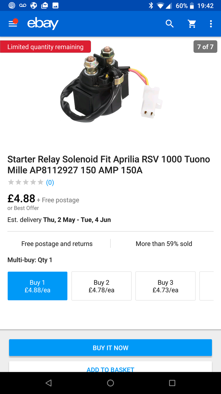

  13. Is there a non-genuine replacement for the solenoid? I mean not at Ducati parts prices, like my Vauxhall Agila oil pressure switch!
  14. So I guess the part no 39740021A described as "remote switch" is what I want. Although I can't see the other leads that switch the solenoid in this diagram. On the bike there appears to be a connector block and two thin black leads that go to the side of the solenoid. Screenshot_20190413-185925.png
  15. They changed the Hitachi solenoid to a different type with a fuse within it on later due catty, this is a more common unit used on Hondas et cetera. I’m not aware of any pattern part replacement that is a straight fit, but someone else may have come across one. Basically, any 12 V solenoid will do, it’s just that you then have to change the tiny plug that actuates it and make arrangements to strap the solenoid in place.
  16. Thanks Chris, I'll try your fettling instructions first before replacing. I notice they don't show the actuating lead and plug in the parts diagram although I assume this comes with the solenoid?
  17. This looks very similar, but I can't wait for it to be delivered from Hong Kong! Think I'll give Snells a call on Monday if Chris's fettling tip doesn't work Screenshot_20190413-194232.png
  18. actually - come to think of it ive got a spare relay from my hypermotard (1100) - would that do the job? your welcome to test it first if you want...
  19. Hi Comfy, many thanks for the offer - does it look the same, with the actuator lead and plug (although not shown in the parts list)? If so, I'd like to try it, happy to pay what you want for part and postage - I'll still pay the postage and return if it doesn't work out.
