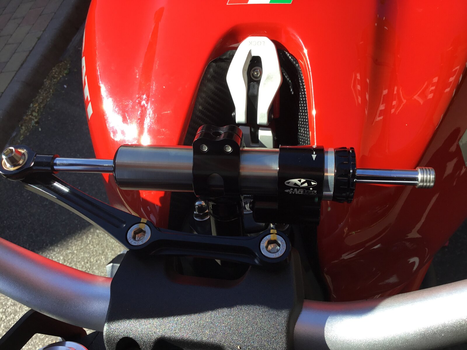

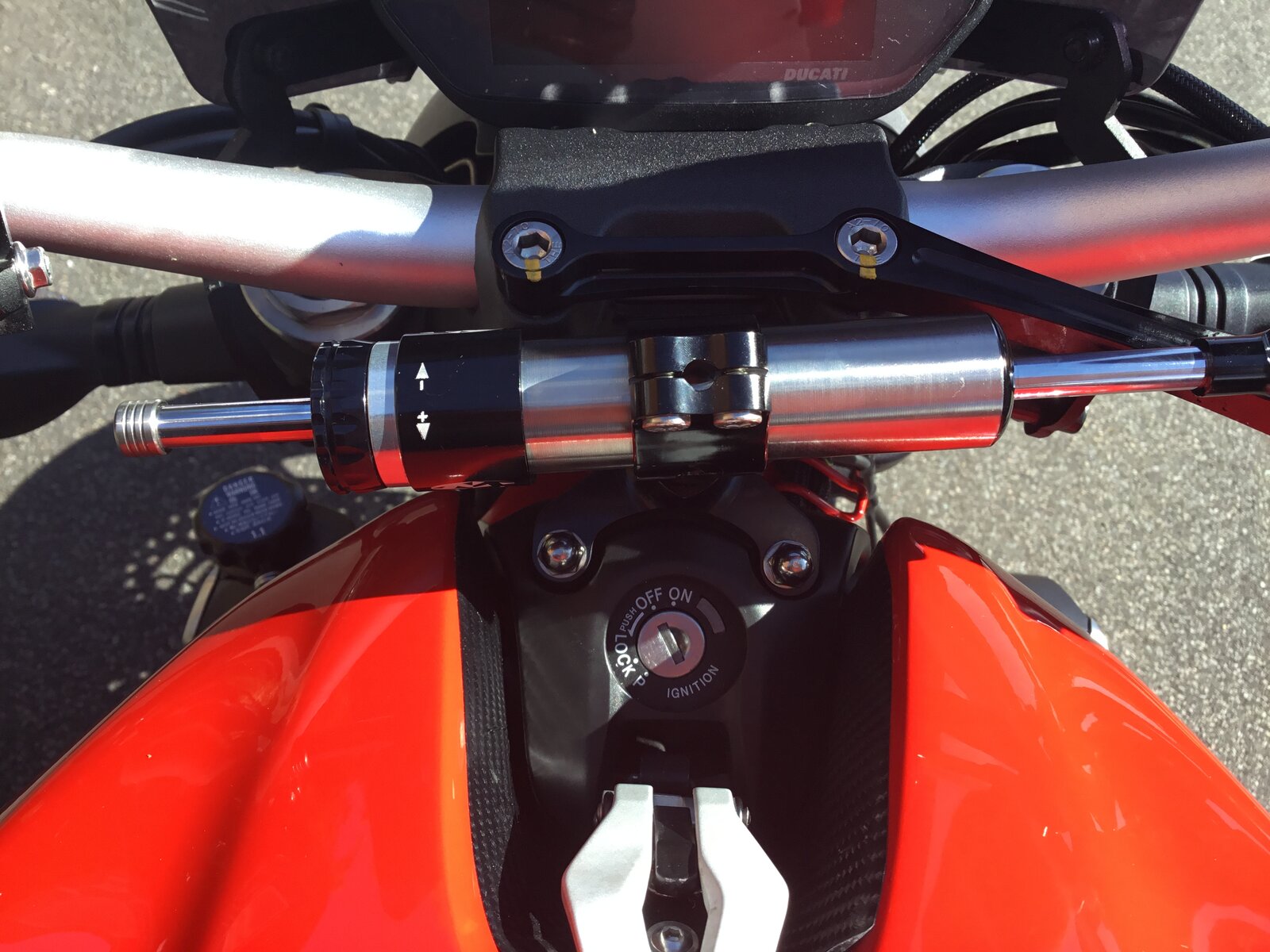

  8. B44D7896-9C08-41D1-814C-6843EB4C63B6.jpeg B0F497B5-261D-4105-8285-24DD44B17104.jpeg Fitted this to my M1200 took 1/2 hour everything lined up and fitted perfect, beg steal or borrow a low torque wrench 5Nm and up.
    And follow the recommended torque settings, that way you won’t under tighten or overstress the fasteners.
    Made by Matris
    #8 hypermotbloke, Jul 22, 2019
  9. Really nice setup. Good one.
  10. How much for the damper and brackets?
  11. Got this on eBay (bike torque racing) SBK set £435
    Fast delivery.
    11 settings I think the R version has 13.
    As I ride on road I did not see the need for the racing set up
