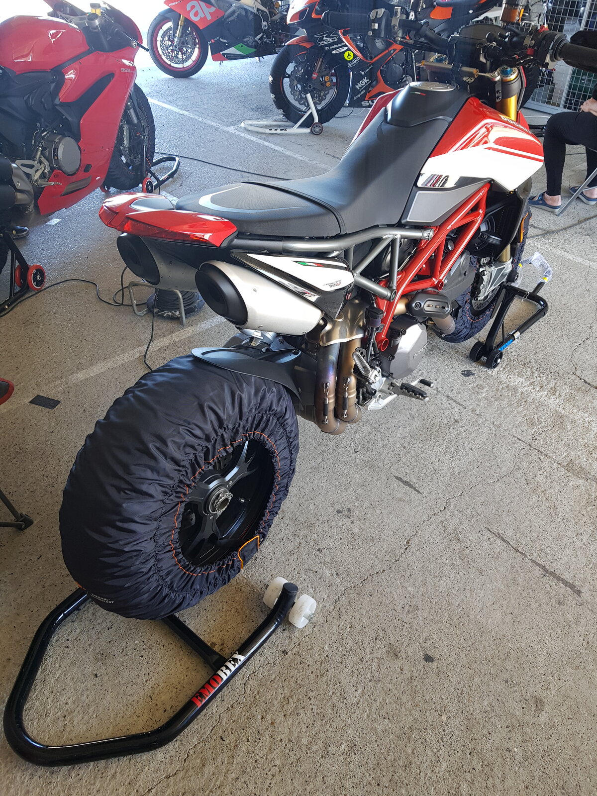

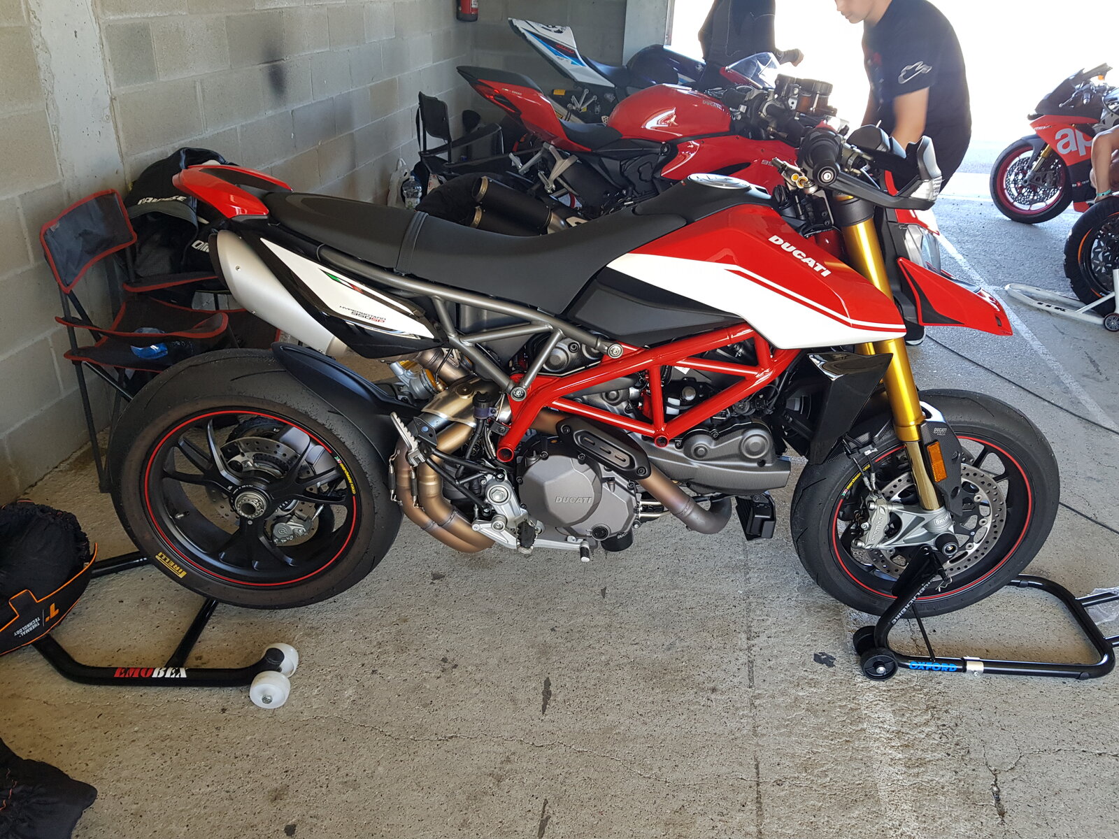

  3. Hi! I have the original ohlins from ducati in a 950Sp, worth the money, i can go at 200km/h and no problem i feel safe. (in the "track")

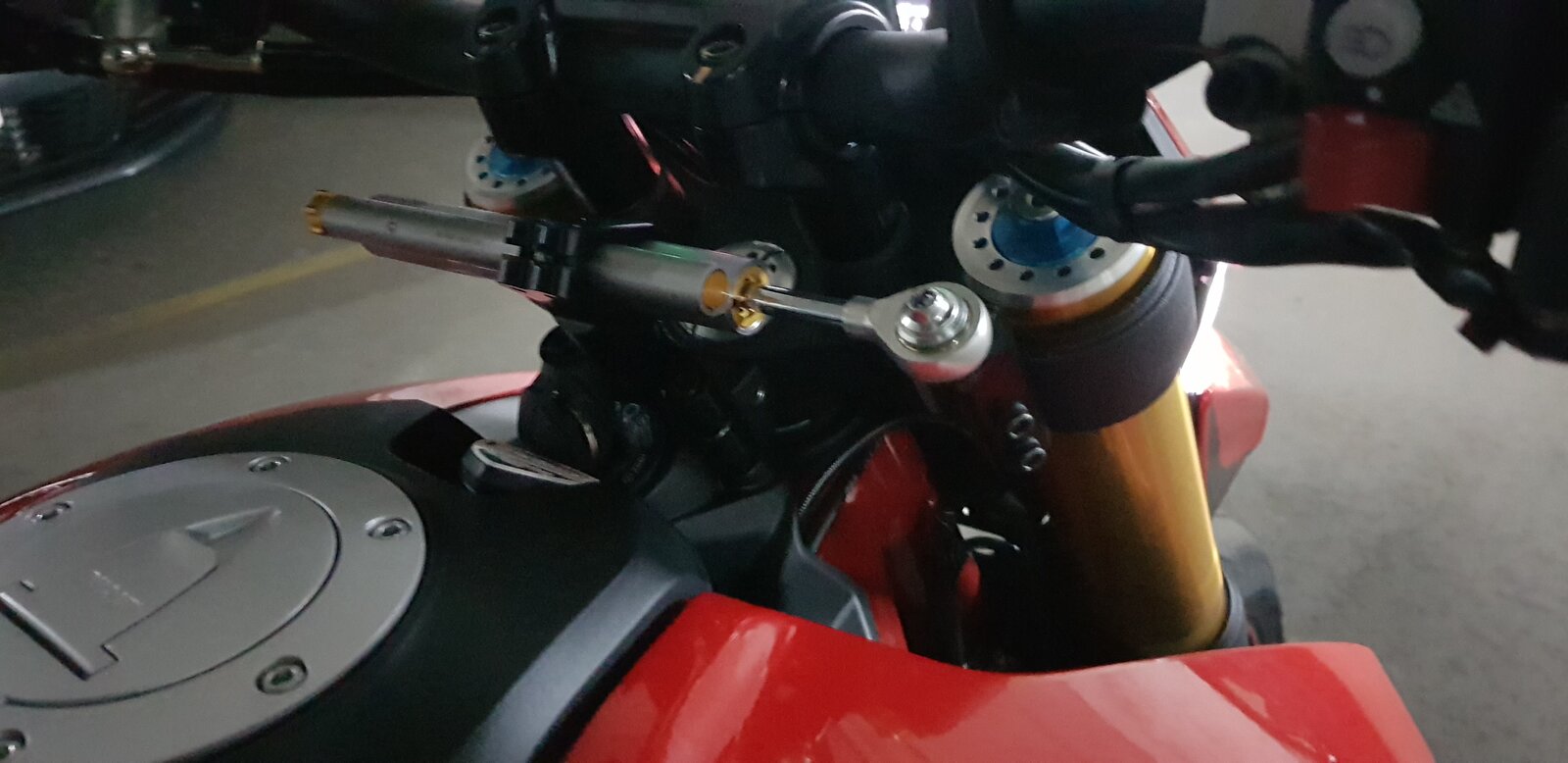

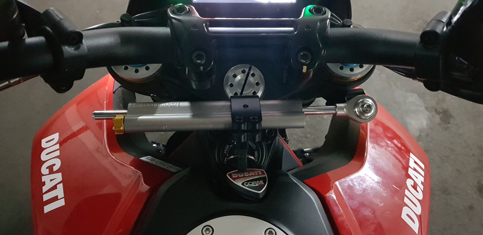

  4. Noticed something about the Ducabike damper setup.
    Watch the attached video of my installation.
    I have the Ohlins damper set to max resistance. The bars are still very easy to move, and at the end of the range, when the bar hits the stop, there is some creep in the damper rod which indicates some elasticity in the system not being taken up by the damper. It indicates some flex/bend of other component(s), perhaps the attachment brackets.
    Furthermore, I find it odd that at max resistance the damper does not practically lock the steering.
    What say you?
  5. I'd say that the damper operation is compromised by being attached so closely to the steering axis - you're getting very little linear movement. Also, yes, there's some flex in the system which, combined with the max setting, is making it 'creep' at end of travel. I thought (limited research done) that the only suitable hyper damper is a rotary (ugly) one...
  6. Further investigation, which I will catch on video when I get another set of hands, reveals that the center bracket actually flexes under load with max ohlins resistance.
    Crappy damper bracket design seems to be the issue. Disappointing.
  7. Be interesting to measure total damper-rod movement as it looks like you've got very little. Dampers need travel distance to absorb the energy they're asked to get rid of. This is why you've had to set it at max.

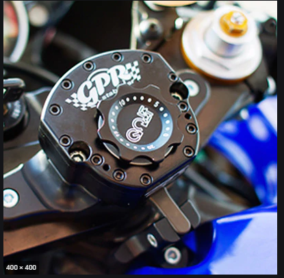

  8. Interesting point. Yet, I have a center mounted GPR damper on my R6 and that has very little lever arm being center mounted, but it works like a charm.

  10. I have the ohlins damper on my hyper and it works perfect and without flex. You need to loosen the clamp and move the body more to the left. Mine does not use up max travel at either end when at full lock.
  11. That is easy enough to try but I am not sure why it would make a difference. The clamp mount is not sturdy enough to withstand the force against it when the damper is set to higher resistance levels. The actual bracket bends.
    I will try as you describe and see if that make s a difference.
  12. It will help a lot. I managed to get a ride in on mine (winter here) and it made a signifcant difference in feel with just five clicks in from full soft. I have never needed a damper to be close to full stiff but I know everyone is different. Set the damper body so you have equal rod length at full lock left and right and so nothing bottoms or binds,
