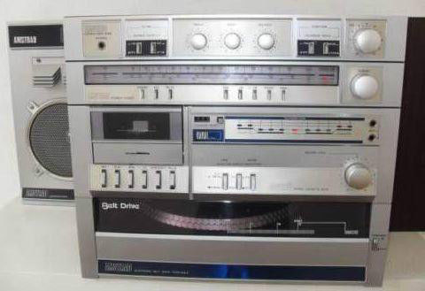

  11. I thought technology has moved on from stereo
  12. If the system powers up and works, this is either a faulty unit or a simple fix to my mind mate. Gi
    Fuck me!!!! Whats that ?? That looks way more advance than the one in our gaff
