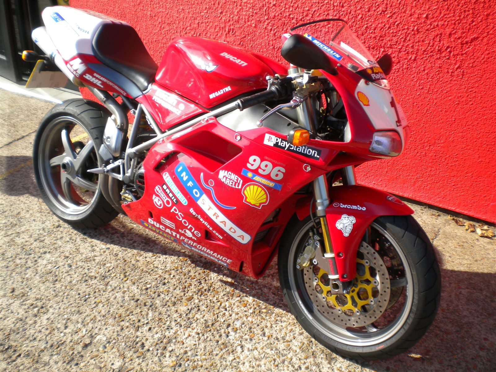

  12. cheers for all the replies - havent been brave enough to get the hairdryer out. Appears on closer inspection (and also a receipt) that one panel was repainted - you can see this - no idea why, dont think accident as all others appear original and new and no scuffs on the frame or anywhere else - i think too many stickers so will work on it, but this is it in it's current state..... You cant see too many of the stickers here, but there are loads I dont think should be on it!
  13. Um, this was mine when I bought her.
  14. Blimey!!! That was intense!!

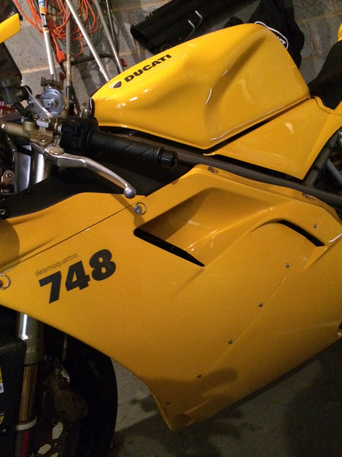

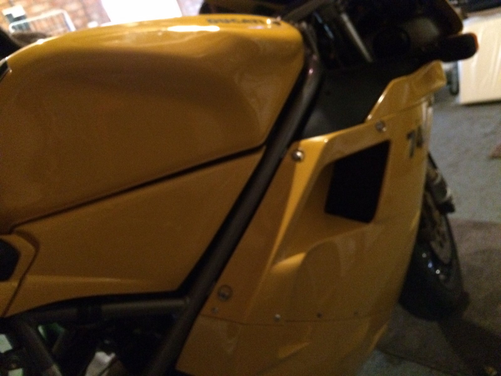

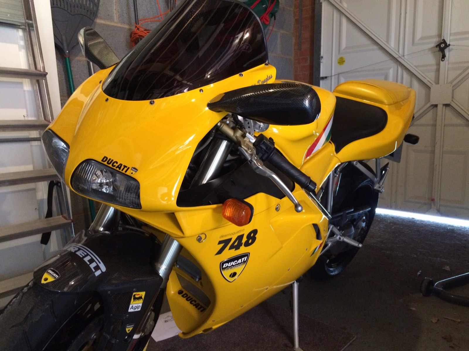

  15. This is her after the hair dryer / WD40. I was a bit worried what I would find underneath but all was peachy apart from the rear seat unit. I can live with one panel needing a re-spray. I'm waiting to a VERY hot day in July and will go out for a long ride, park her up for a bit, then have a go at the front number board..........

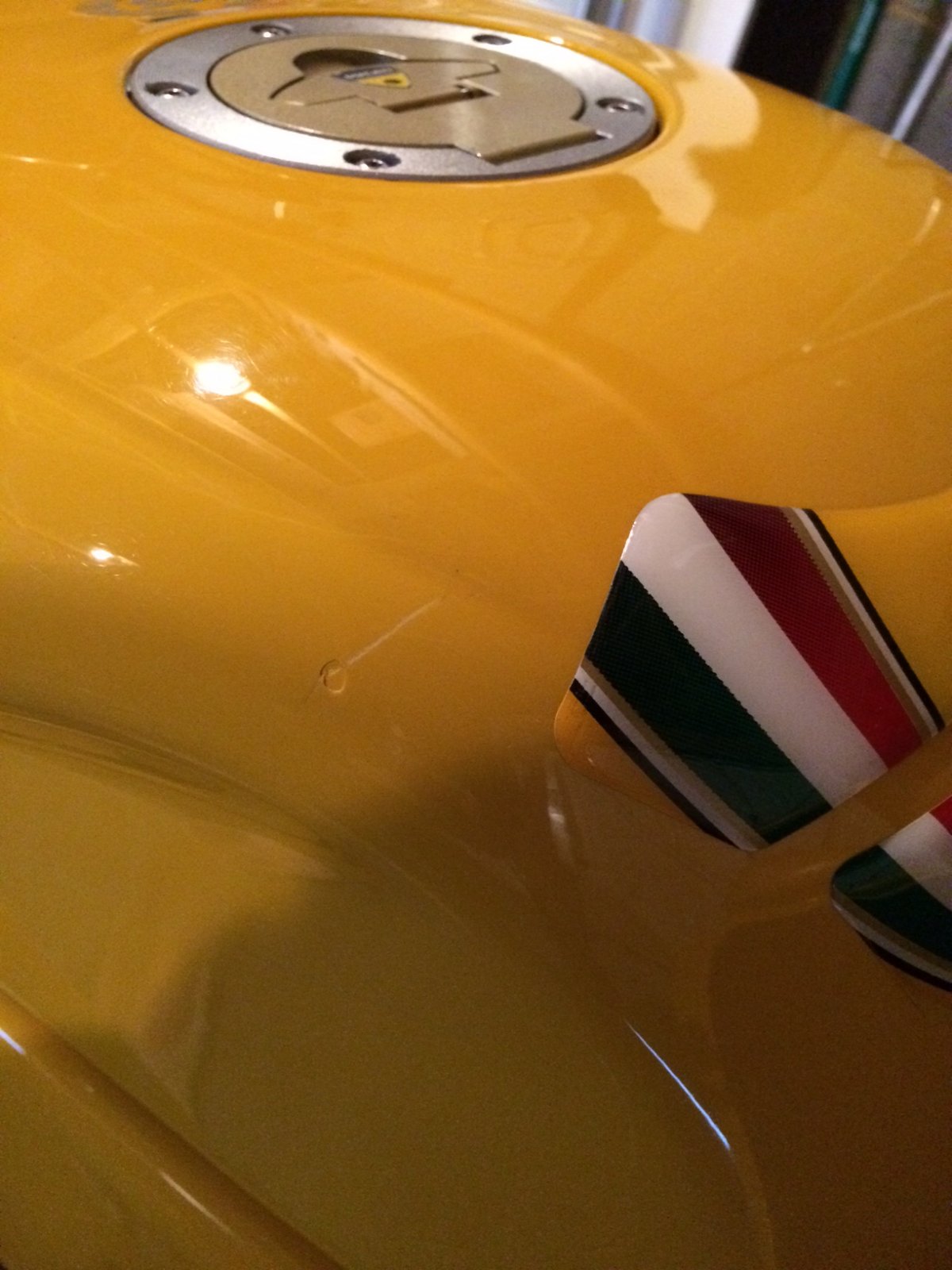

  17. typical!!! couldnt find the WD40 when I needed it BUT I did make a start on the stickers - only found one stone chip and blemish on the tank so can live with that for sure!! just the residue to get off but was surprised how easy it was - am leaving the tankpad for now until I get an alternative sorted!
  18. You could probably get that out by filling with some paint touch up and then rubbing down with 2000 grit wet and dry and then a touch in with some lacquer.
