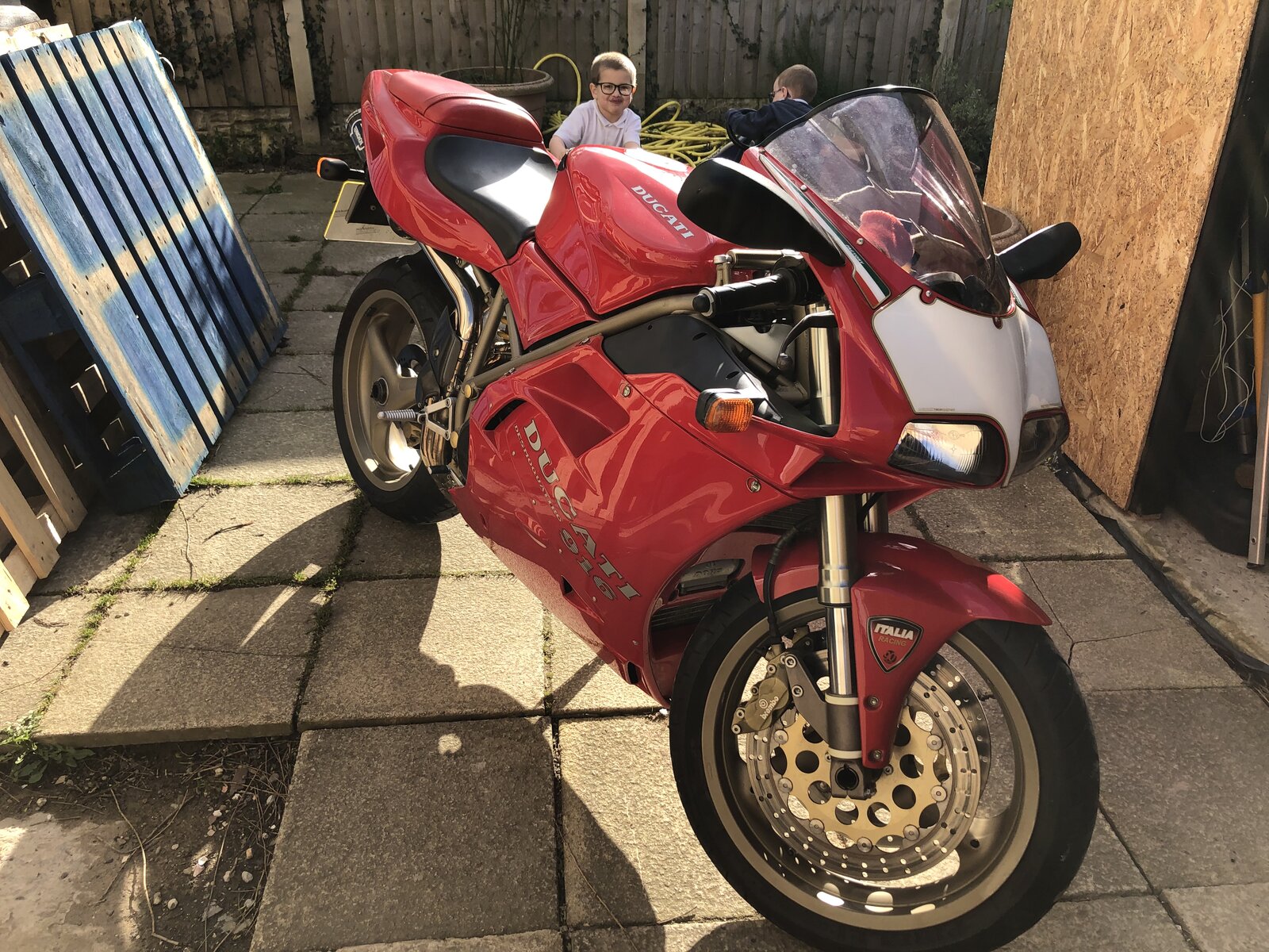

    I am going to be removing the stickers from the motorbike. By stickers I mean the non standard ones on the nose cone.
    How is it best to do it I have debadged a lot of cars in the past using a hair dryer then using glue and tar remover or a similar product to remove the residue is it the same process for the stickers on a bike?

  2. Trickling hot or recently boiled water from the kettle over them as you go works well.
  3. Hair-dryer which should take a fair few minutes to get just right, moving over a wide area. So that you can peak it off in one nice go. Though not a heat gun.
  4. Take the mirrors off, use a hair drier and be very patient and work progressively with the heat. Be careful with the bit between the lights and make sure it is warm there otherwise it may take the top coat off
  5. Just do it the same way as cars but be aware the white number board is slightly thicker so will require a bit more patience and effort
  6. Patience and effort? bugger that, use a hammer and chisel instead!
  7. Pray that they have not lacquered up to the edges of the stickers or it’s respray time (or new stickers).
  8. I lost my top coat doing this very job a couple of years ago no amount of heat or patience helped but on the upside I got the pristine front I wanted ! Good luck on it !
  9. The white one at the front is peeing between the lights so I’m hoping I won’t have to many issues
