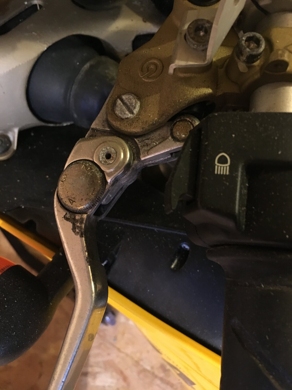

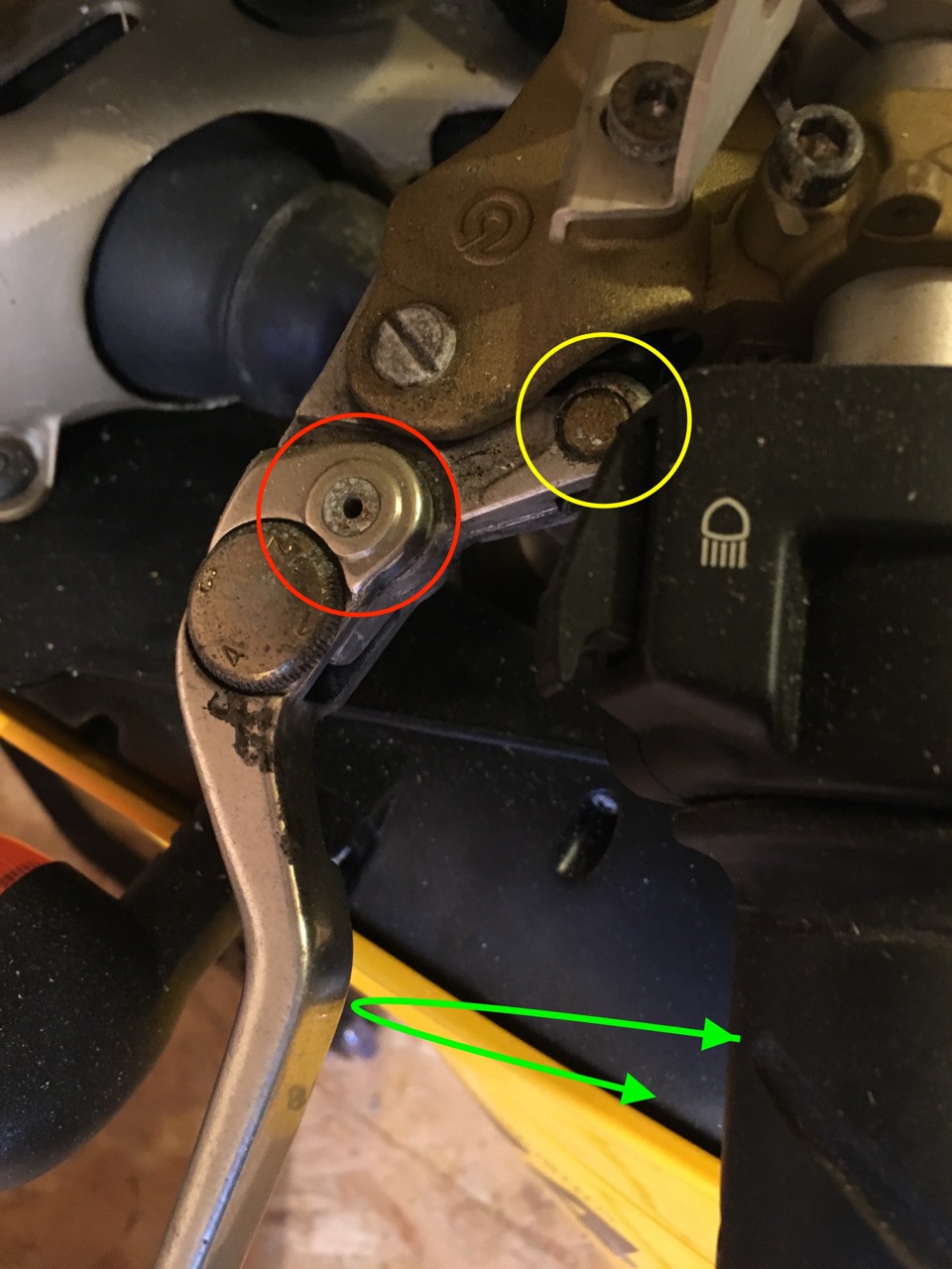

    Do you have adjustable levers? Poor picture (and example) but it’ll have a round knob you can adjust to bring the lever closer or further.
    I know that’s the clutch side but the brske’s the same.
  15. that is what I have got but tried all positions and did not help. is that what is used for free play adjustment?
  16. It's not what's used for free play adjustment, I was just determining what levers you have. When the round knob is adjusted it pivots around the red circled pin either reducing or increasing the distance (green) between the lever and the grip. The yellow circled pin is where the lever which actuates the brake cylinder piston rod is connected. I'll take a look at mine later and post more pics to try and help.

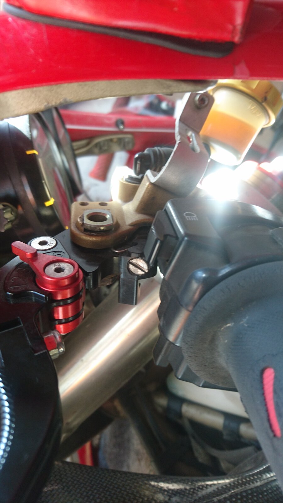

  19. Here is mine, they are after market levers but just the same as my standard ones, the adjuster is the screw for the flat head screwdriver, I have about 5 to 10mm play at the end of the lever before I feel any sort of pressure other than the lever return spring.
    Steve

  20. Paul, it seems that I have got the same as yours so no adjustments, can I adjust a free play on this type somehow?
    I drained it to empty as was changing all hoses and clips and wanted to clean reservoirs as well. Any issue with that?
