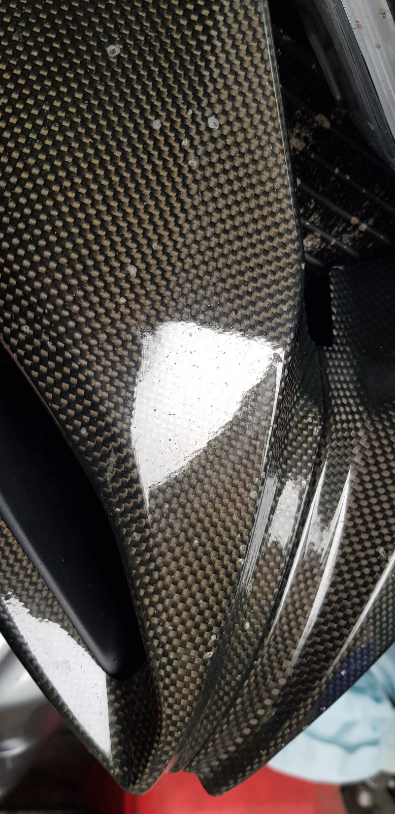

  1. As the title says, my bike has a bunch of these after 10 years of use (clearly following my stone throwing friends too closely).
    What is the best way to deal with these ? (the chips, not the friends :yum)
    Can I fill them with clear nail varnish or is there something better ?
  2. Araldite Crystal, sand down, lacquer.
  3. Wet and dry, not sandpaper. Oops. And leave the araldite to cure for a good couple of days minimum.

    Its DP carbon air inlet / beak on my multi. I think they are in the Gel coat. I will try to post a picture.
  6. Thanks Jack, I did think it would be wet and dry ;):upyeah:
    I have a selection plus some rubbing compound to finish off.
    I will buy some araldite and give it a go :)
  7. Heres a pic. This is after 30k miles. Wish I had put some PPF on them now but shit happens :rolleyes:

  9. And PPF it when you’ve sorted it :):upyeah:
