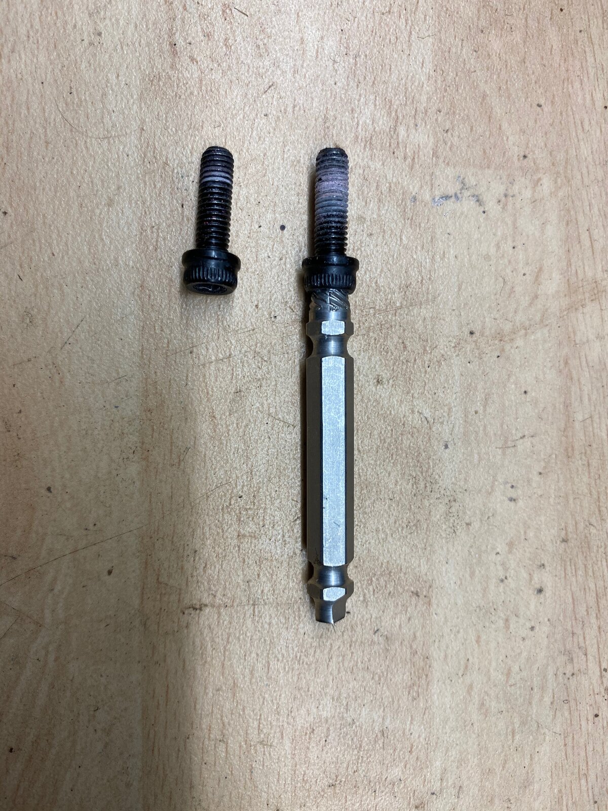

    If you do go for aftermarket wings be very careful when removing the bolts. I had to remove my wings to fit crash sliders and ceramic coated rad surrounds. The bolts are held in with Loctite and the 4mm hex heads are cheese like. After rounding off a few I had to use an electric impact driver and a stud remover to get the bolts out.

  3. cheers. can vouch for the loctite and cheese bolts. must have used the same on the heel plates - knackered the bolts changing those over too.
  4. Anyone able to check the bolt size for the wings? M5 x 16mm, 0.8 pitch??
  5. expect i'm going to need a few once my new wings arrive so any info here would be good :upyeah:
  6. It’s ordered the size in my post.
  7. matter of interest who did you order them from? cheers
  8. Just ordered stainless from Amazon. Fitted them last night.
  9. I did the same on my heel plates. Never had the issue before on any other bike.
  10. cheers just ordered pack 20, reckon going to need them with bunch of parts to fit :upyeah:
