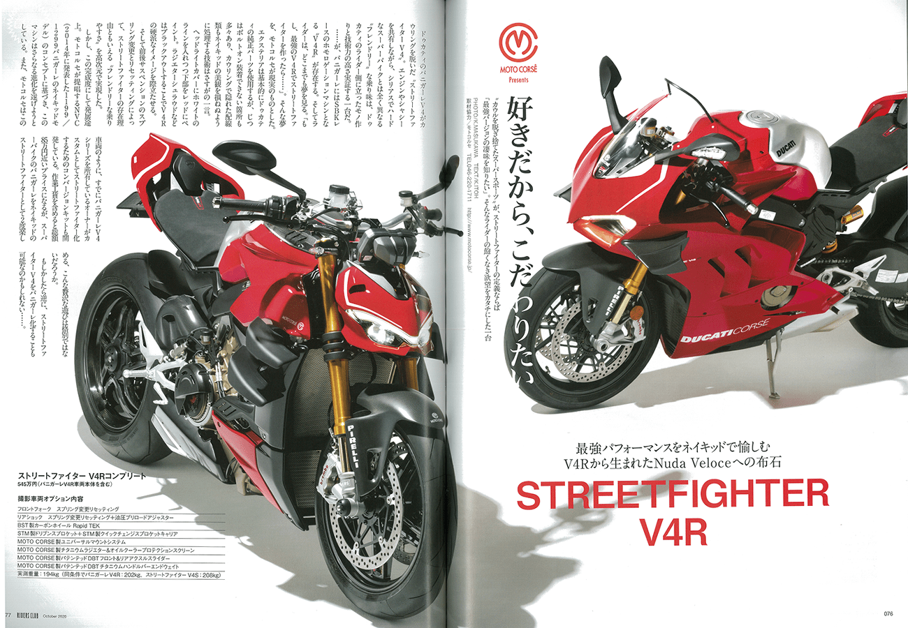

    I have a Panigale V4R, and have plans to convert it to a Streetfighter V4R.
    Is it madness?
    Has it been done before?
