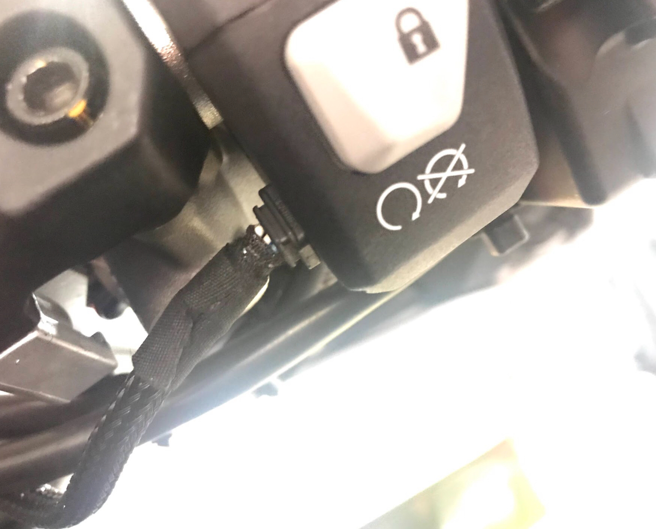

    The bike has Ducati heated grips which are a dealer fit item, so one of my thoughts was damage to the kill switch when the throttle actuator was swapped for the heated one. When I took a closer look I realised that the throttle actuator housing doesn't contain the kill switch, but that the wiring to the housing holding starter button, kill switch and heated grip control has some exposed wiring.
    To help eliminate lines of investigation, does anyone else have a connector looking like this? If not then the switch housing needs a closer look.
    Cheers
    Neil

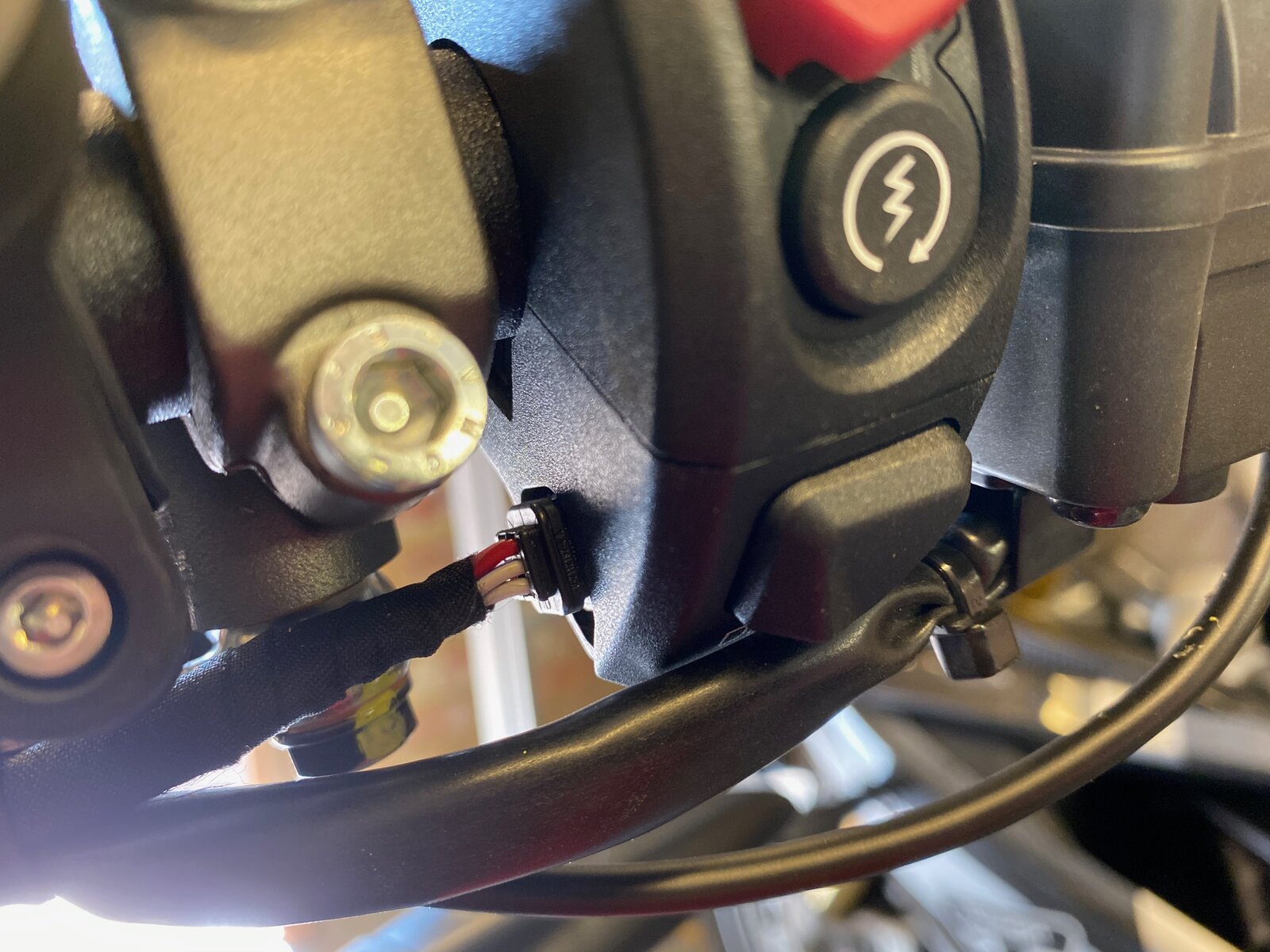

  2. If it’s any help, I had similar problems with my Multistrada this year while in Switzerland, bike wouldn’t start, completely dead and unresponsive on the switch. Got it powered up on the pin code route but kept stopping. Had to get Ducati breakdown to recover it to nearest dealer (90 minutes away) in Bern, once there the guys plugged it in on the machine, no fault codes etc but still no sign of life. Not until someone noticed that the starter switch was illuminated all the time did we get anywhere, turns out the switch was faulty and after a quick swap with a new unit all was good again!
    Maybe be worth a check anyway?
    And here’s a photo of the wires/connector on the Multi
    • Useful Useful x 3
  3. That's great input. I'll take a closer look at the switch this weekend.
  4. It may be worth checking the starter relay. They have a maddening trait of going intermittently, exactly as you've described, when they begin to break down.
