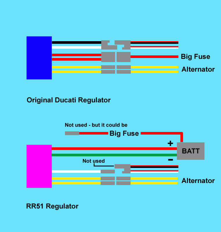

  7. Can you get the make of the reg/rec? I think know what the problem probably is, particularly if it is an Electrex RR51 reg/rec.
    I'll post a pic to help you trace it - it is the white wire that sometimes doesn't get connected.

  9. Here's the RR51 set-up compared with the OEM one. Note the red/white wire in the bike harness - you should find the connector somewhere on the left side beween the headstock and headlight - maybe lower down at reg/rec level.
    Note both reg/recs have a white wire - they are the ones that make the charge light work.

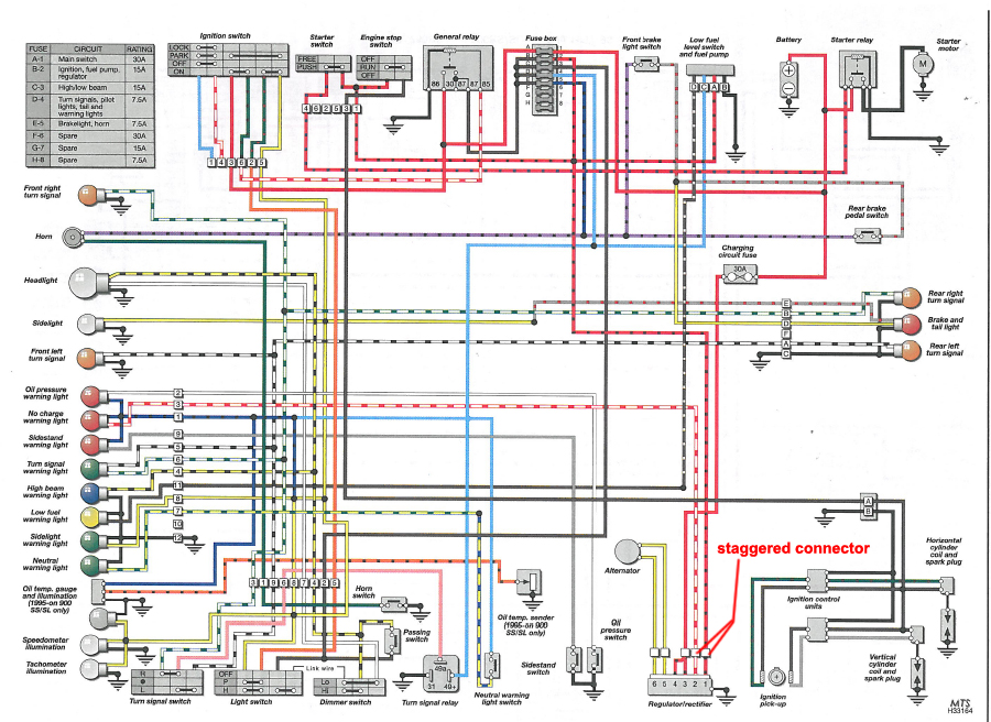

  10. Ok here's what i've found, from rectifier 2 red/white 2 green...from loom white plug 2 red and 2 black...found a staggered connector with 1 red/black and 1 red/white, when I feed power to the red/white the battery light is on
  11. The staggered connector with the red/white in the harness is the one that does the battery light, so as you already have said you have two yellow wires which are the alternator to rectifier ones; without knowing which make your reg/rec is, my guess it has to be one of the red/white ones from the reg/rec you connect to the red/white in the staggered connector - it seems logical if you compare that thought with the diagram above.
    Again, not knowing which reg/rec and what you may have connected to the staggered connector - the other wire in the harness in that connector should be a red/black and IIRC live all the time or when ignition is on - it is not used with the RR51 reg/rec but it is used if the OEM reg/rec is fitted.
    I think some careful trial and error has to be used so you have to try connecting it and see if the light goes out when you start the bike - and switch it off quickly if it doesn't.
    Before you do that though, try finding out what the two green wires are connected to in the harness as it is obvious from the diagram and the OEM diagram that two wires from the reg/rec connector together into a single connector - which is the wire from the big 30Amp fuse.

  12. Thanks for your help but it seems this reg/rec won't operate the battery light, I've tried connecting the red/white to all 4 wires in the big plug and it won't work, from a bit of research
    using the wire colours I think the reg/rec is a shindengen SH673-12

  13. I found this on Ducati UpNorth Forum - by Derek who is also a member here. Don't worry that it relates to a 750SS - the wiring is basically the same.
    '750SS. If it is a carbed one (it must be with a 2-wire alternator) the earth was through the casing of the regulator. A white/red wire went to the warning lamp, a red wire to the battery via the 30A fuse and a red/black returned from the fuse box when ignition on. This red/back wire was to provide voltage sensing for the regulator.
    The new regulator doesn't need voltage sensing and has no connection for a charge warning lamp. Connect BOTH green wires to earth, preferably straight to the battery, and connect BOTH to the battery +ve, preferably via the 30A fuse.
    The fuse will protect the regulator if the battery is inadvertently connected the wrong way round. It will also protect the battery and wiring if the regulator becomes faulty and short circuits internally. I have had this happen on a 900S and the regulator practically melted with flames from it.'
    You could fit one of these - they work well.
