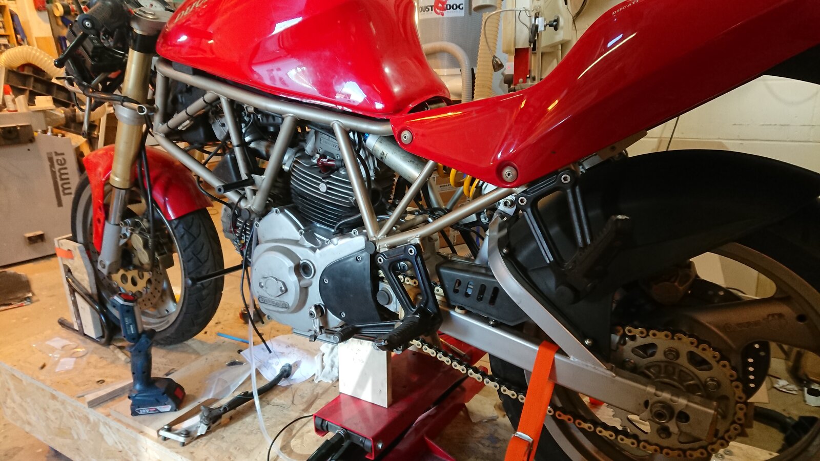

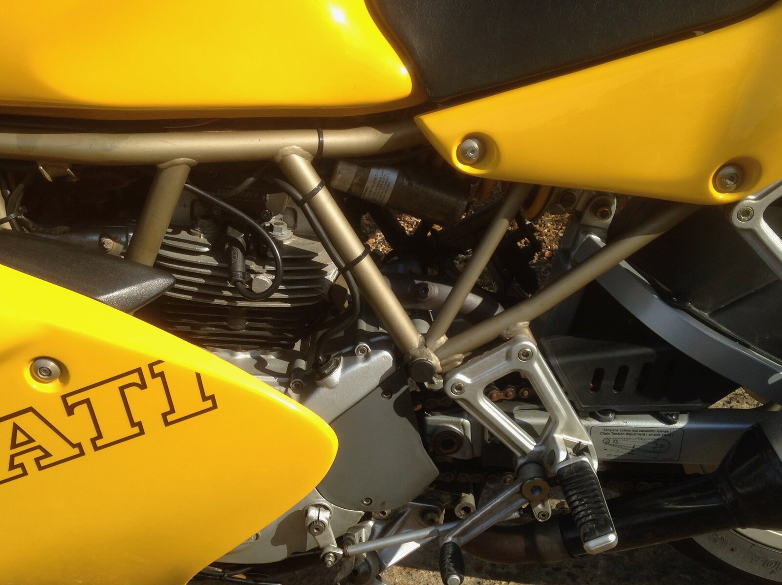

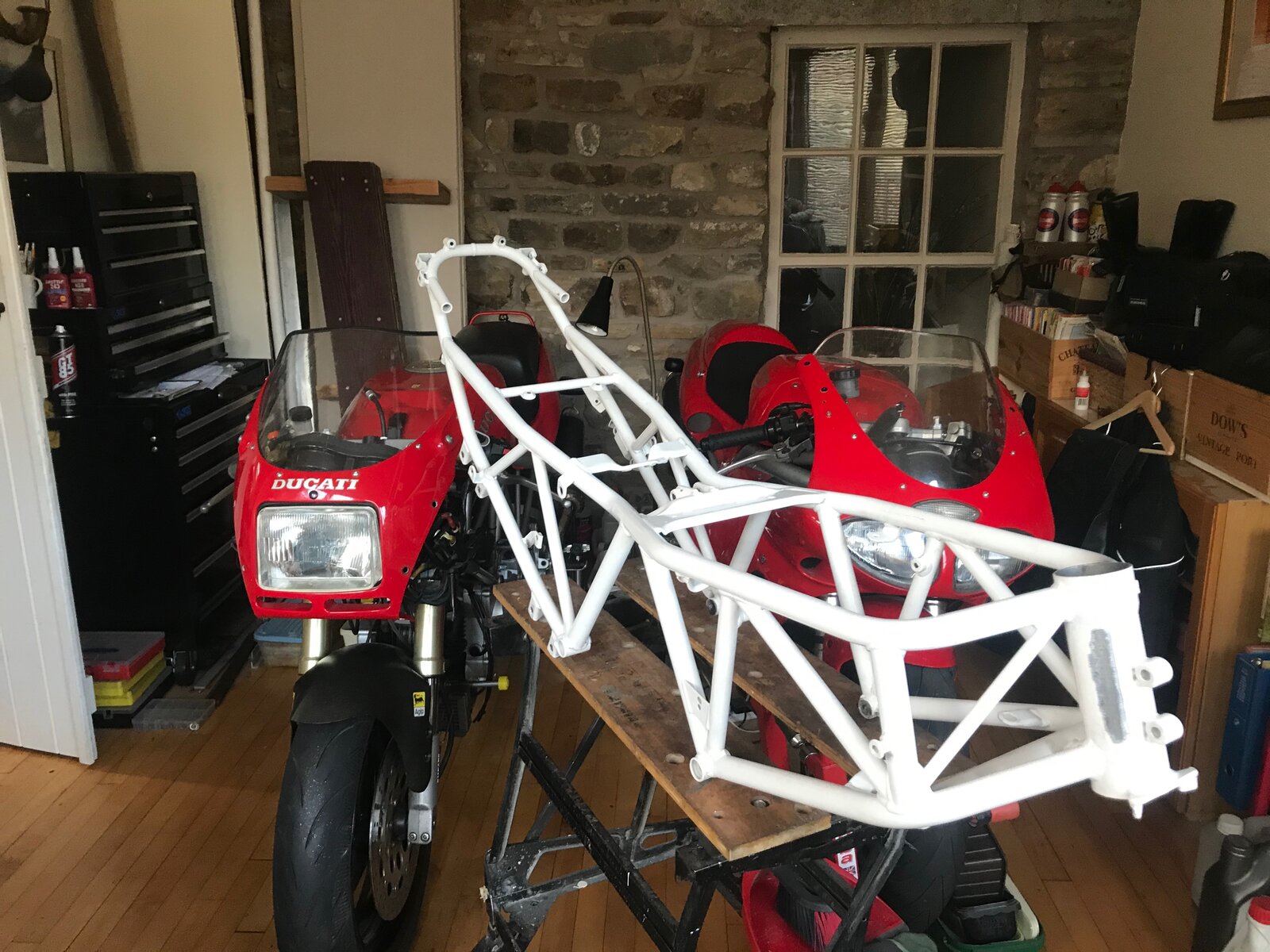

Been trying to get my head around the different frame and wheel paint colours used for carby SS models. It seems that after the 1991-92 white frame models, Ducati used a grey-bronze frame colour for a couple of years, then switched to a more gold-bronze colour after that. Wheels seem to be more varied in colours. An Italian paint company called Lechler lists a number of different Ducati frame colour codes available in aerosol or touch-up from various ebay sources but I'm struggling to decipher which paint is for which frame. Choices seem to be: DUC 99 Bronzo Opaco Telaio metallic (from '94) DUC 6 Oro Opaco Telaio metallic (from '96) DUC 35 Bronzo Opaco metallic (from '99) Opaco is matt or satin and Telaio means frame in Italian. Oro and Bronzo are of course gold and bronze. There's also DUC 45 Racing Gold DL metallic, but I think this is for later-model wheels. From the above paint codes, the frame below (my 1997 750SS, now sadly departed) is either DUC 99 or DUC 6. Can anyone identify which? Now how about my 1993 750 SS shown below. Is this DUC 99? Or is it something else? DUC 99 seems to be '94-on if the Lechler guide is to be believed, but this is a '93 bike. As for wheel paint, if anyone has any information on paint codes, maybe this too could be assembled into a guide to help others who are restoring their bikes. Having just acquired a frame (thanks Wayne) to replace the damaged one on the red bike, I am attempting to find the right paint colour to refinish it. The 'new' frame is currently white (see below), but I'm thinking it would better to keep the correct colour - if I can find out what that is! Any information gladly received! Martin.
Is RAL 1035 a close match for the earlier frame (grey-bronze on red bike) or for the more gold-bronze frame on the yellow bike? Not sure which year the frame colour changed but I think it was '94 or '95.

My 600 is red and from your picture the frame colour looks the same as mine. I bought a ral paint chart on ebay and that's how I chose pearl beige. I used 2K aerosol with 2K lacquer also bought on ebay.
Just to clarify, do you mean RAL 1035 is a match for the 1993 frame shown in my first post, the one with the red bodywork? If so, that's what I need. The yellow bike has the more gold colour frame and is 1997.
Perfect! That's what I needed to know. Thanks. The wheels are the same colour by the look of it. Reckon I might paint my wheels also. Not much else to do in these semi-lockdown times...

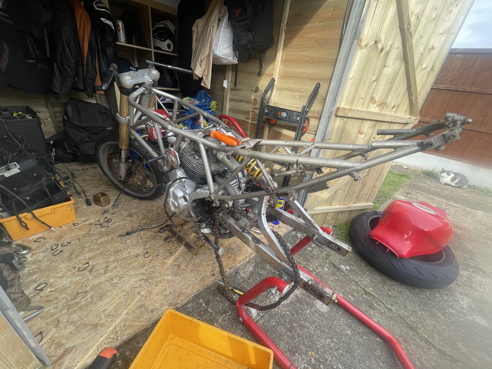

Hi folks, I'm going to jump in and probably ask a shed load of questions, most are probably already answered. First off, my old man is a classic car mechanic for 50 years, he was pushing for me to powder coat the frame of my 1995 600ss, I'm not so sure, it seems they were originally painted and powder coat might look a bit weird. For reference, I have had the bike for around ten years, used very little, low miles, and bulletproof. It is though in need of some visual TLC. The first task is sorting the frame and swingarm - and then there is the leaking clutch slave cylinder, that is for another thread. My question is: do i paint both frame and swingarm, to keep em stock, and as a '95, non-oil temp bike, which codes should i go with? The frame and swingarm will be blasted and primered and then paint bought and taken to a professional painter to sort the job. Another point, I'm after a totally standard-looking bike, I've seen some shoddy jobs where folk have rattle canned the crap out of the frame and they just look awful, far too gold and blingy, I defo don't want that! Thanks folks! Toad

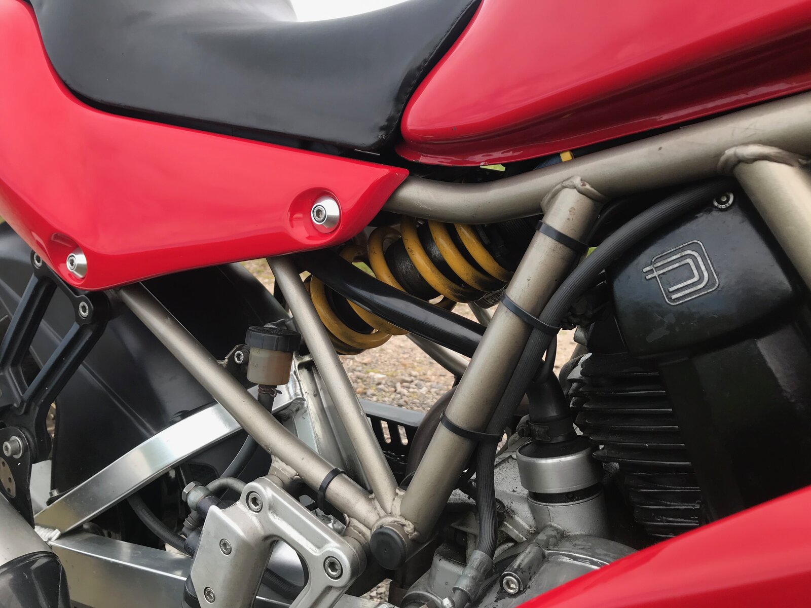

In the picture I posted above you can see my frame after I resprayed the back half using a rattle can. The paint was 2K lacquer over base coat and I asked the supplier for satin lacquer, it's a bit glossier than the original but I can live with it.
Hi Dan, I knows its an old thread, but i am just about to paint my frame 1035. do you know what is closest finish to original ? Satin or matt?? tks mark
Check the pic l posted above. If you look at the way the light reflects off the two frame tubes in front of and behind the vertical cylinder you can see the original against the respray. On my frame I would have got a better match with matt clear coat rather than satin.
Thanks Dan, Yes i can see now. It's a good colour match and i think i will go matt. Appreciate the quick reply. All the best Mark
