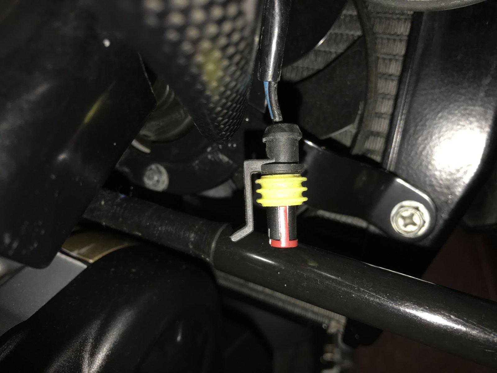

    Our Multi needed a 15k service which thankfully JHP were able to fit in before we head to the Alps on Tuesday, overalls I'm impressed with the service.
    But after unloading the bike at home I have noticed a cable hanging down which clearly isn't connected to anything but I suspect it should be.
    There is a line of dirt on the top ridge which suggests it was once plugged in and is now in a strange environment away from its home. The trouble is where should it plug in, I don't want to have to head back up to JHP if it's easy to resolve.
    Any thoughts on what this should plug into?
    Oh and they didn't reset the bloody service indicator...

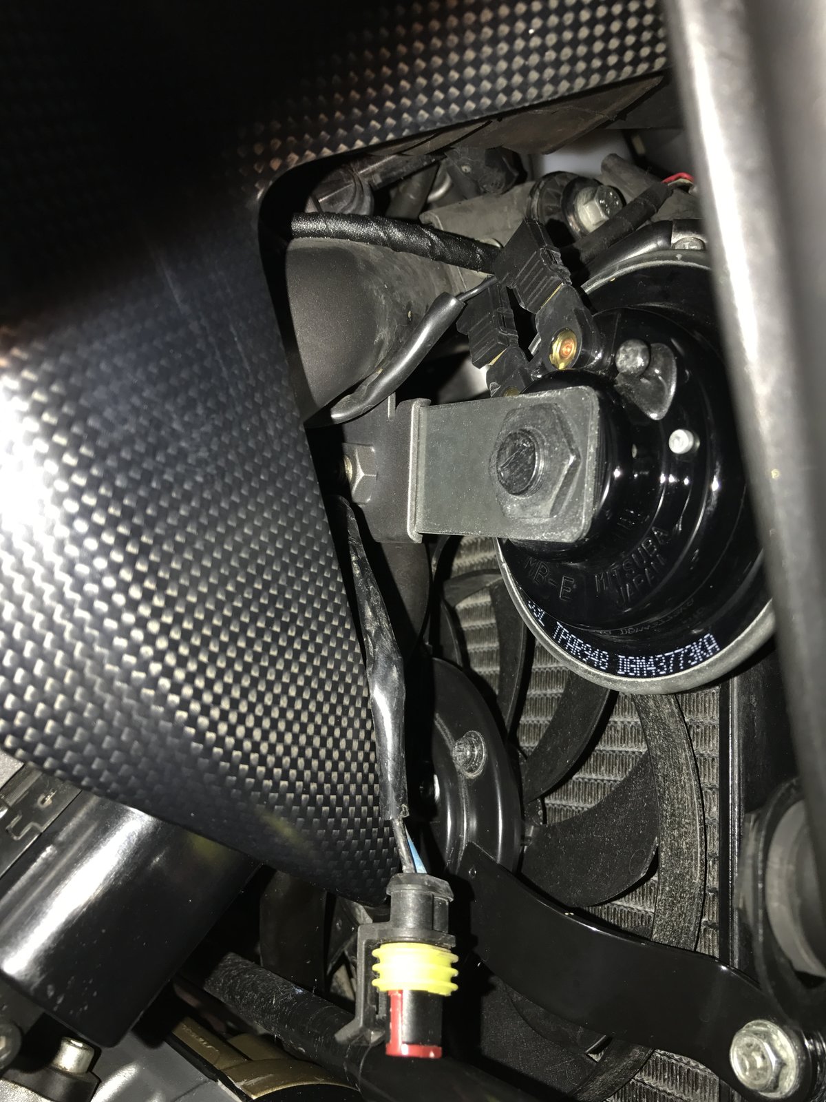

  6. I think that is your cooling fan connector
    There are two one on each side of the radiator, I would check there, it may not have been re-connected after the service
    Your radiator will have been removed for the 15k service
    You best have a good check before your trip, you don't want the bike overheating and blowing a head gasket!
  7. Agreed, it's most certainly one of the fan connectors.
  8. It was indeed, right hand fan left unplugged. All sorted now

  10. So have you reconnected yours to the fan?
  11. As I said, my bike isn't here. There is a connector like this floating around somewhere, may be under the seat or higher up
  12. As I said, my bike isn't here. There is a connector like this floating around somewhere, may be under the seat or higher up
  13. Yes I have indeed. Took some time to find the other end it was attached the the frame and hidden behind what I think is the rectifier.
    @bradders, thanks for the offer but all sorted
