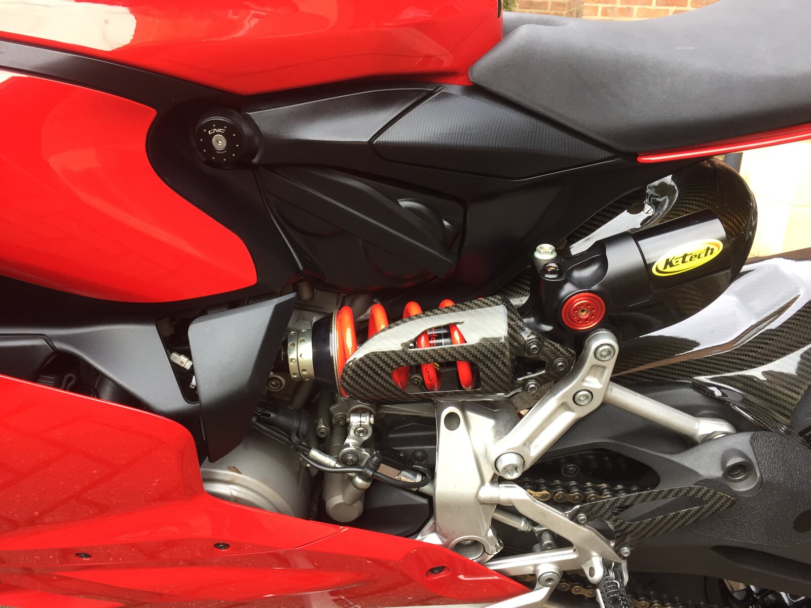

  9. I got one of these…
    Easily the best money I’ve spent on the bike, normal compression and rebound adjustment on the black and silver screws on the top and the big red disc in the centre is what K-tech calls a “ Balance valve” it’s a high speed comp / rebound adjuster.
    Basically when the bike hits a big bump at high speed, it acts like a blow off valve for when the normal adjusters can’t flow enough oil quick enough and prevents a hydraulic lock, which is what tries to kick you out of the seat, I was still feeling a bit of a thump on standard settings so I’ve backed it out a couple of clicks and it definitely takes the sting out of big bumps and potholes.
    Enjoying the bike much more since I added this :upyeah:
  10. The standard suspension isn't bad. It's no good for top (and mean top) advanced trackdays or racing, but is fine for the road and the odd trackday in my opinion as long as you set it up for each scenario. I'd personally test it out first and see how you go on it before spending any cash. Plenty of good options though if you do want to upgrade as people have shown. (Like that Ktech)
