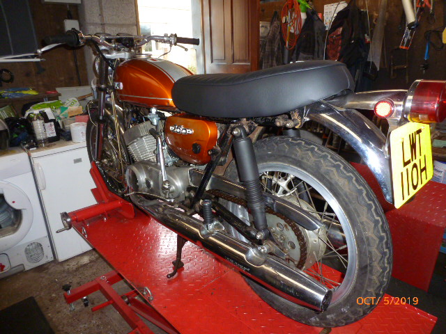

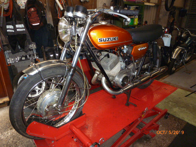

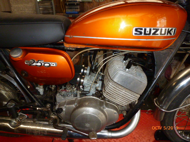

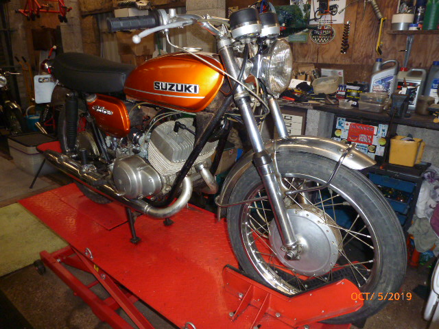

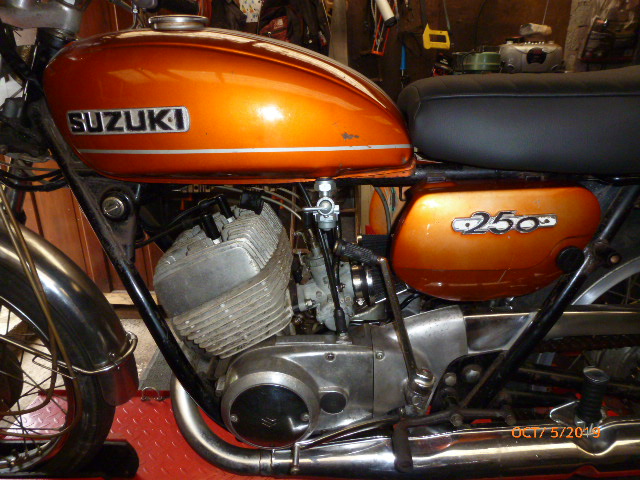

  1. Got this running well now, no road test yet. As posted a few weeks ago i acquired these recently a 1970 GT 250 as registered in the V5, the feeling is it is a Hustler drum brakes all round as the GT250 had a disc front and didn't appear in the UK until 1972-3 .
    My aim is /was just to get it running, the whole fuel system had been clogged up with stale fuel in the form of a treacle like substance. So, tank thoroughly cleaned using sugarsoap to shift about an inch of this muck from within, fuel tap assy cleaned but i decided to replace it with a new replacement which omits the vacuum assy just a lazy device for leaving the fuel tap on.
    I replaced the coils as the original plastic coatings had split and the bike would not run on two cylinders. New plugs, new clutch cable, seat recovered, horn/light switch fitted ( never had one). Replacement handlebars as it had bent ace drops on it, and new grips.
    The running problem was the carbs as advised on the forum, i had removed them and stripped and cleaned them about half a dozen times with no success, this week i was to lent an ultra sonic cleaner which done trick.
    The bike is so original i am feeling loathed to do any cosmetic restoration on it, just ride it.
    Anyway a few pics for you all.

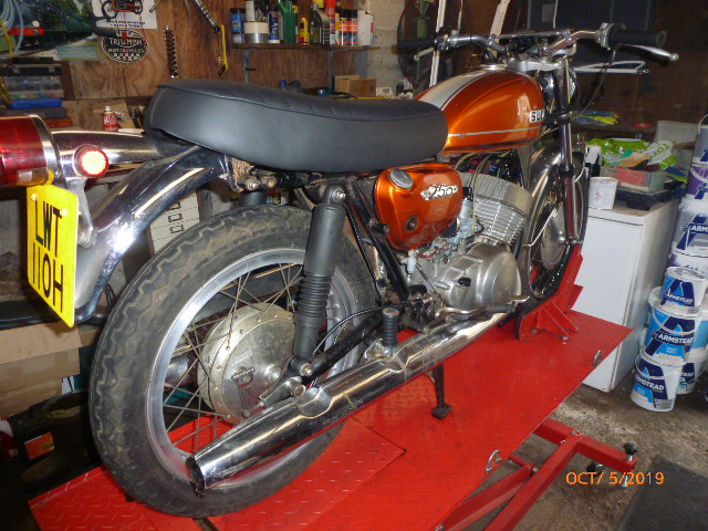

    Do you think the rear shocks have been painted black? I'm no expert but I would have thought they would have been chrome.

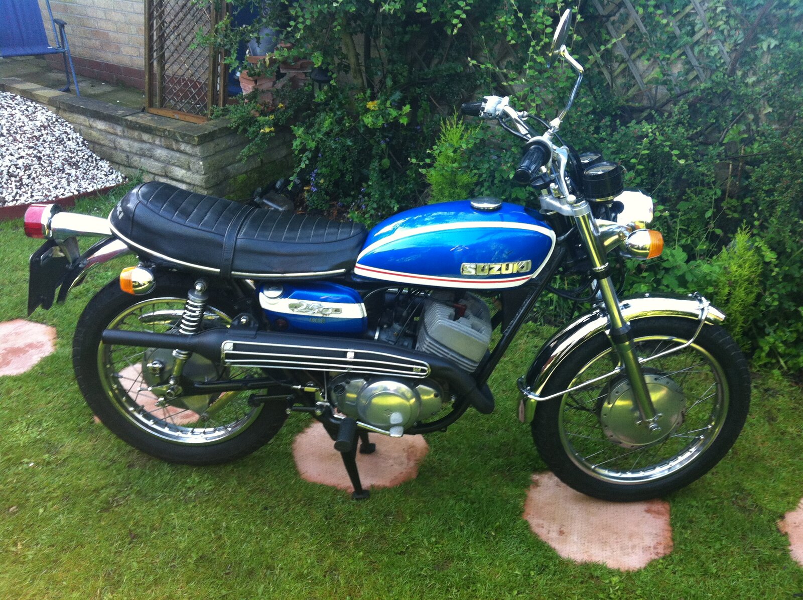

    Looking on the net the rear shocks look different to other bikes, not that it matter much and yours might work better! suzukit250-1971-1-1024x682.jpg
  3. Thanks Jez, yes rear shocks were chrome................... and rust, so had wire brush treatment on the bench grinder and a couple coats of matt black.
    Fuel tap is fine after de-gunging, and i don't do profit mate.
    Got a new tyre to pop on and test flight on the Stinger is imminent.

  4. PS Is that yours ? No the bike in the pic is from Google. Your rear shocks look different though to those shown, as the springs are covered at the top.

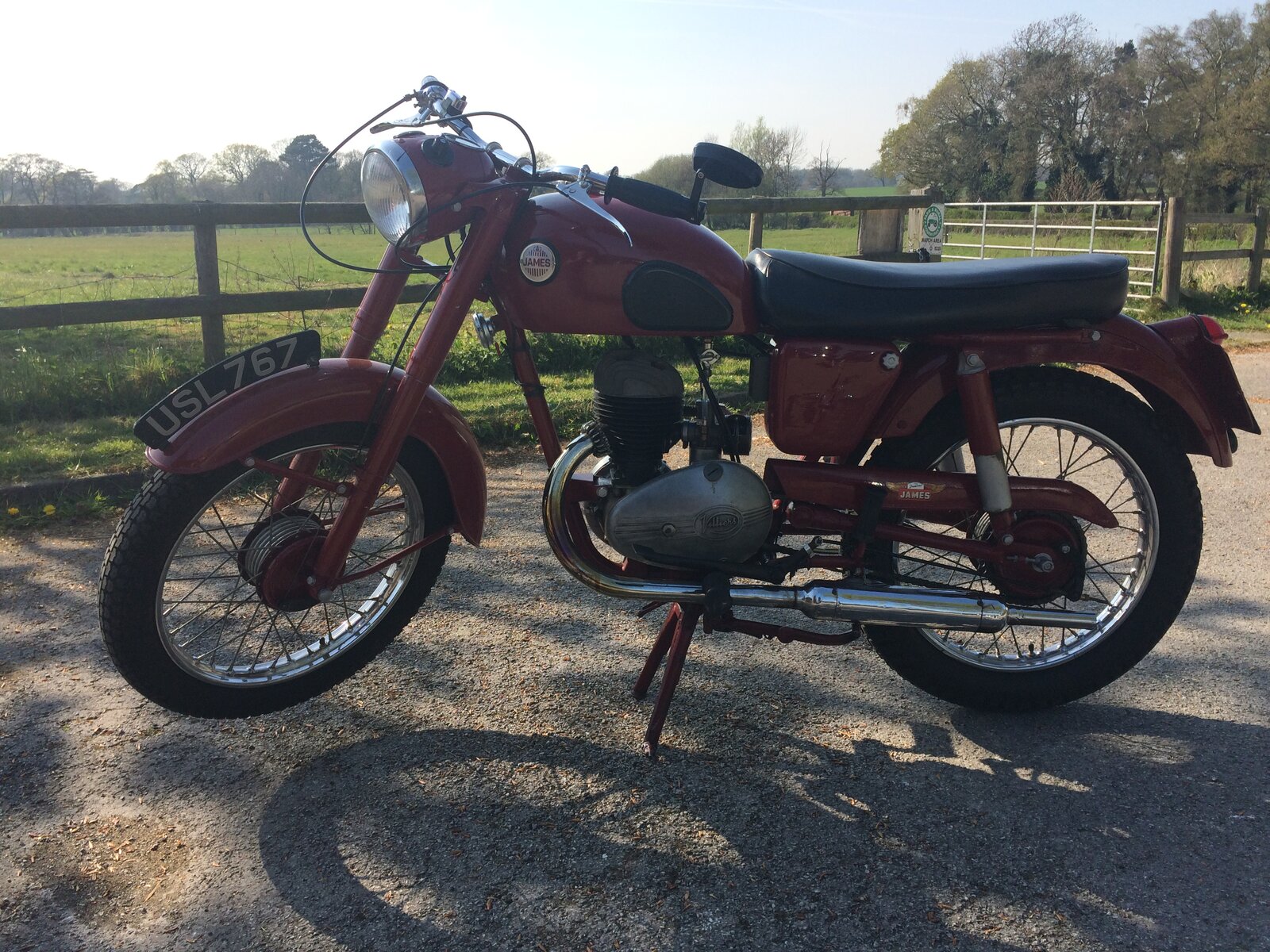

  18. 5245AF96-76AB-4FA2-99FE-46BD5517CAAE.jpeg The only 2 stroke I have now is a 1955 James Captain 197, bought it for my 84 year old father to ride around his garden and tinker with, what a pain in the ass it was until I fitted an electrex electronic ignition kit, now it starts first kick and never misses a beat, points are OK really if you stay on top of them but ancient technology by today’s standards
