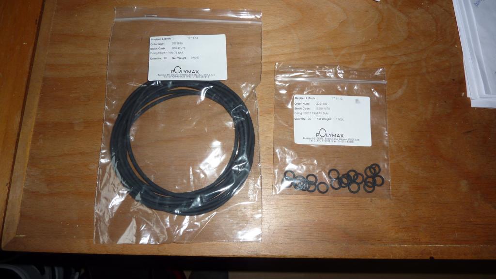

  7. This lot cost around £14.
    With a tube of recommended o ring lube.
    Steve
  8. Burger me !
    That's a proper bargain .... have you got a link you can post ?
    or are you going to leave us all in suspense ( and misery ) ?
  9. It's all on the label, they're from Polymax.
    Steve
  10. Hi Birdie, sounds good. I suppose that these are PTFE/PP suitable for automotive applications, but I'm struggling to read the codes. Would you do a close up of the label, or type the stock codes please. Cheers
  11. Yes they are Viton, I've been using them for 8 years.
    The large o ring, BS247V75
    The quick releice, BS011V75
    Hope that helps.
    Steve
