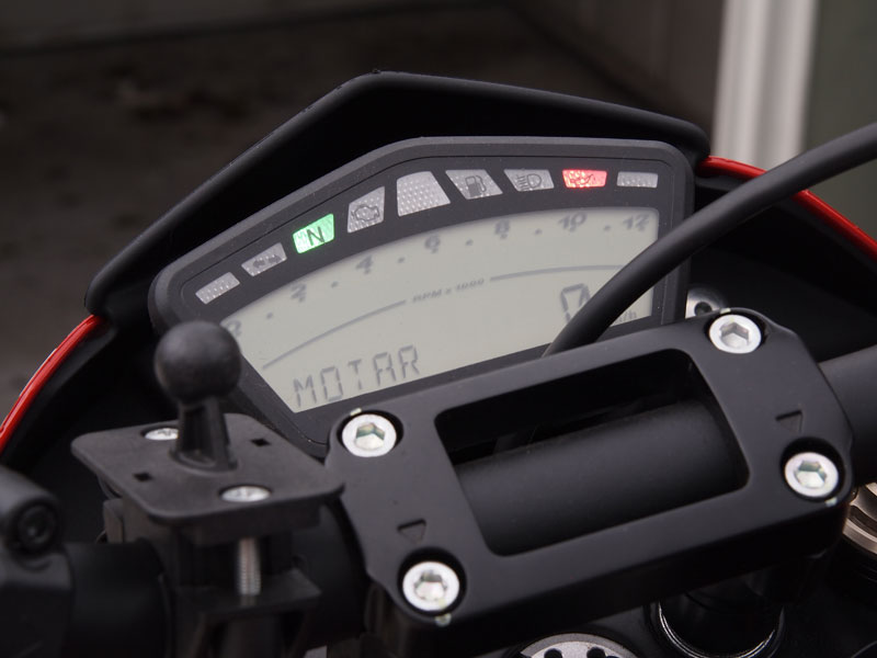

  1. So I have a hyper 1100 with an ill instrument cluster, I've tried in vein to fix, but giving up now.
    Due to price of a new one (£670 plus fitting) I'm exhausting every avenue before I resort to a main stealers...
    I've found a few second hand ones in Ebay which have the same part number i.e. (406.1.077.3B).
    I'm wondering a few things:
    Are the instrument clusters linked to the key/ECU? If so does anyone know the procedure for learning a new instrument cluster to the original ECU/key?
    Second, if a speedo in America has the same part number on the back as one in the uk, what if any differences are there?
    Anyone with experience, help greatly appreciated.
    Of course if anyone is breaking a hyper 1100 with the bit I need there-on, let me know.
    Bike is a 2011 S model with, I think.. an ECU from an SP.
  2. no I don't believe it is...there was the internal part of a cluster for 200 quid on eBay last month...dunno if it's still there though...can you confirm the model ...old clocks or new (like the streetfighter)...?
  3. Hi,
    Yeah, the bits on eBay were for the LCD only, and from what I can tell having taken my clocks apart.. It's a job to swap the LCD without doing more damage, they're glued in. Anyway, I don't know for sure if it's the PCB or the LCD, hence going to swap the whole unit.
    It's a 2011 hyper 1100, clocks look like in the picture attached.
    Cheers.
