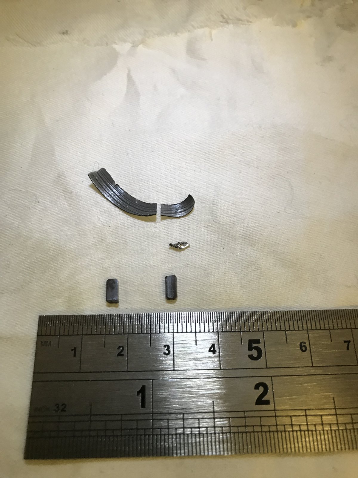

  1. I carried out an oil change on my 1299 last night...and found these in the oil filter chamber....large pieces of swarf and 2 unidentified pieces that look like either teeth broken from something (?) or lugs (?). All pieces are non magnetic.
    Was riding last weekend and thought I heard a sudden whiring strange noise, engine management lights came up..which turned out to be a failed Lambda probe.
    Any how’s now got a strange vibration around 4500 rpm and performance down.
    Thoughts? What would you do?

  4. The 2 small rectangular pieces, I’ve had exactly the same in the oil with my previous 1199. But that engine had had a hard life on track. I was told by people who know, what they are off (can’t recall now) and that it wasn’t anything to worry about.
    The large piece looks like sealant (is it all flexible?) perhaps used to seal the cases together? I’m guessing here.
    If it was me I’d call John Burrows at JHP and ask if you can mail him the picture for their opinion, just to be sure. At the the end of the day, if it’s more serious & needs sorting out, they’d be my go-to dealer.

    No, the large piece is metal, it’s been shaved from somewhere. It’s brittle.

  8. The little bits are off the water pump driven gear.
    By coincidence JHP just did me an oil change (this morning) and found parts matching the description of those little rectangular pieces.
    I'm getting it sorted so I'll let you know what was done. Once I get over the bill :(

  10. Dan, from the water pump drive gear!!

  11. I thought the water pump gear was plastic?

    The question is then...how many teeth left on the gear drive ?
  13. God,this forum is hell of a mess. What ducati 1199/1299 hasnt had these plastic tabs inside the engine?! Its old news they are from engine assembly.
    The larger metals parts i should contact a pro about. Hope its nothing serious but doesnt look good. Good luck!

  19. Am no expert but water pump gear sounds feasible - also if its down on power there may be something else adfrift. The large rubber bit looks like part of as seal . I'd definitely get it checked out before starting it again - hope its not too expensive !!
