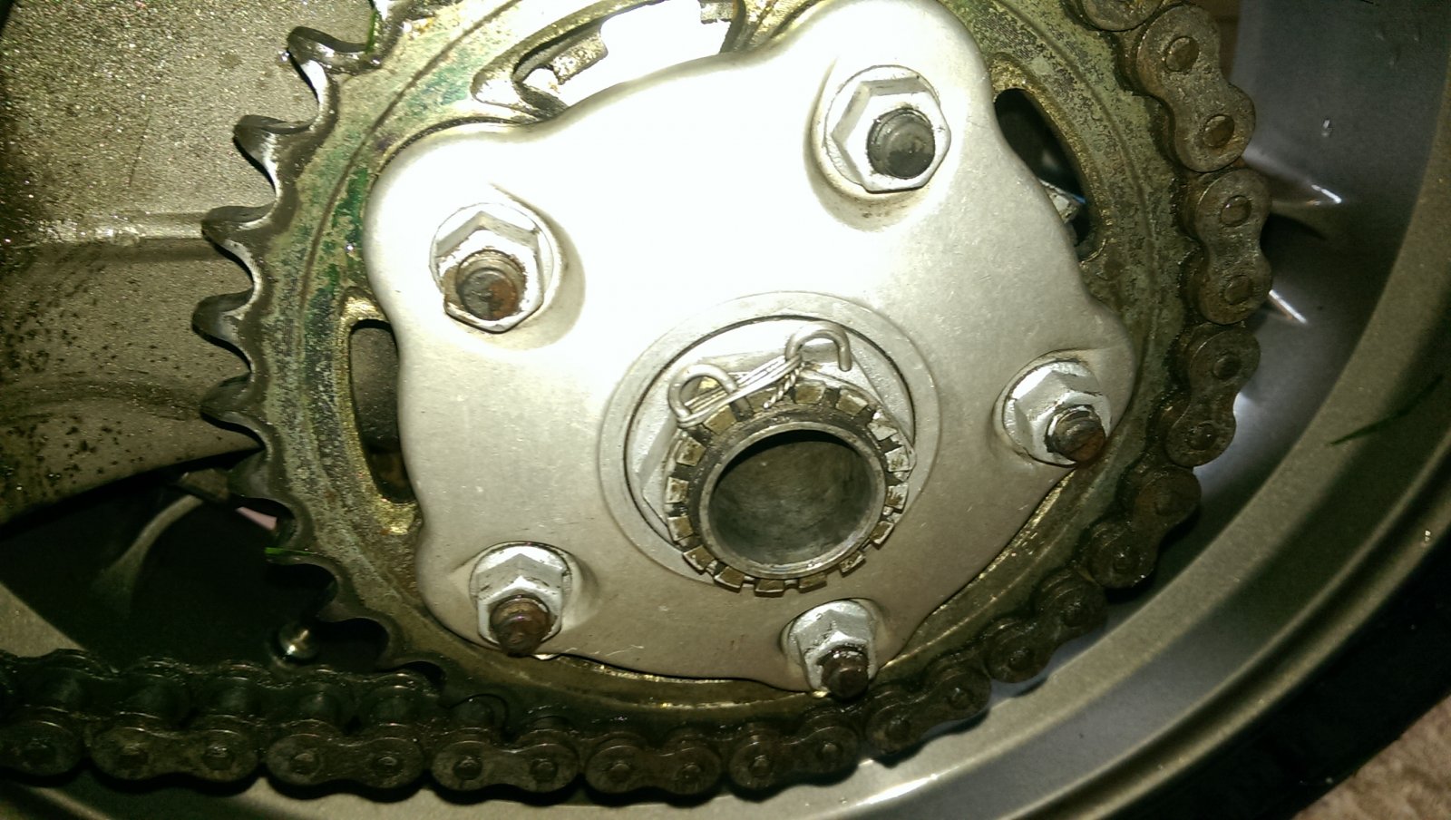

    Picked up my 2002 996 yesterday and already i'm covered in grease.

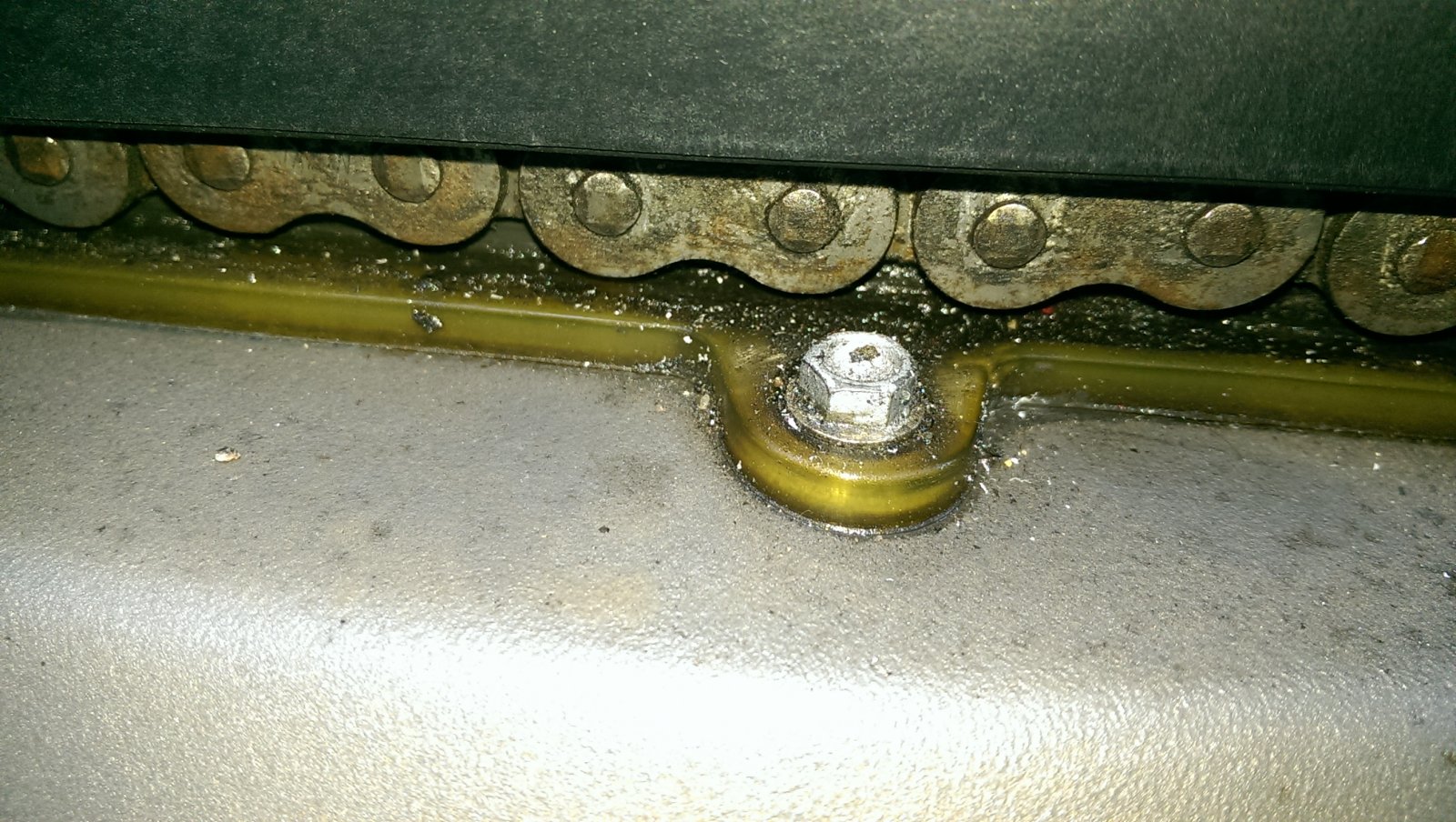

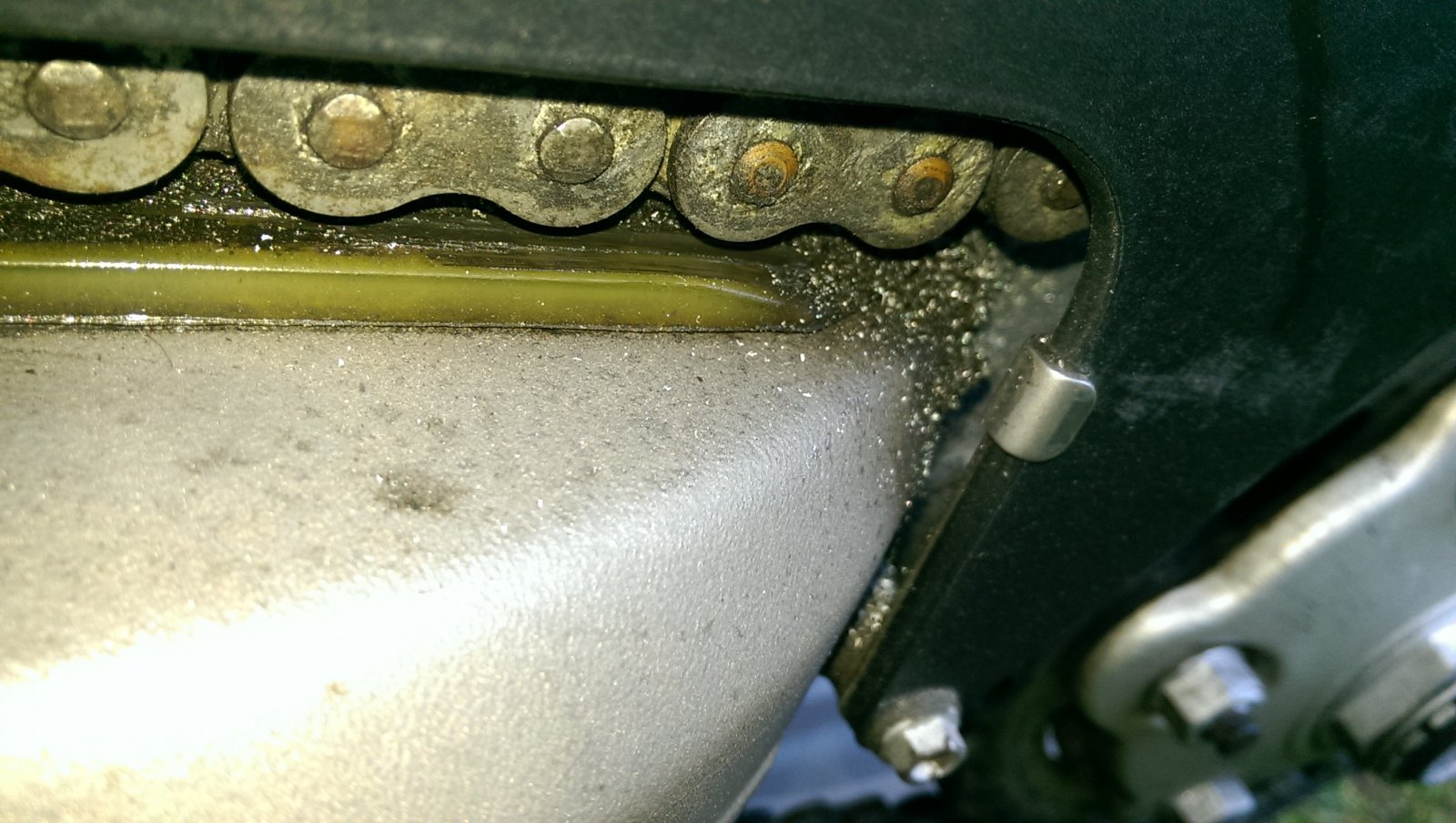

    I stopped off at a bike shop after a gentle 25 mile ride today after 100 miles of motorway yesterday and someone spotted swarf/little bits of metal all over the back wheel.
    I cleaned it up with an old cloth lying about and hoping it was the brake pads rode home very gently not using the rear brake.
    When I got home there was still some more swarf, but not as much. I have checked the pads and they have loads of life in them.
    The swarf is also over where the chain runs over the swing arm.

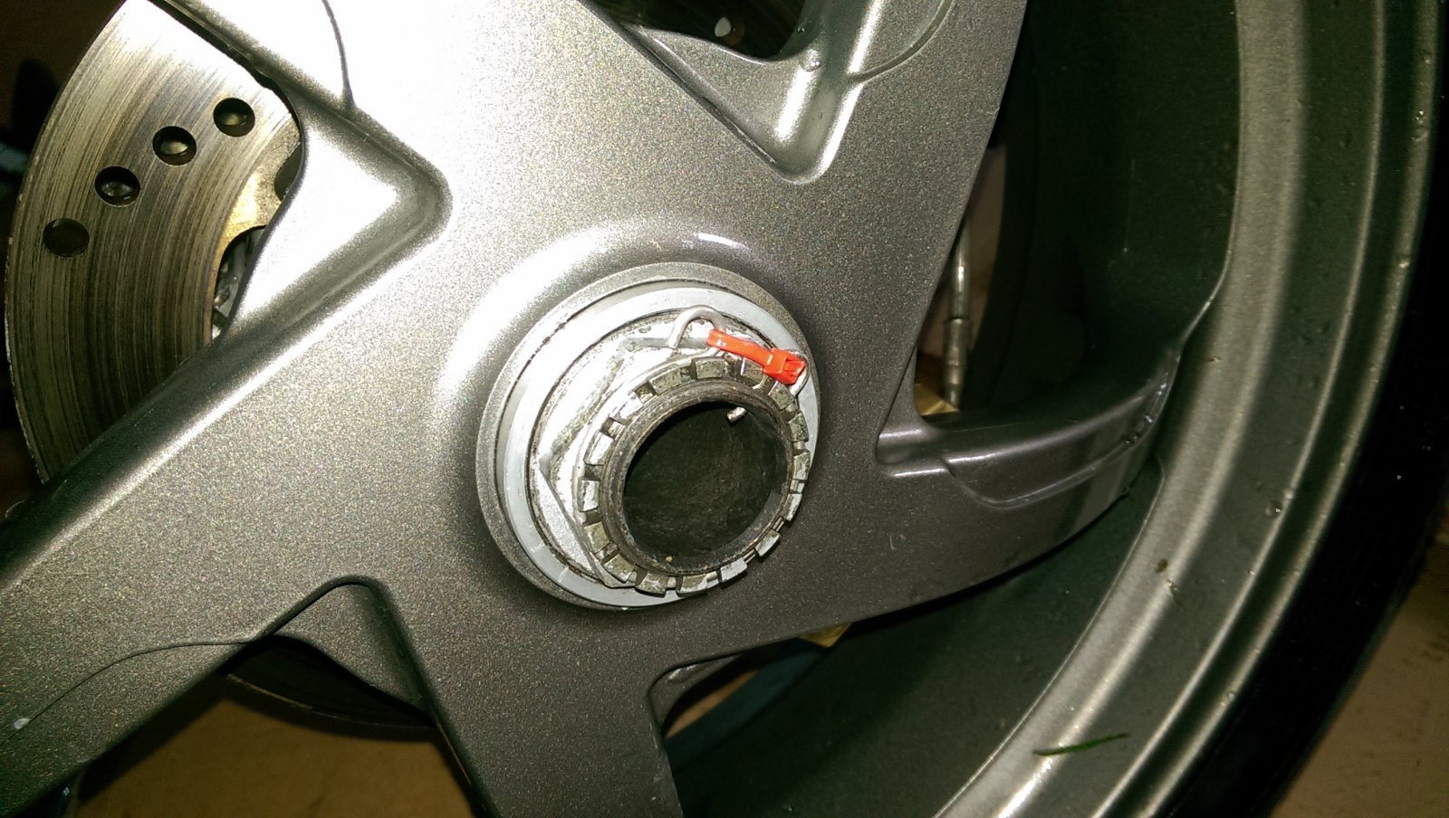

    Also, is it normal for the rear wheel to be attached like this?

  2. cush rubber things have slipped and are rubbing your eccentric hub?
  3. Check your cush rubbers. Inside sprocket carrier.
  4. Most likely the Cush drives are backing out of the sprocket carrier and gently milling themselves and the chain adjuster to oblivion.
    Take a look at the interface between the inside face of the sprocket carrier and the swing arm. The Cush drives should be flush with the back face of the carrier but they can move to the right (looking from the back of the bike) and contact the chain adjuster.
    Hope that helps.

  6. Answer to your last question is yes, the zip tie is a safety measure to hold the pin in place.

  8. It can be bad. It may mill off the "pegs" of the eccentric chain adjuster and then you will need a new one.
    Easy job to sort out the Cush drives. Recommend a Renthal quick release carrier with flanges to prevent exactly what you appear to have.

  12. Is this what a popped cush drive looks like?
  13. Yessiree!

  17. The wheel doesn't have to come off, it can all be done from the chain side, if left it will wear the concentric adjuster, it should be repaired before any more damage is done.
