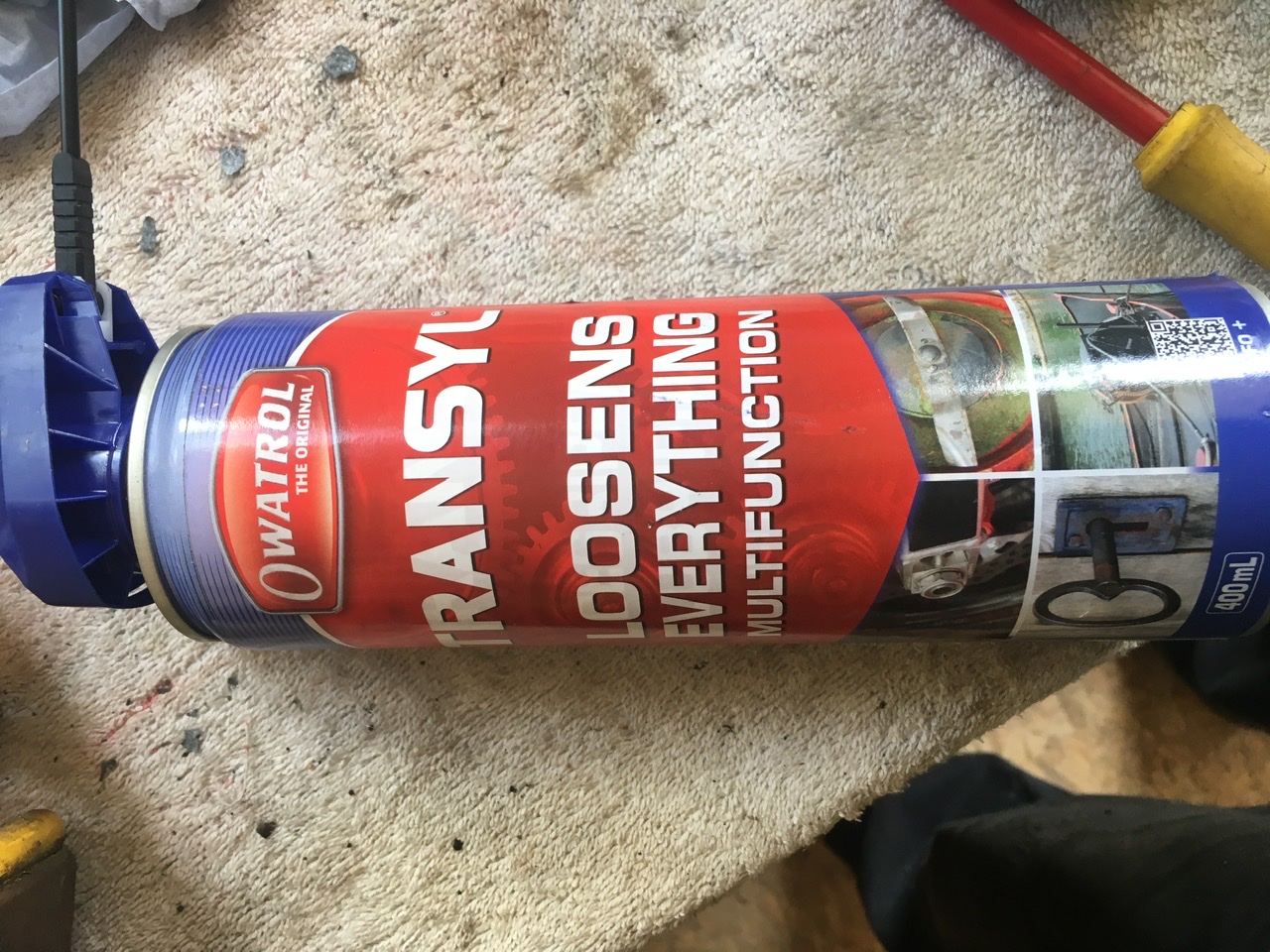

  13. Liam you need this
    or another product called Plusgas. Spray them into the gaps between the swingarm, frame, & engine casing. Do it twice daily for at least a week. After that Remove the bolt on the left (iirc) and buy a much longer bolt with the same thread. Screw it in as far as possible but leaving a few cm protruding. You can now tap this with a hammer, gently at first. As soon as it starts to move then go to the right hand side and tap it back towards the left. Then tap it back & forth, left to right a few more times, going just a little further each time. With patience it will get to the stage where you can then apply the drift and tap it all the way through.
    At least that’s what I did:)
