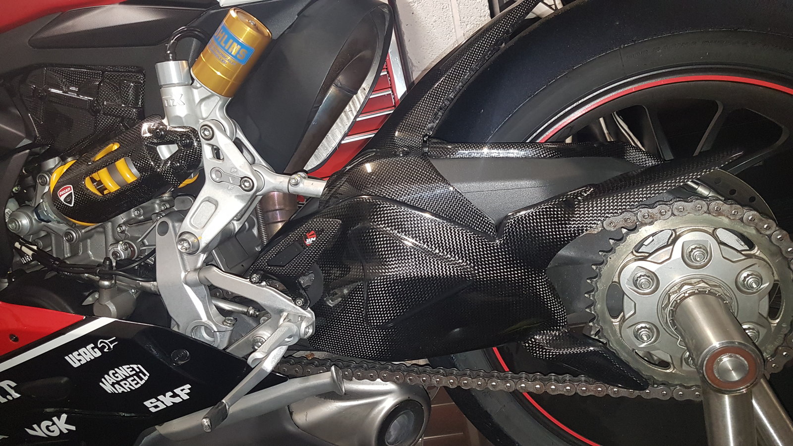

  2. Carbon Fibre cover ;-) will help if it goes down again also...
  3. carbon fiber cover is a good idea - I think my scratches will be in areas that the cover doesn't cover though

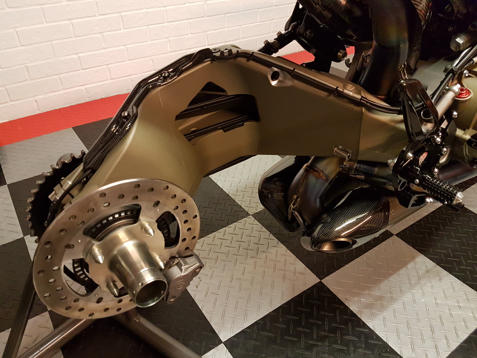

  7. Couple of hours work to remove it if it's your first time, else half an hour max. It's a painted coating on top of the bare casting. You can either get it colour matched and paint it, though paint alone won't stand up to rocks or debris thrown up by the back wheel, powder coat it, which is marginally better but dulls and scratches over time or get it Cerakoted, which costs more but will last a lot longer without the finish degrading. Here is a picture of the swing arm I had done for the 1299 in magnesium, a while back.

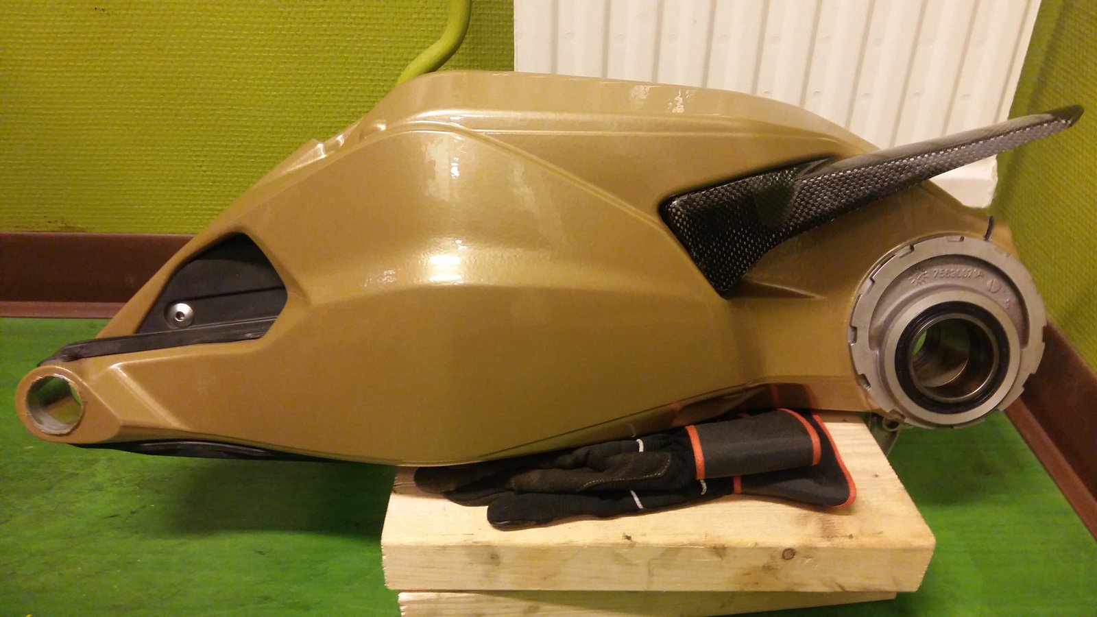

  10. So did the 1299s have an option of a magnesium swing arm in 2016??.Cheers.
