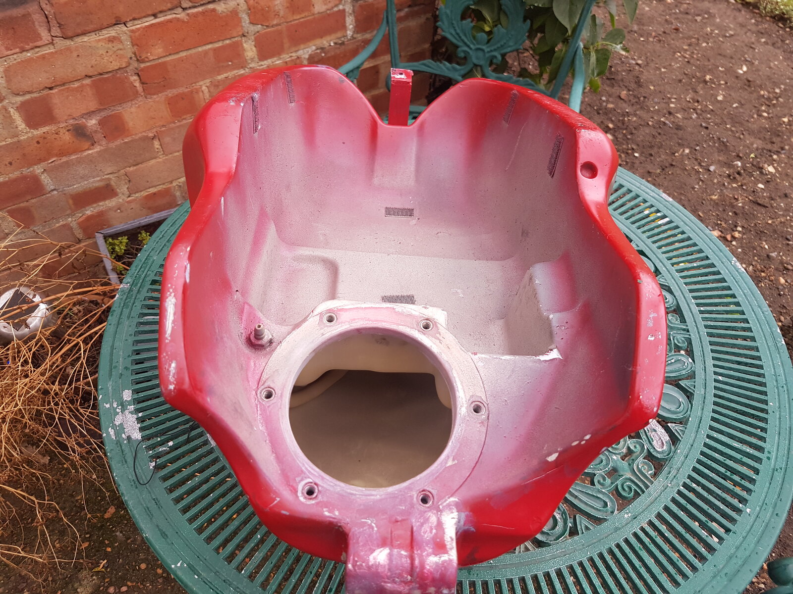

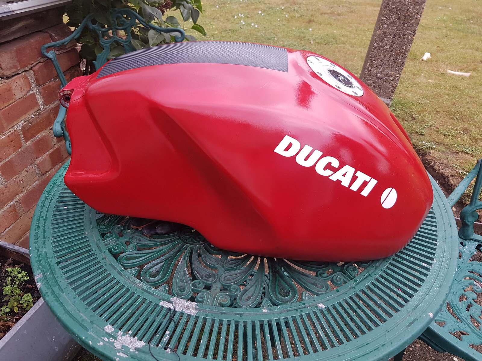

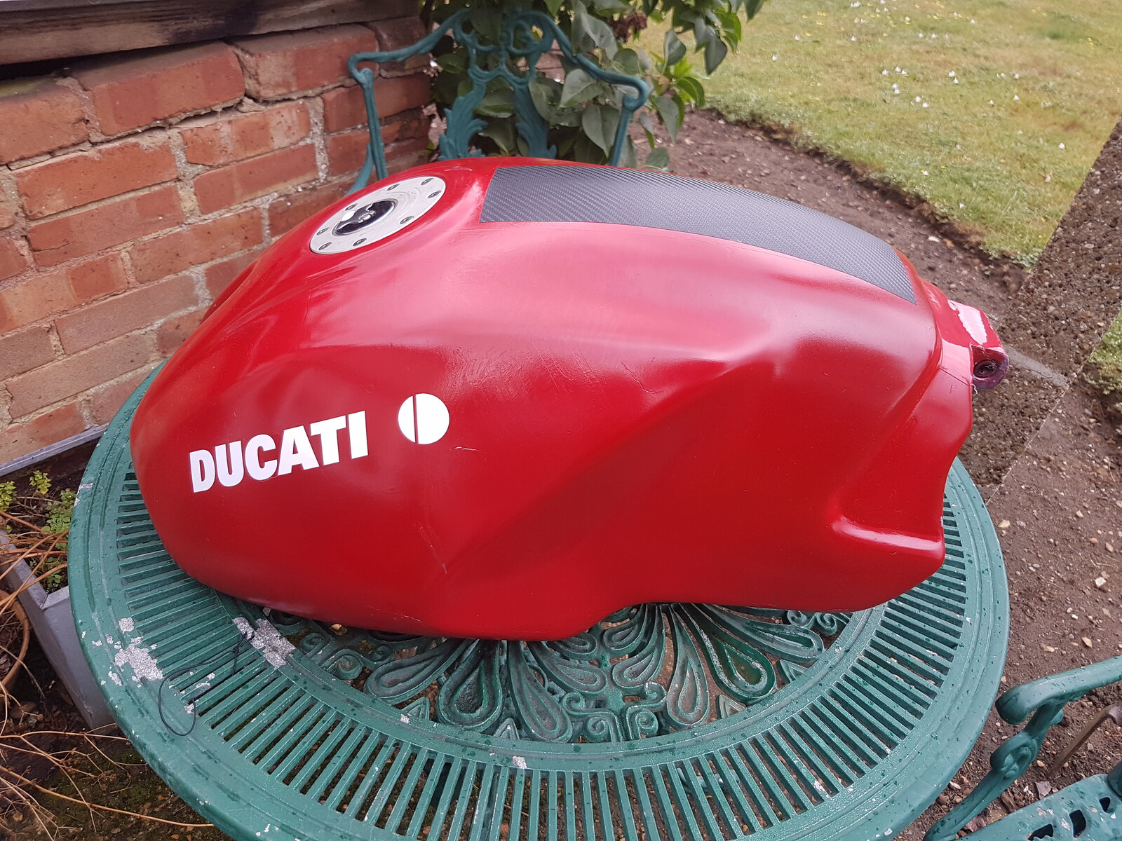

  4. @Shawn1one I have a spare that I believe is not swollen. Happy to let it go for £100 and if it turns out that it wont fit you can return it and have your money back.

  5. Hi

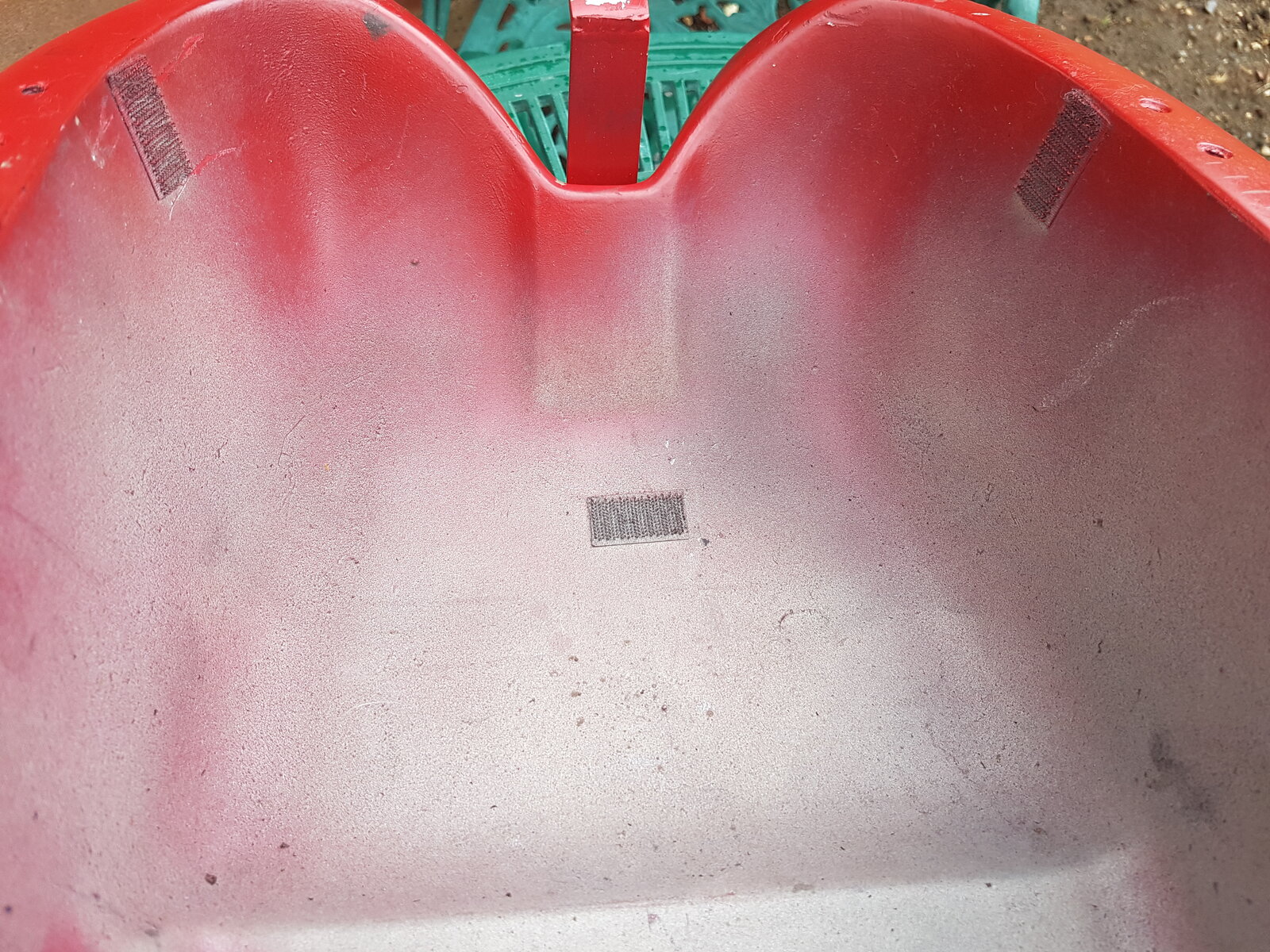

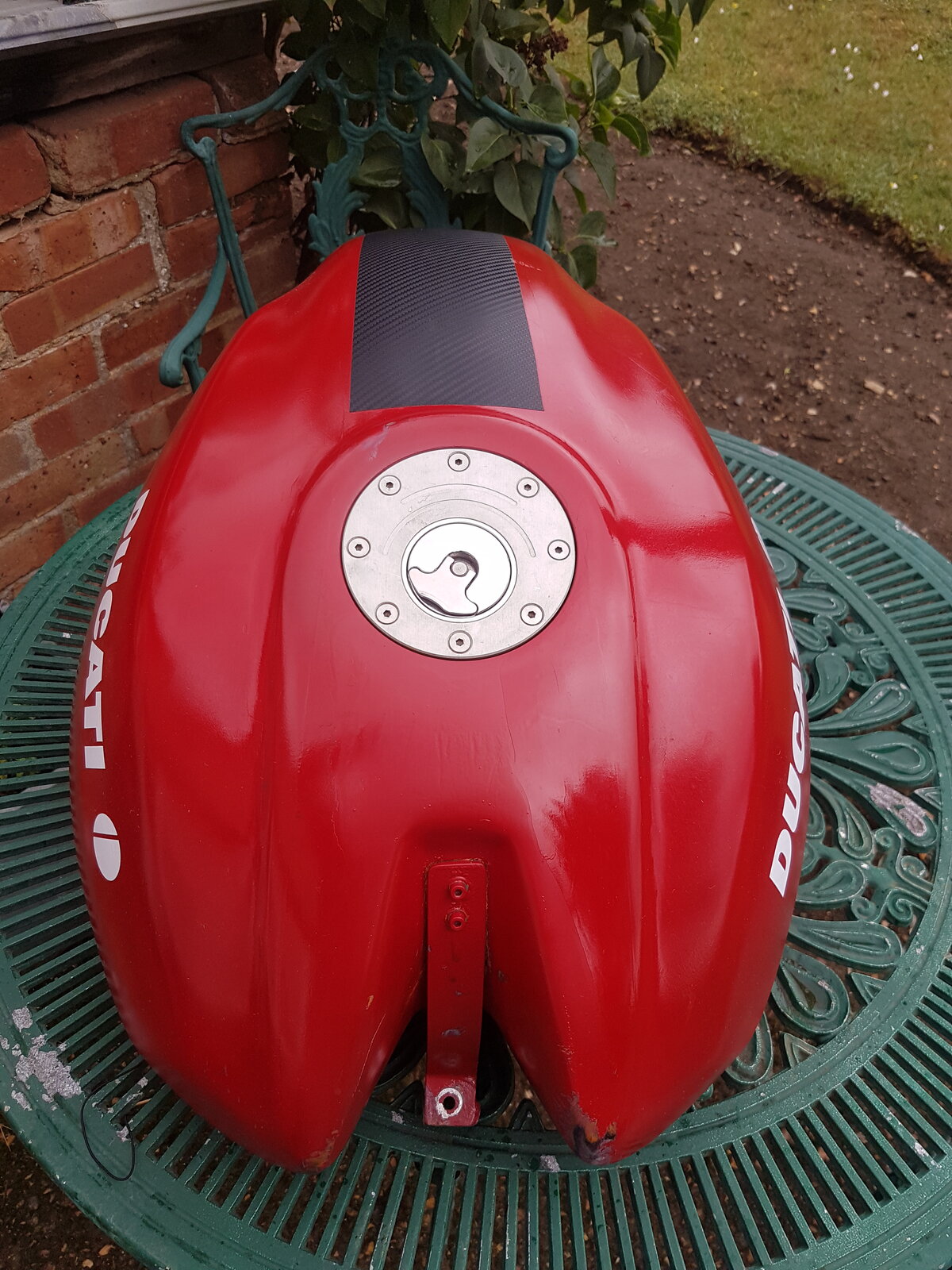

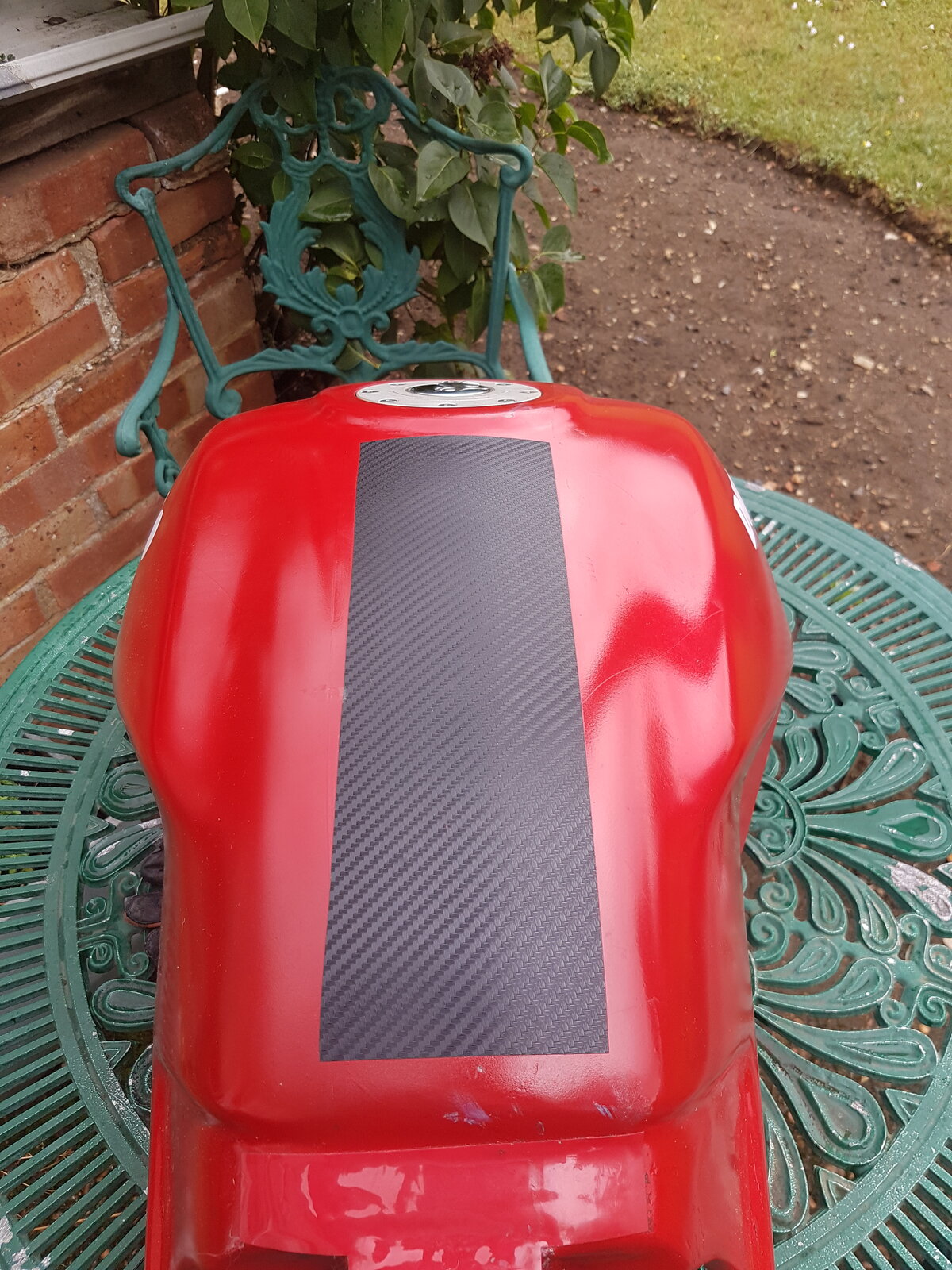

  10. Its just the tank, hopefully you have all the other bits required on your bike. Would you like me to dig it out and send you some pictures of it before you decide if its worth trying ?

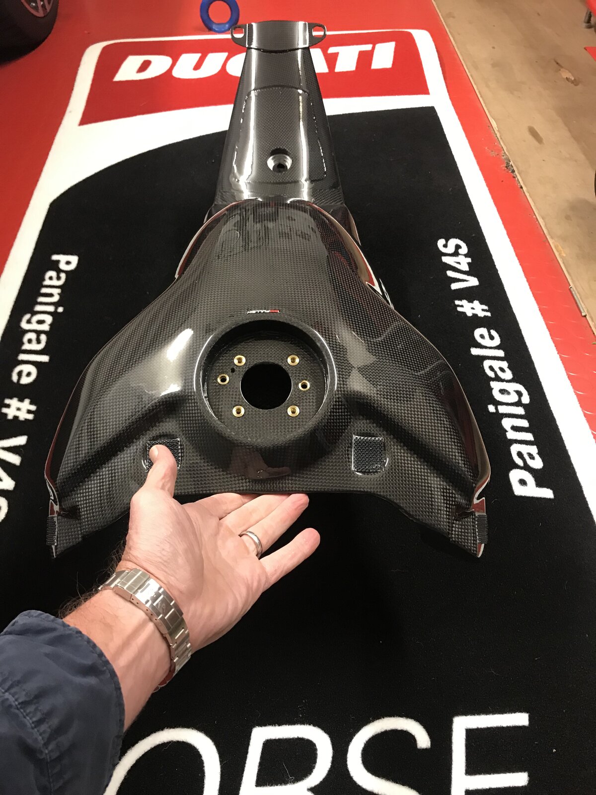

  11. Or you could go carbon fibre?? Check out FullSix or QB.
  12. Sounds like a plan
  13. Is there a risk of the ethanol degrading the resin?
    Genuine question btw, as I have a carbon BTS 916 tank fitted on my special and it is a bit of a concern to me.
  14. Hmm, not entirely sure tbh.
    I've had some recent drama with CF petrol tanks but more with the glue rails and the fittings interface. I asked the manufactures the same question as you as it had also crossed my mind. I was assured that modern methods and build techniques mitigate tank failure. So far so good with my V4S. Time will tell :thinkingface:

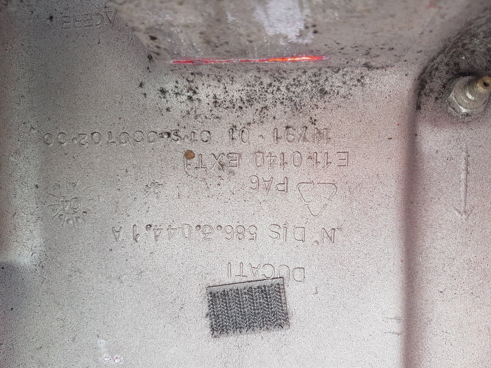

  16. There you go. Plenty of the underneath as I hope that will help determine if it is likely to fit before sending the tank.
    I'll be removing the cap and surround as I need them to go on another tank.
    I also have a spare steel tank but I think that is most unlikely to fit your bike . If the one above is no good I can send pics of that too if you think it is worth a try.
