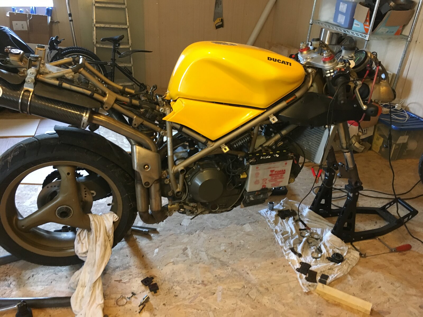

  1. EE8303C3-4068-48F4-89D2-A6F63A3E1D66.jpeg The bike’s in pieces and in the process of being stripped down further for a complete nut & bolt rebuild.
    She last ran about 2 weeks ago but is always on a trickle charger. I just went to warm her up so I could empty the oil before taking the crankcase covers off but no luck. :( As soon as the engine run button is engaged, there’s a lot of clicking from the area behind the tank and lights blinking but no fuel pump priming and no start.
    Disengaging the engine run button and trying any of the lights or horn just elicits a click and a feeble attempt at working.
    It’s as though the battery is almost dead and there’s not enough power to trigger the respective relays. However, when connected to the trickle charger there’s 14.5v there and when disconnected from the trickle charger there’s 11.7v from the battery; tested both across the terminals and from the +ve to an earth on the frame.
    I can’t upload the short vid which demonstrates what’s happening as it’s too large a file.
    Can anyone point me in the right direction please?
    TIA.
