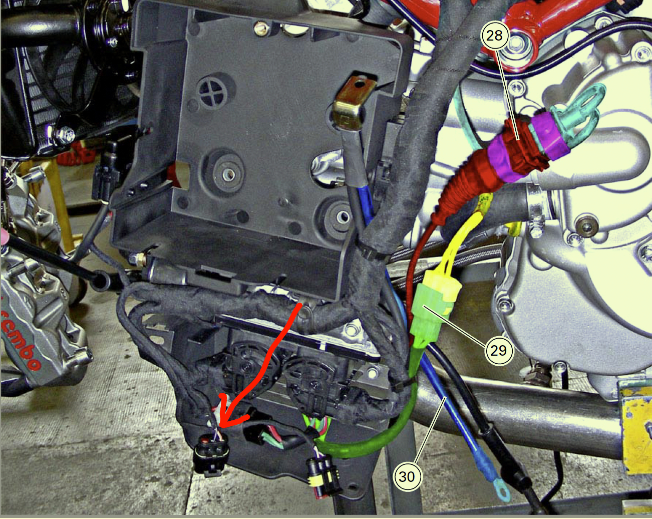

  12. Hi all. I have this currently on my 1098, I had to replace the starter so everything was disconnected on lhs electrical wise.
    I have plugged in a blue scan II diagnostic tool but error still showing. Now I have a 4 pin plug, what wires if starting number 1 from left, what wire should I earth?
  13. I think you are confusing the Diagnostic socket with the Data Acquisition socket which is a 4-pin. The diagnostic socket is a 3 pin with a orange/white wire and a black/violet wire in the middle position.
  14.
  15. Hi Derek
    I am indeed confusing it
    Can you advise the location of the diagnostic socket please. Is it under the battery lhs. And any idea how i may have managed to cause this fault as I don't believe I touched it or uncovered that socket
  16. Strangely the workshop manual doesn't show it But it's down in the vicinity of the ECU, Screenshot 2023-05-18 at 11.04.09.jpg arrowed in this pic.
  17. Yup thats it. It will have a blanking plug in it.
