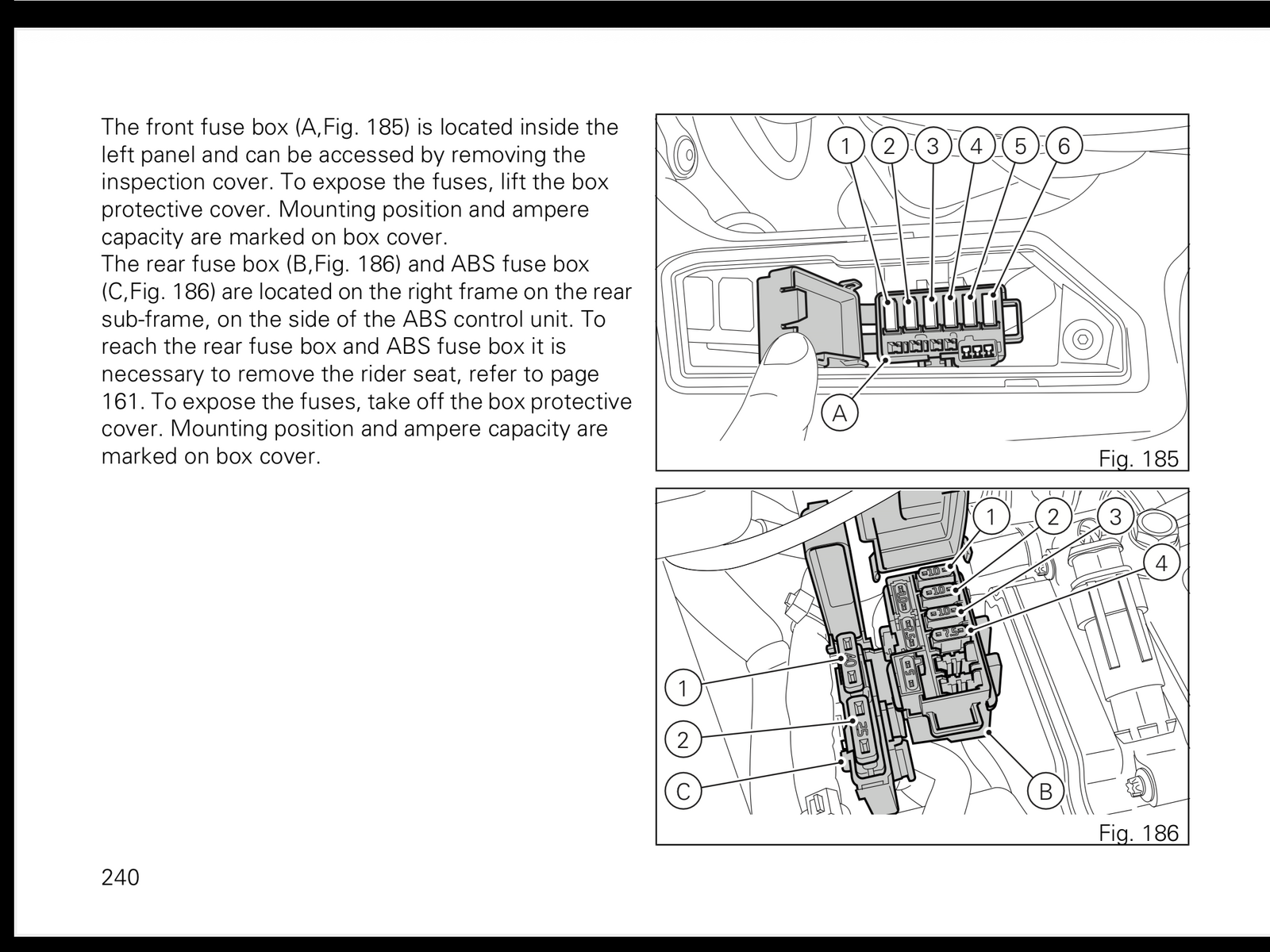

    I asked this in another thread but haven't had a response so I thought I'd post a new one. I have fitted a tail tidy but had a bit of trouble as the title suggests. I have had to fit new rear indicators and a bracket to drop them down slightly to fit with the back rack fitted. They have now all stopped working and I suspect a blown fuse but can't find the fuse location. Any help much appreciated.
  2. See if this helps
