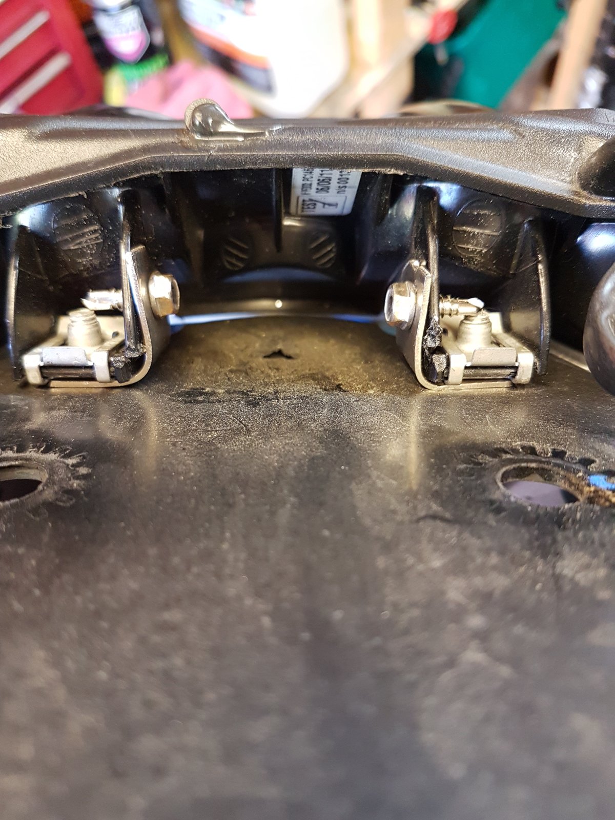

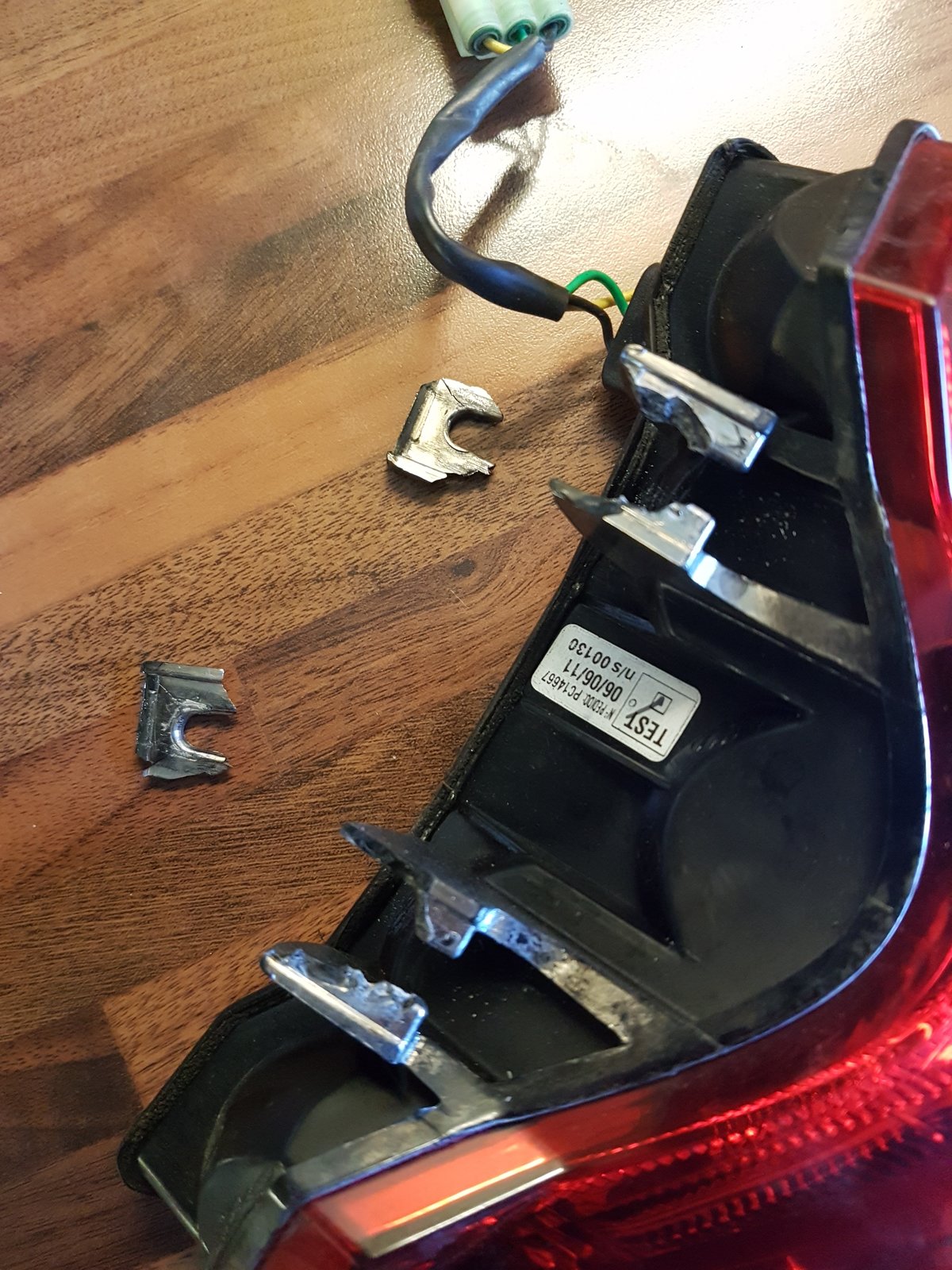

  1. Had 5mins today to check why the rear light wobbles, turns out they mounting has broken, tried a Diy repair but not too confident, what a piss poor design, and no used ones about wonder if they all snap.
  2. Yep, they all snap. Repairs don’t tend to hold too well either.
  3. Tried to melt the plastic to form a joint, that broke soon as so the next option seems a bodge job but should work till i get a replacement. 20181022_112127.jpg 20181022_123903.jpg
  4. I just left mine bouncing around :)
  5. Nope ain't broke any mounting brackets, but I am on my 4th yes 4th new rear light because the LED bar becomes unstuck from the internal lens and rattles around like a good un. £152 is what they cost new.
