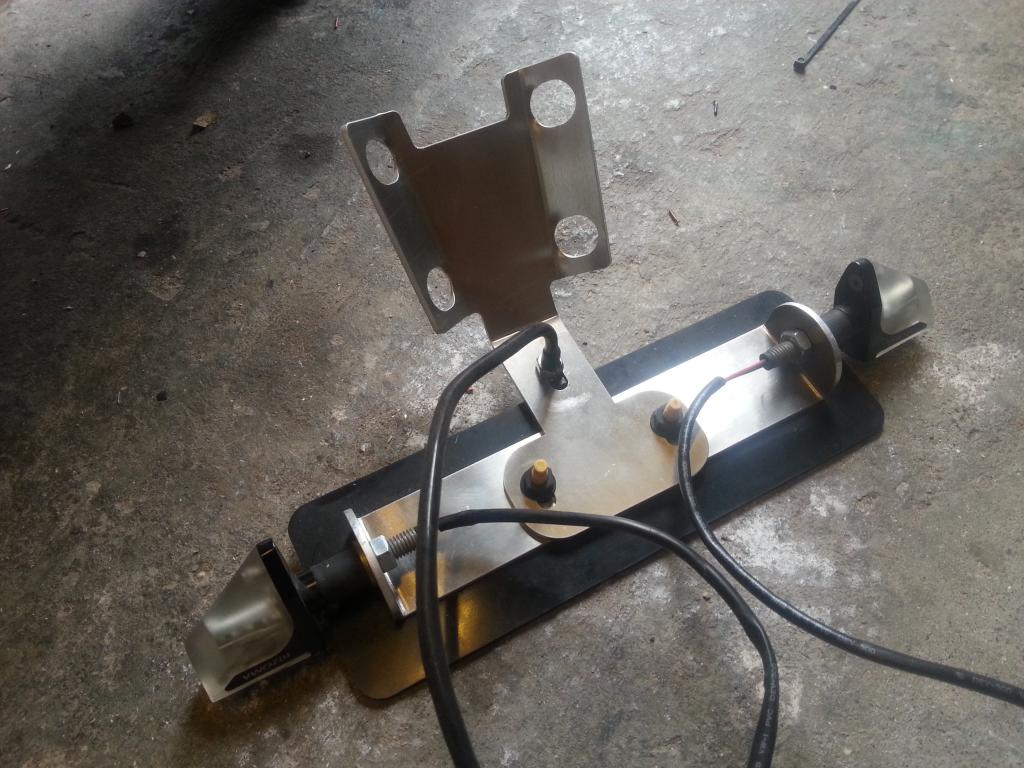

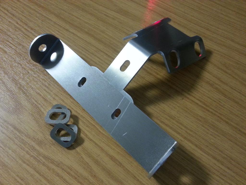

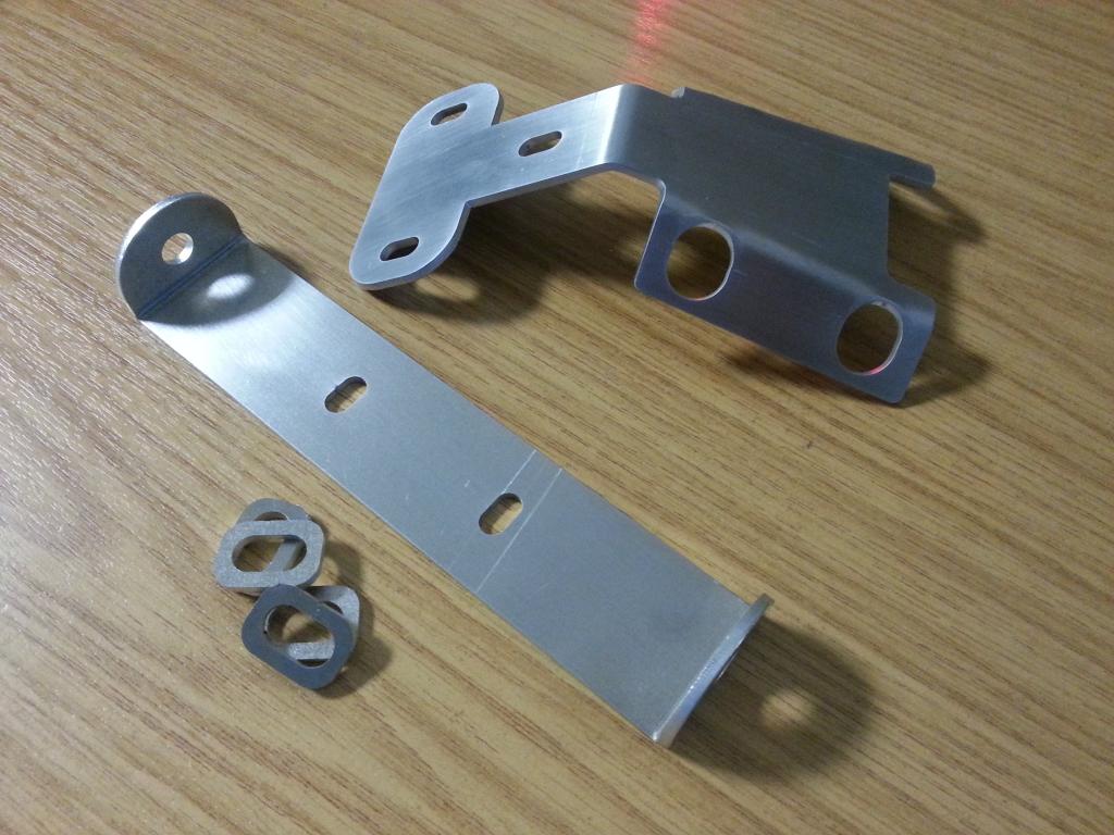

  1. Ok - just picked them up from the fabricator. This is the final revision. Ive switched to the indicator bar being separate so if youre running an integrated light or some other form of indication the bar can be detached. The holes are now slotted and the mounting holes are slightly larger than the holes on the pipes themselves as it would seem that no 2 pipes are the same so using the square washers you can move the mount to get it level. I let the fabricator have my old standard pipe and when I came to attach it to my termi it was different which kinda proved the point. Slotted holes means that you can adjust the plate so its level with the bottom of the pipes as they all seem to be a little skewed. Ive got 10 made up (it came in the price that I had to pay for the fabricators dev time)
    40 quid carriage paid anywhere in the UK. PM me if you want one. If no one wants them then it was a very expensive tail tidy for me! but I thought id take a gamble - its taken a bit of time but I think its way better than anything out there. Oh - they will come with a LED to light the plate (they just haven't turned up yet). Look forward to hearing what you all think.

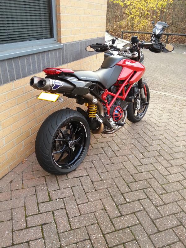

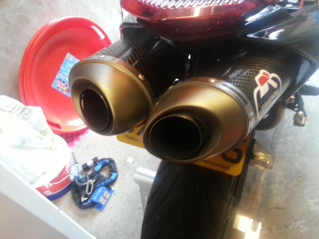

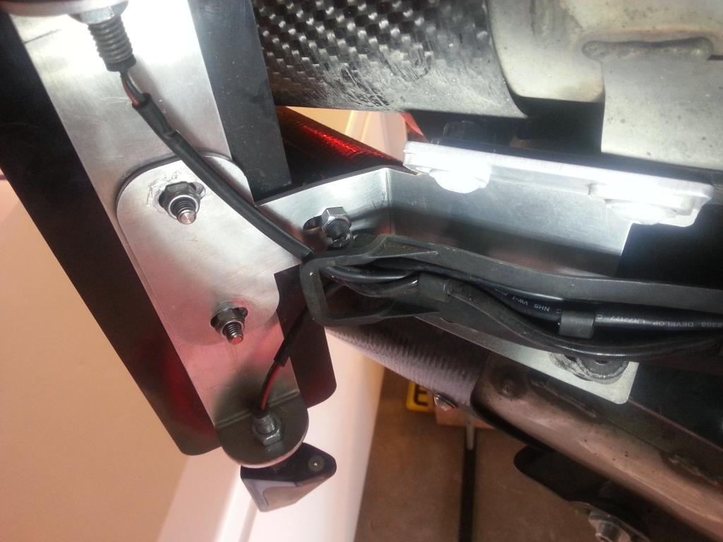

  6. Switched out the original one for the new one. Thought id throw up these. Fits beautifully. 20131124_130425.jpg 20131124_132207.jpg 20131124_132226.jpg
