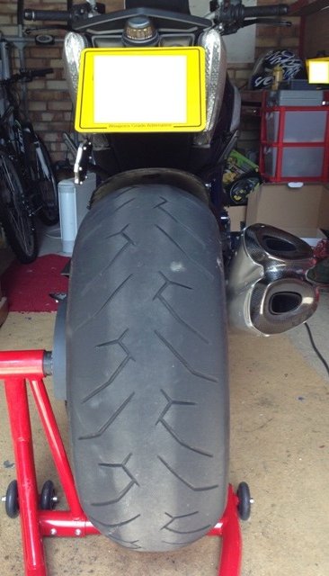

  1. Anybody fitted a tail tidy and could they put some pics up please, cheers.

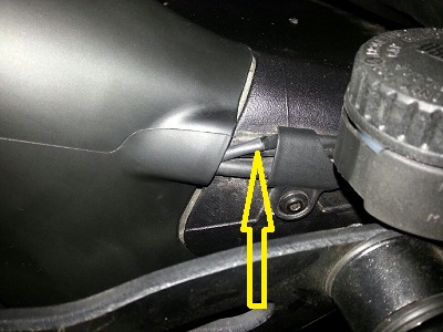

    Pics of the install although not the best ones it shows some of the points. Fitting took about 2 hours, most of that was trying to find the number plate cable route. In the end we decided to cut the OEM number plate cable and Evotech give you a nice heat shrink shroud. We cut it by the swing arm so that it can be re-soldered on no problems.

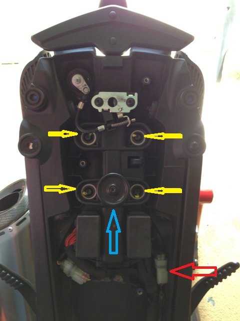

    Once the 7 screws are removed as per the fitting instructions this is what you see.
    The yellow arrows show the holding plate for the grab handle extender. Don't over tighten them or the extending arm doesn't slide in and out properly
    The red arrow shows the plug where the power for the number plate light sits. Yellow and Black, we stripped off the sheath and soldered the Evotech wires into the loom then used heat shrink to cover and electricians tape to be safe.
    Blue arrow just shows the grab handle release button.

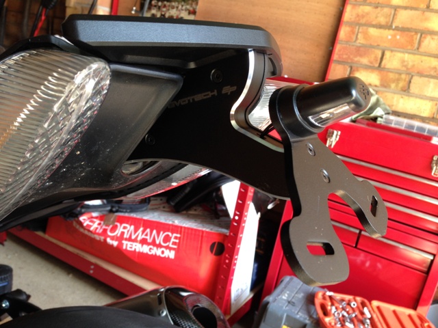

    One pic shows the Evotech tidy made up without the grab handle part.
    Overall the quality of the Evotech part is excellent and all the bits are in the bag when it turns up.

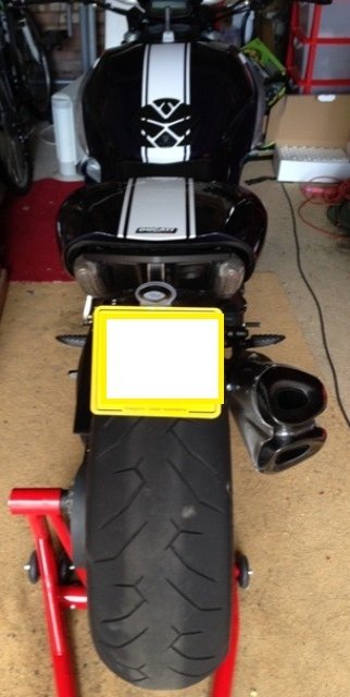

    The bike is Jamie's (Maverick61) and he opted for the extendable tidy, hope the pics help.
  7. Thank you jimvee that's what I want what size plate is that? I bet you have to watch it doesn't block the lights.
  8. I think its a 7x5 and the camera angle is odd but you can see the lights no problem
  9. Thanks ,do you have any pics were you cut the wire please, cheers
  10. Hi Pav,
    have asked Jamie to take a pic this evening but this is where we cut the cable.
  11. Pav,
    Here you go, pic from the bike with the heat shrink sheath on.
