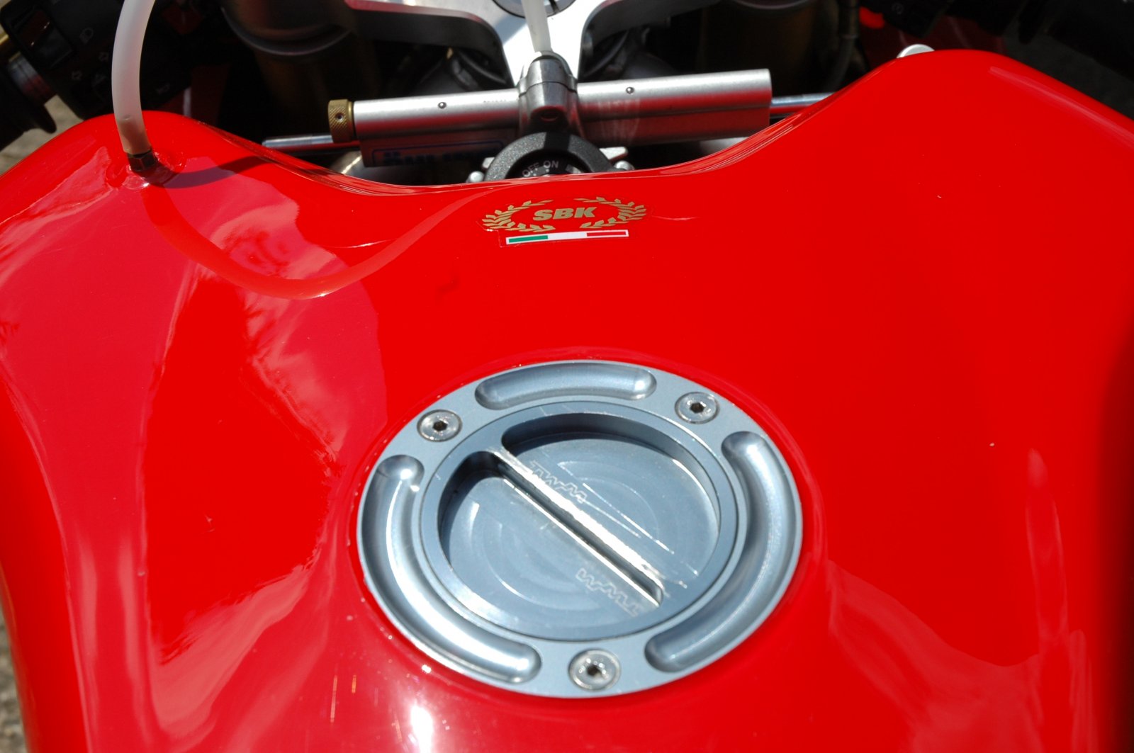

  1. I fitted a 23 litre carbon fibre fuel tank on my 999s at the beginning of the year,it has a breather aperture at the front left at the top ,see pic, anyway I went out for a ride today and filled the tank to the brim for the first time since having it on and as soon as I put the bike on the sidestand to go and pay I noticed petrol pissing out of the breather stub,as soon as I had paid and got the bike upright and sat on it it levelled out and stopped...is this supposed to do this or is it just a shit design?...don't really want to ruin the expensive paint job I had done just yet!....any ideas/solutions/advise welcome:confused: DSC_0383.JPG
  2. Have a high loop in breather and it should be fine. If you leant it over quick the surge of fuel might've started syphonic action.
  3. What brand is that tank?
  4. Thanks,i think the tube isn't as tight a fit as it could be either,just ordered some proper vent tube and been looking at an inline one way breather valve,are they any good?
    I was told it is a Kamna tank,bought it whilst on a trip to Germany,it came with a nice TWM billet filler cap too.
    #4 yellowducmaniac, Jun 5, 2015
  5. 1 way valve will do job. Ptfe tape wrapped around tank spigot to seal pipe for now.
  6. Might seem a stupid question ,but here goes...I bought one of these one-way breather valves and fitted it half way along a routed breather pipe on the inside of my cockpit,there is a small arrow on the valve which I assume should be pointing away from the tank?...anyway just filled the bike today and theres fuel pissing out of the end of the breather which is a good 18 inches away from the tank outlet.
    Have I fitted it the wrong way round?
  7. Think you have answered your own question. You want to let air in but not fuel out. Tank <--------
  8. ooops!.....what a plonker ,i'll change it round, not sure why I thought otherwise!
