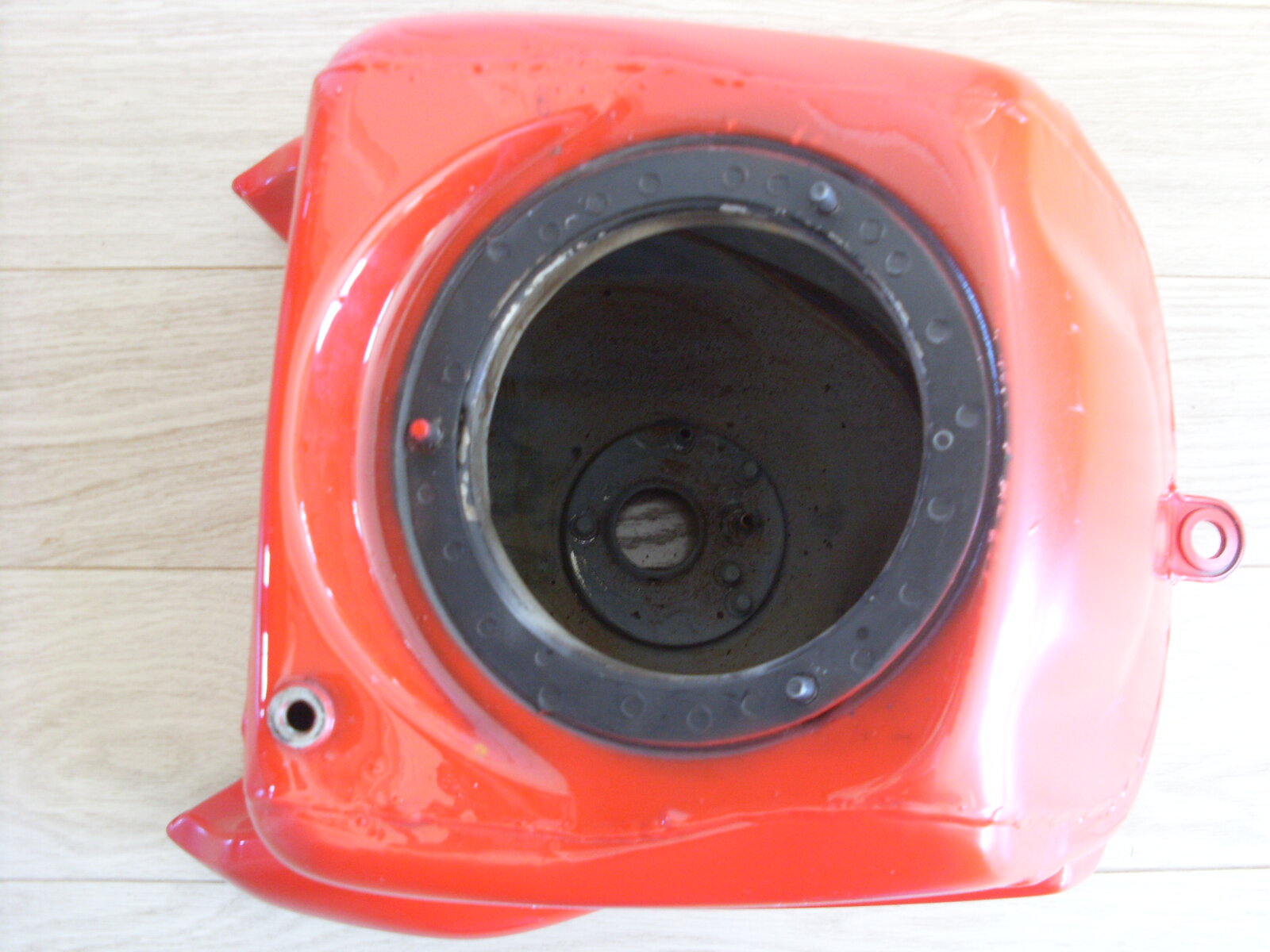

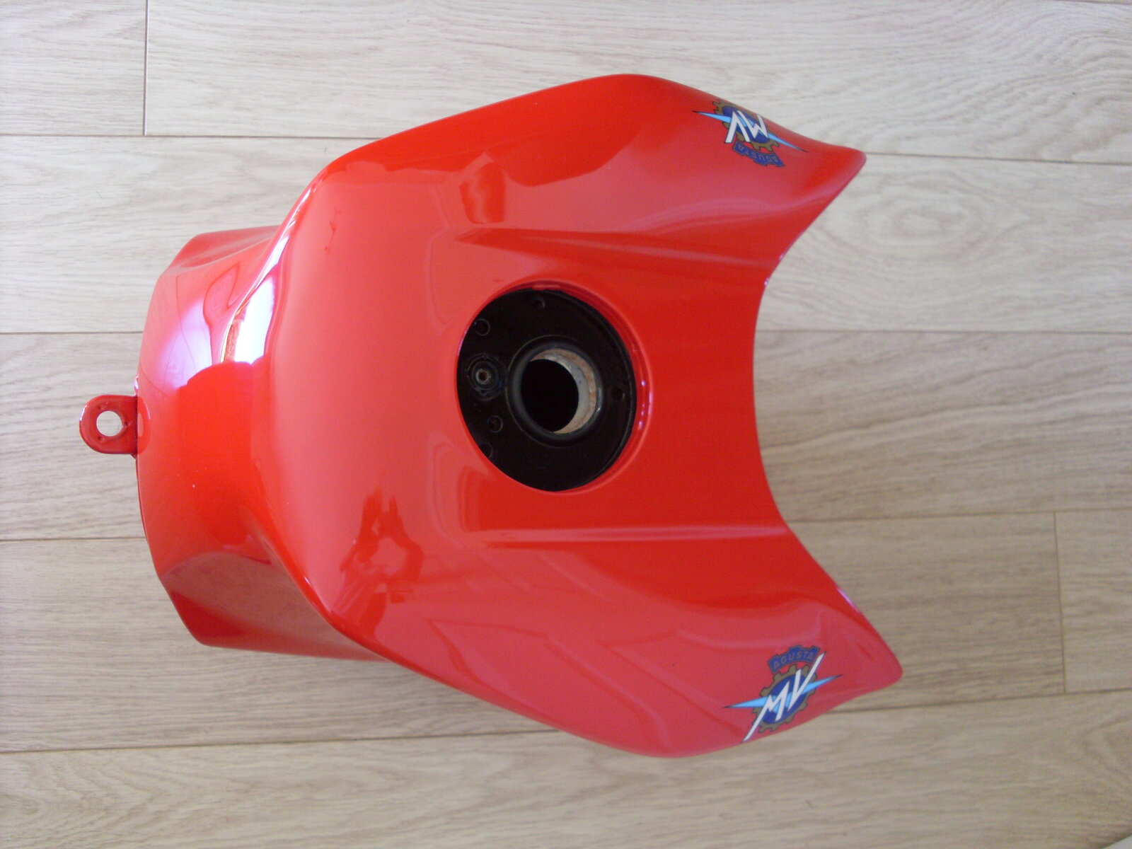

    I had similar on an MV Agusta spare tank a few years back (below) I went in with levers with the fuel pump removed and lifted the dent, but it was tough as old boots. I still needed to spot repair the basecost and clearcoat the full tank afterwards. I fear there is no easy fix to your problem.
