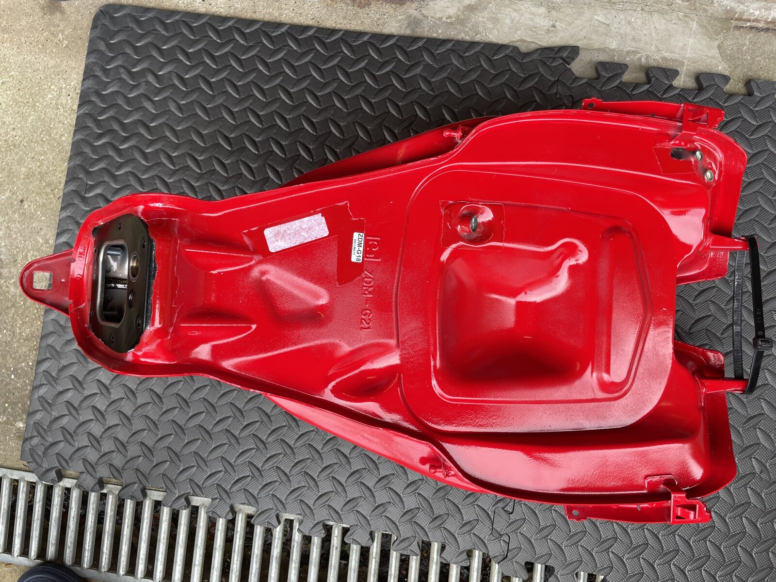

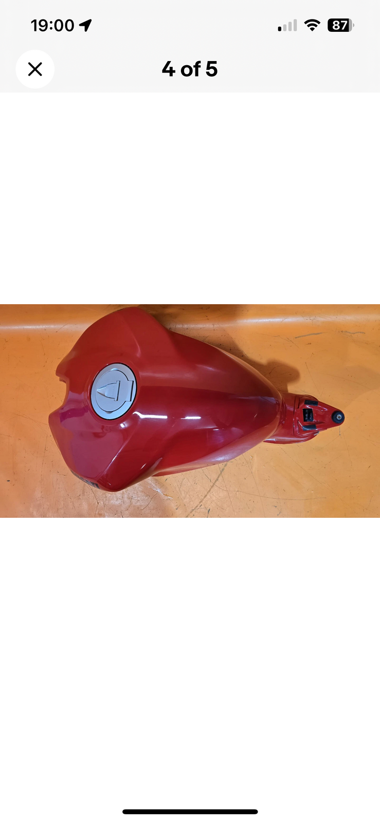

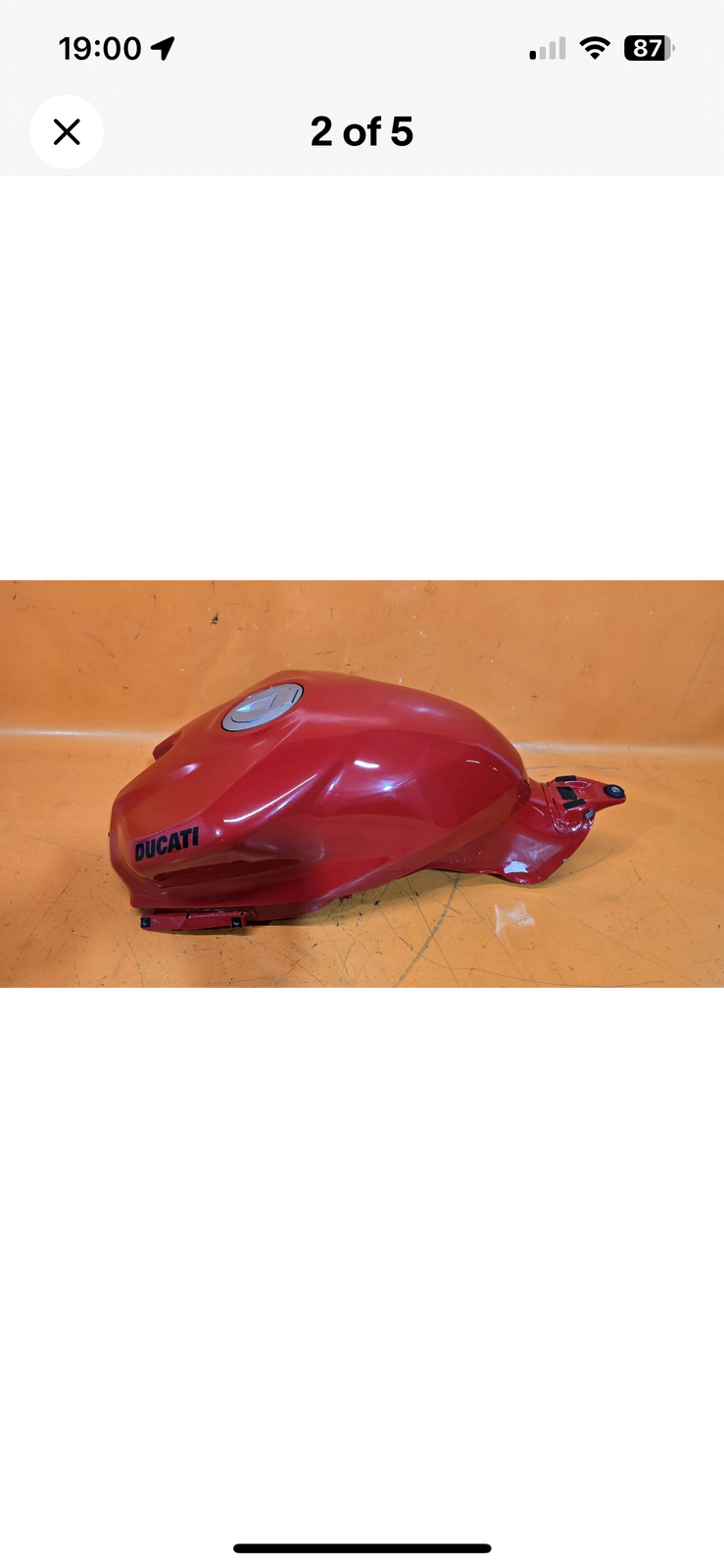

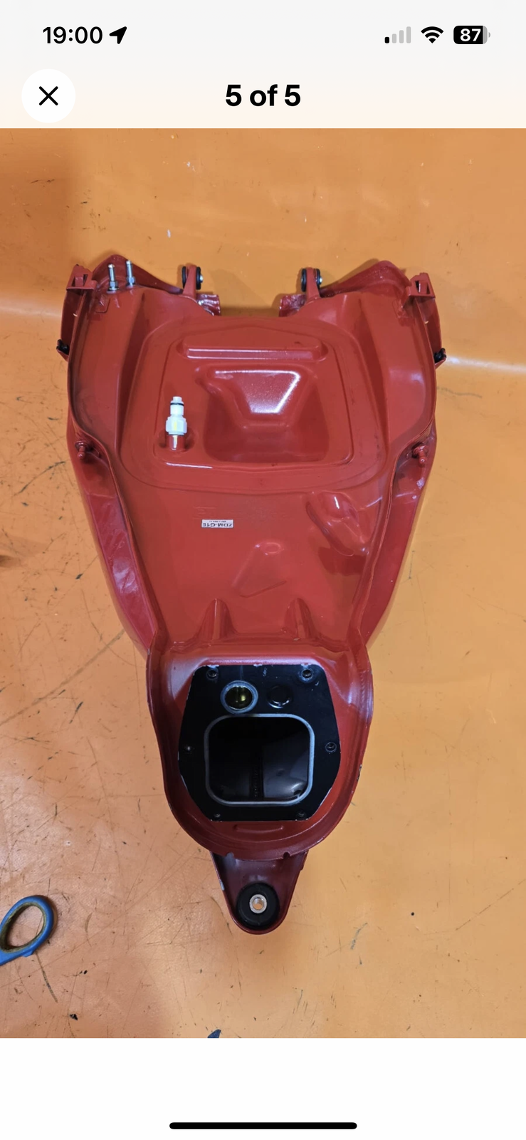

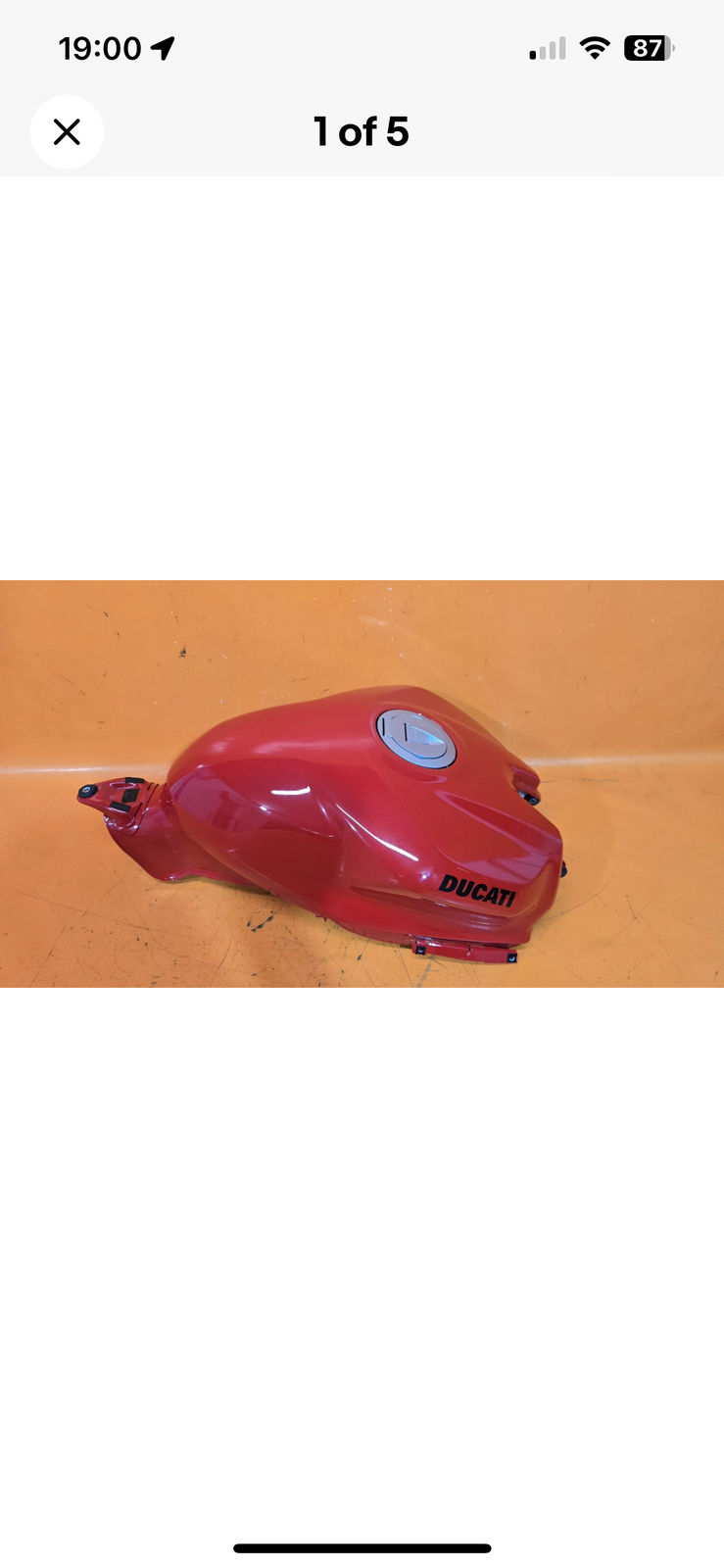

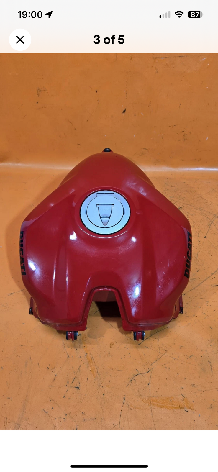

  3. Cheers - just found one for a street fighter v2. Looking at oem parts codes they are the same apart from last two letters which I assume is a colour code? Any one confirm or tell me that it won’t actually fit? Thanks
  4. Not sure. Expect you are right as frame etc are identical. Have you got any pictures?

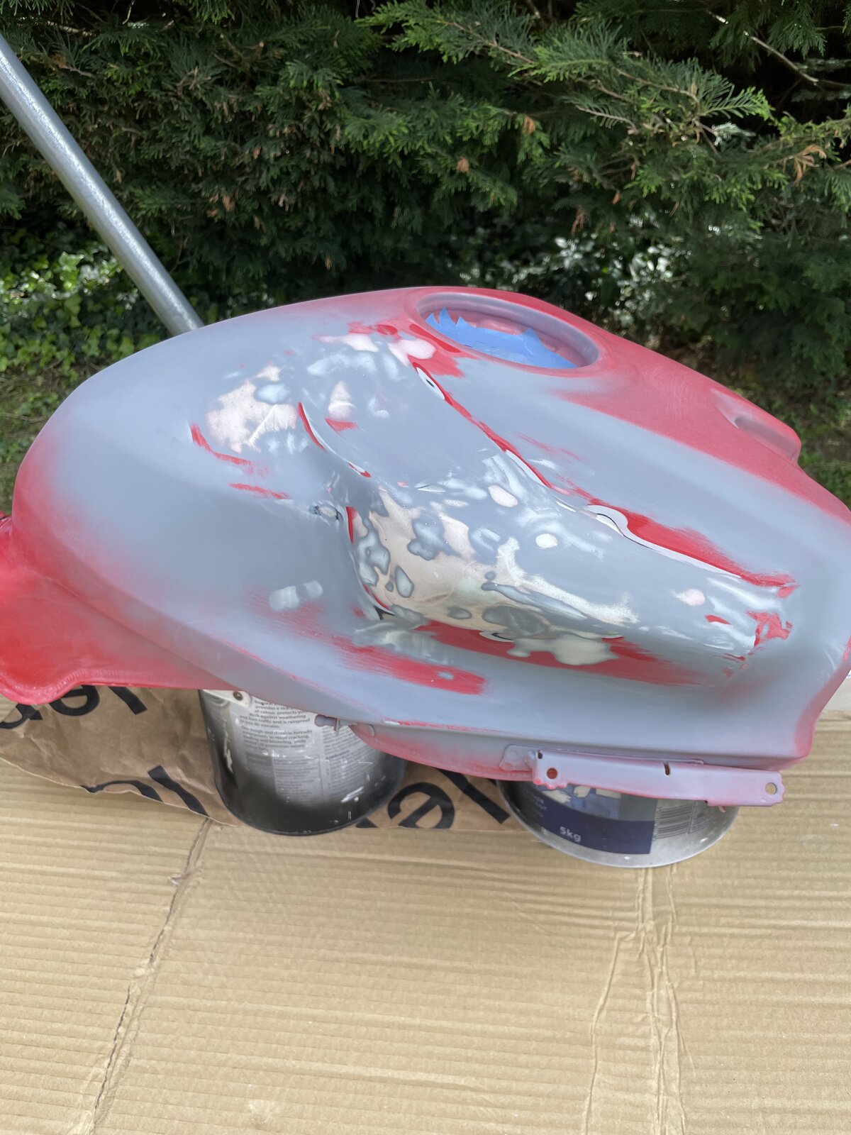

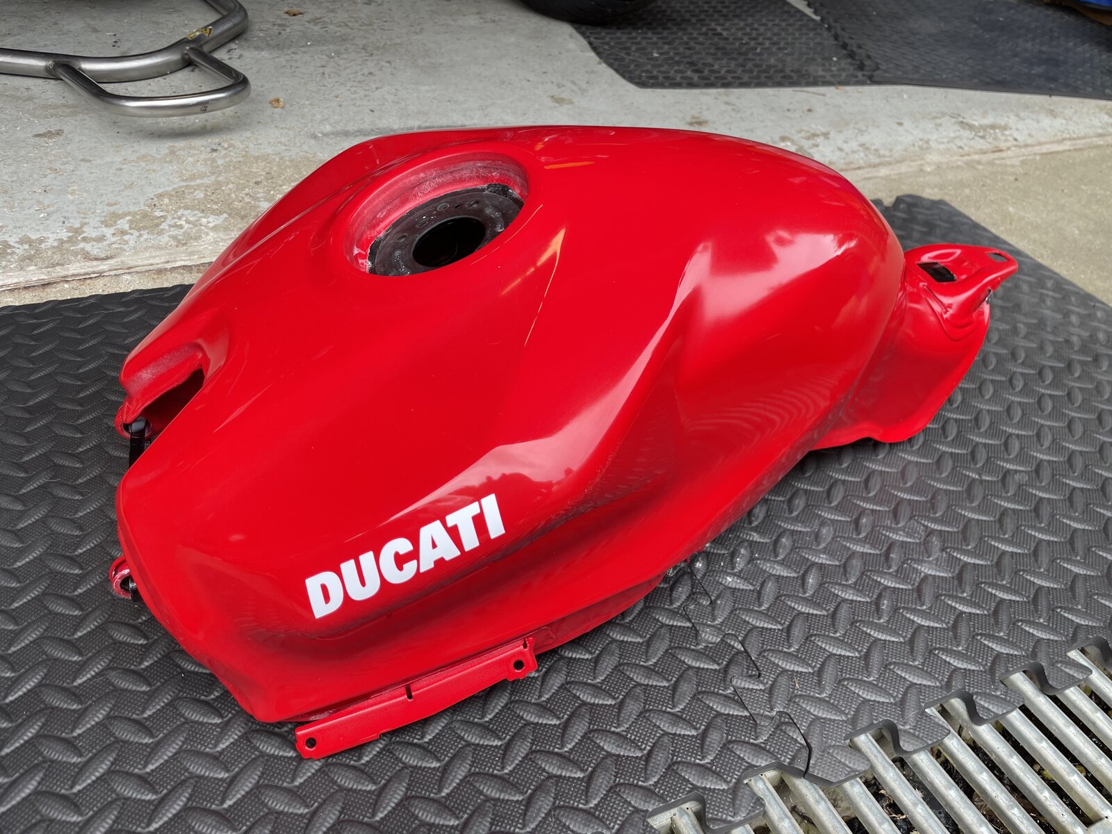

  6. Yeah. That looks perfect. Here’s a shot of a tank off a v2 I repaired and sold last year. I wanted to see the fairing mounting brackets and they look the same to me. The tank badge is easy to remove and replace too.
  7. Thanks for your help - that tank repair looks mint - think mine is a little beyond a bit of filler but I’ll see when I get it off. Went for the streetfighter tank - will update once installed
