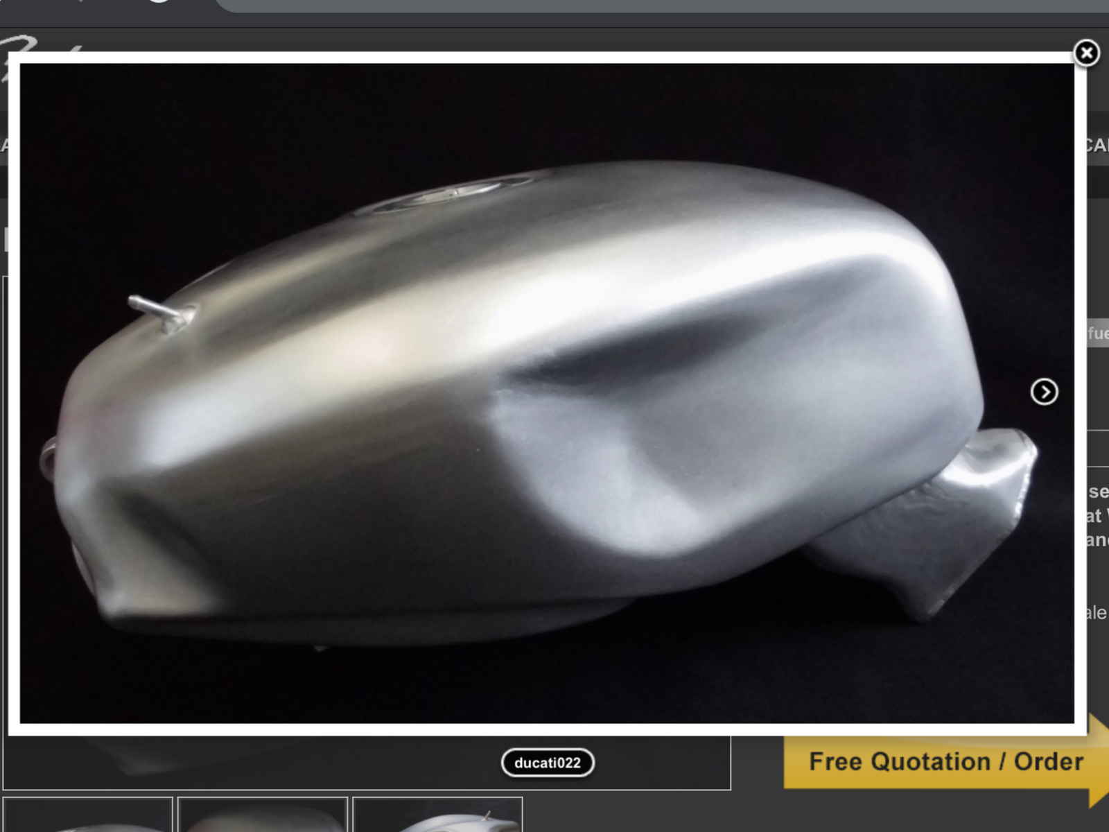

  2. Can’t find an exact weight for either tank but found a link saying the alloy tank is only .5kg lighter, (not sure how accurate this is).
    Go for a Beater alloy tank. 20L and only 2 odd Kgs. And all that for just £1,900 + shipping! :)
