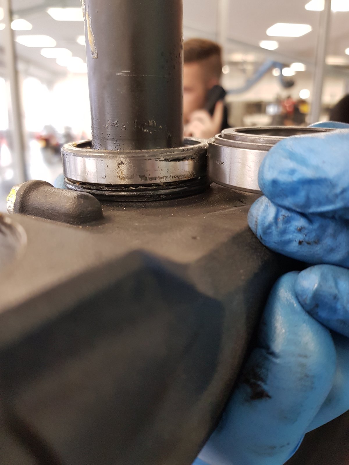

  10. Here is the difference
  11. so 35/55 ok but height not?
