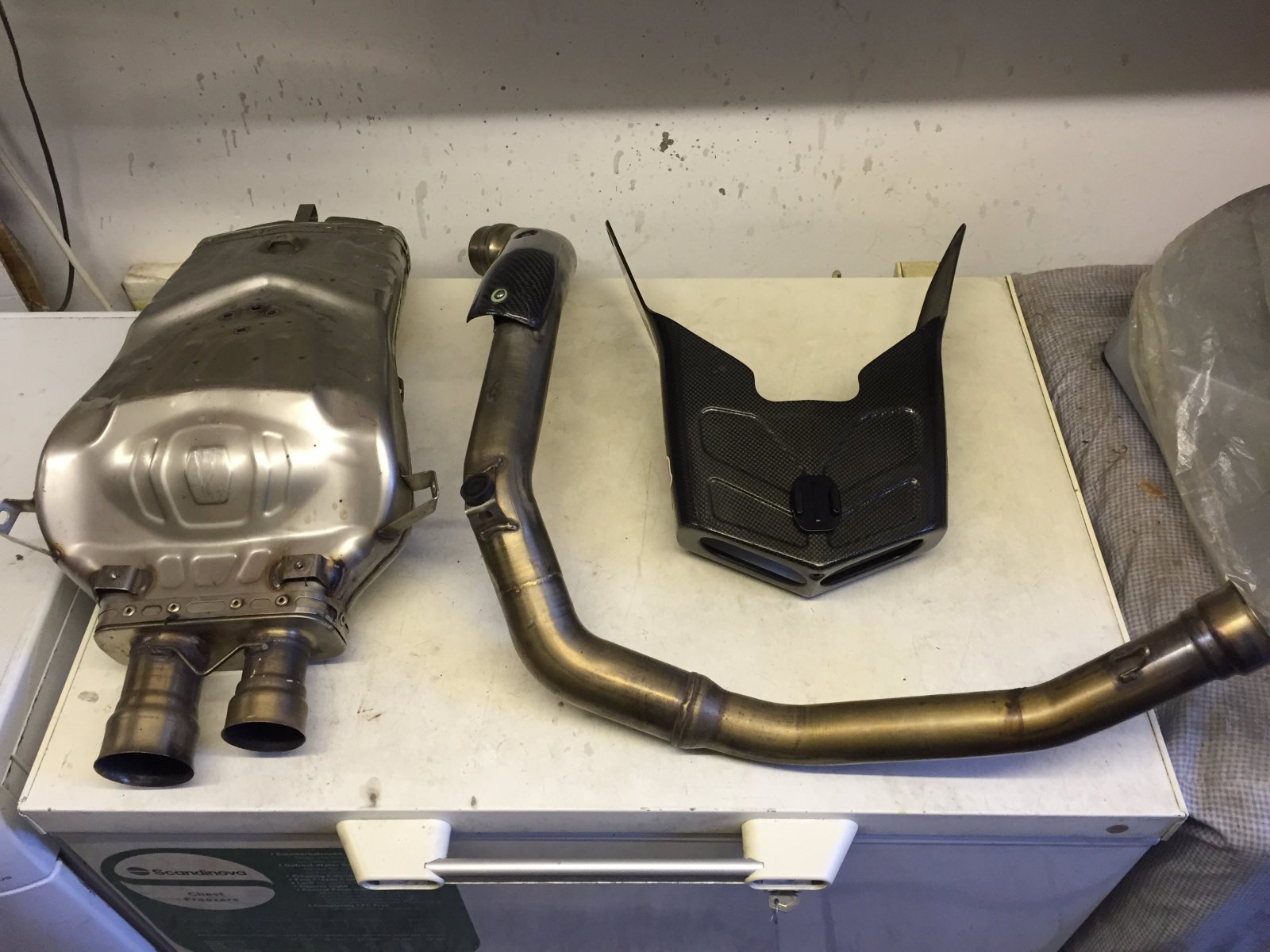

  2. I have a slip on and decat pipe which I believe is for the black swing arm as it does not fit the grey swing arm model
  3. Pictures as requested
  4. What bike did this come off of?
  5. I brought this off eBay long time ago and was told it would fit the grey swing arm. The pipe does not fit the grey swingarm so I only used the end can. I assume it's for the black swing arm
  6. Does it hit the grey swing arm or is the connection to the engine wrong?
  7. It fits the connection but wrong angle
  8. Right, so the question remains isyiur bike a deep sump or shallow? And is mine deep sump or shallow? Opinions are somewhat devided. Guess i'm gonna have to pull the fairing to check. Or if anyone knows a better way?
  9. These are the things you need to consider when buying a Termi kit.
    1. Grey swing arm
    2. Black swing arm
    3. Normal sump
    4. Deep sump
    For my 2003 999 I need a kit that addresses 1&3 so that the link pipe is correct. A 2003 999S needs 1&4. Your 749 needs 2&3 and the link pipe will fit correctly.
