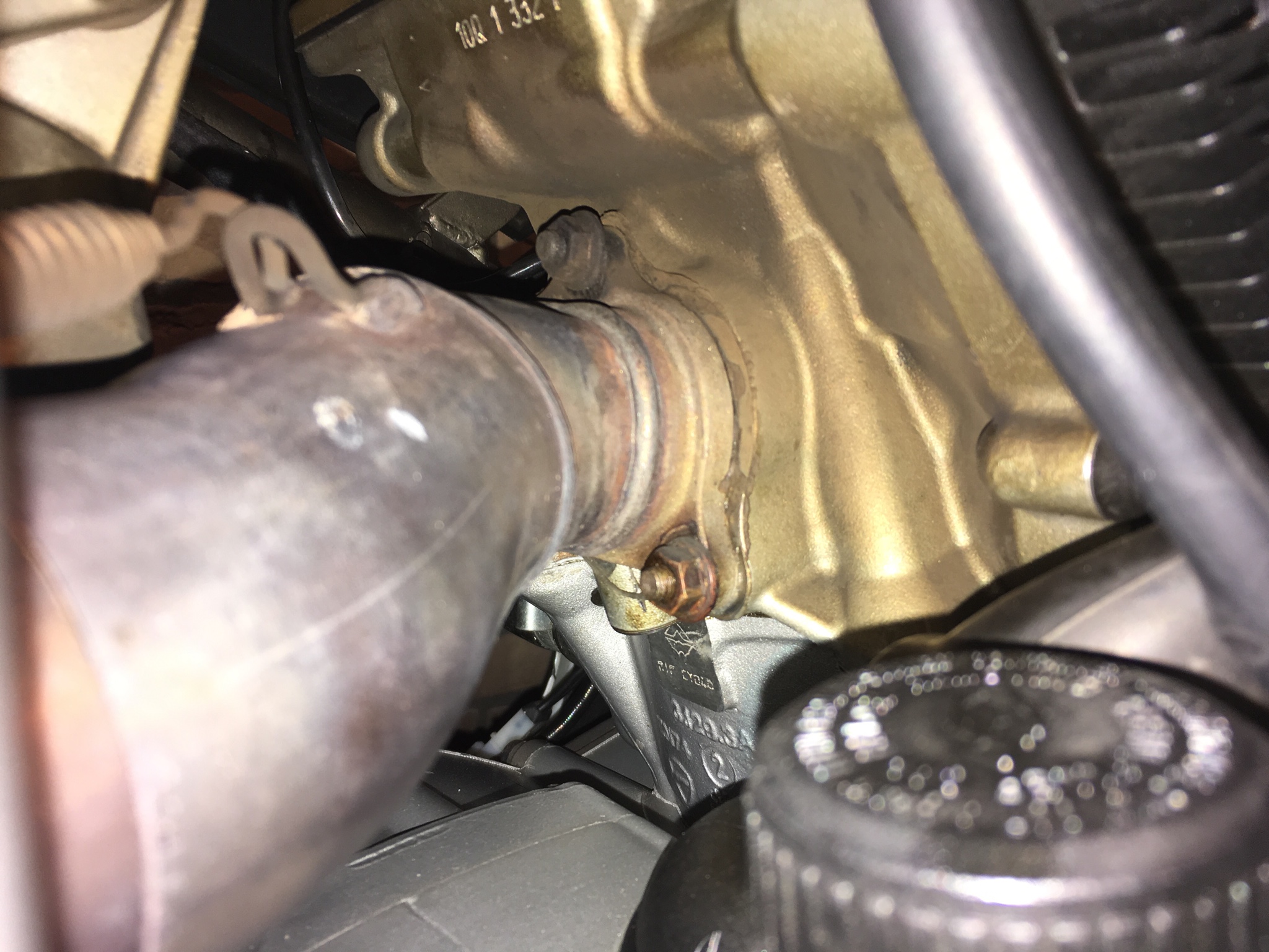

  1. Hello,
    I have a question. With my OEM 848 engine my 70mm termignoni system the manifolds pipes fits properly. But now with the 1198 engine i think its not fits properly. I think the header manifolds from the termignoni systems is bigger for the 1198 engine, is that correct?
    And does somebody know if you can order these manifold pipes?
    Thank you!
    Verzonden vanaf mijn iPhone met Tapatalk
  2. correct.
    The bolt spacing on the 1198 is wider.
    i believe some have modified the header/manifolds either way to fit, although not done this myself.
  3. Ok so only the bold spacing is diffrent? Now i have this, so i understand the pipe is not bigger?
  4. No, the actual header has a wider diameter opening also, but it's only a couple of millimeters. The rest of the pipe has roughly the same dimensions between 848 and 1x98, so that you can swap headers and use the rest interchangeably.
