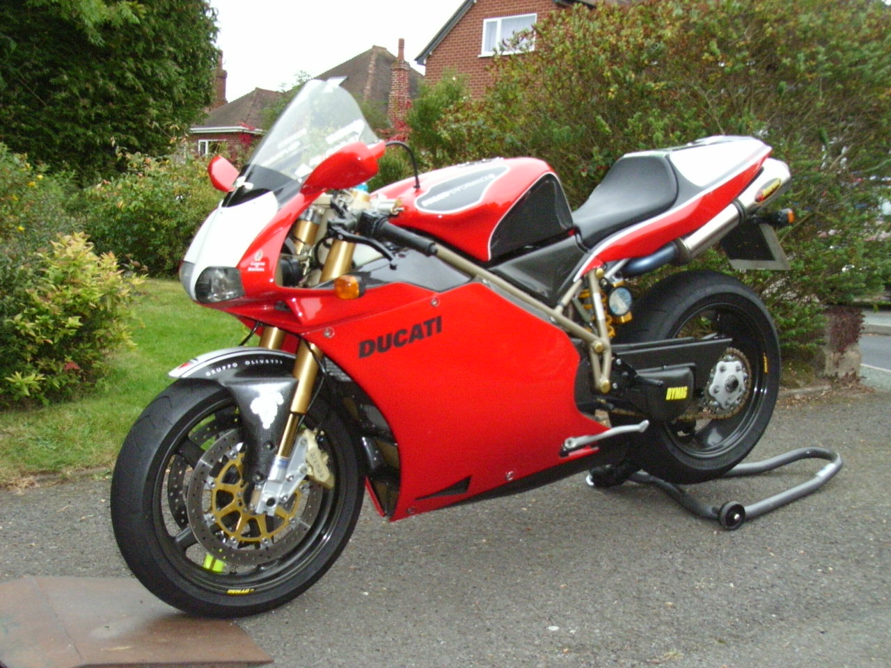

  7. Sweet ride mate.

  8. Thanks mate.

  9. Lovely looking bike that :upyeah:
  10. Cheers mate.Here another gratuitous exhaust pic.The great thing with full titanium end cans/pipes is they go nice and blue and weigh fuck all.
