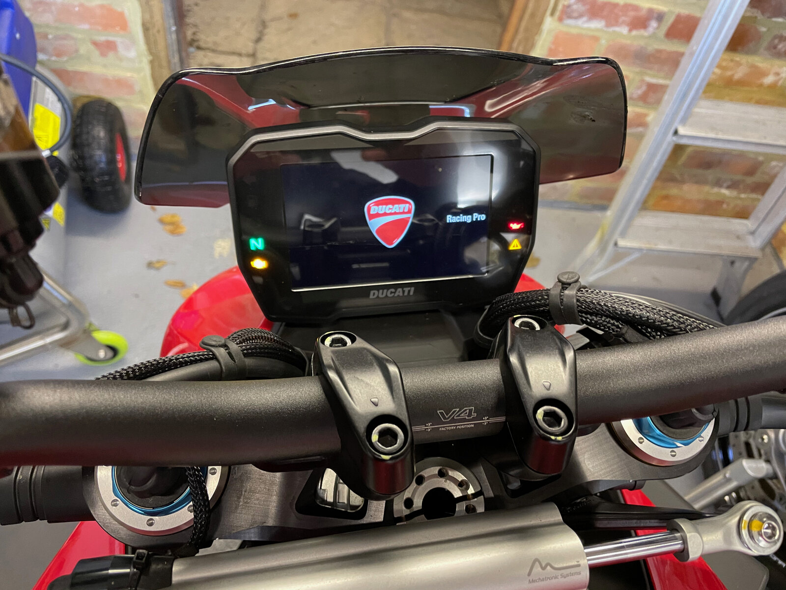

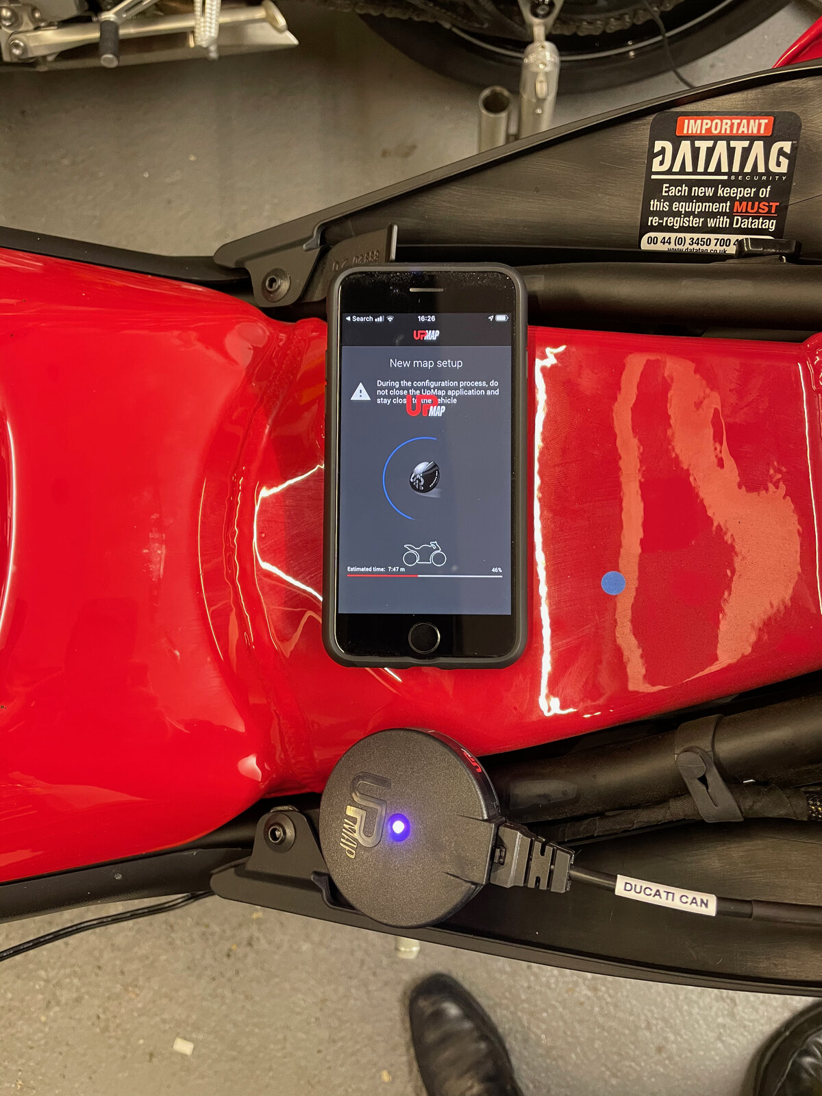

  6. T-800 acquired, and maximum torque map loaded. Just waiting for the sun to come out for a moment or at least the roads to stop being damp and greasy to trial it. Switching maps is not a quick process (about an hour copying off the current map, and then copying a new one back onto the bike) so immediate back to back comparisons may not be possible without having a day or so to play.

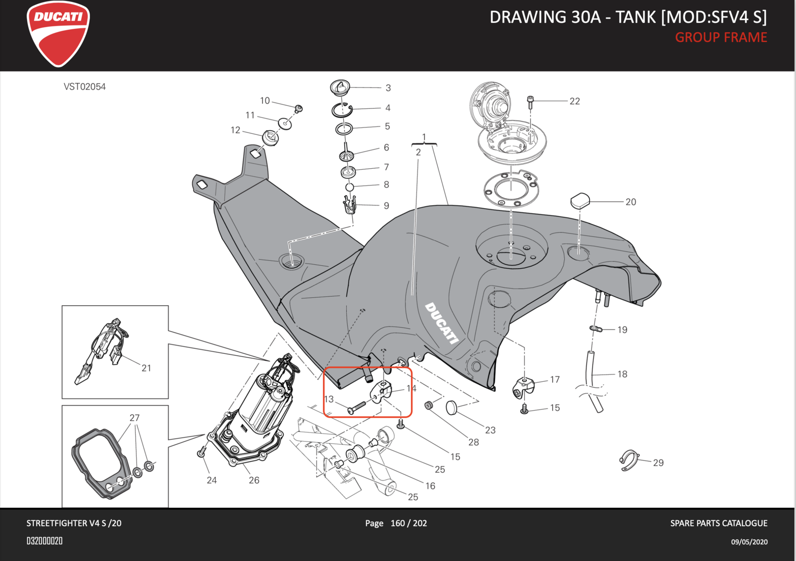

  10. Still no verdict on the new map with the O2 sensors disabled. The weather has not been kind, but the main problem at the moment, is I can't move the fuel tank to get to the rear sensor. You need to remove the two bolts (10 in the diagram) and two screws at the side of the tank (13 in the diagram) in order to lift the tank sufficiently to reach the wiring. However, the RHS screw won't come out - its just rotating. It locates through a damper into a captive nut welded to a bracket (14). It may be that the weld has broken, as the screw rotates but will not retract. What a pain in the arse. I'm going to order replacement parts, and then see if I can remove the screw using a more robust approach. I love this bike, but actually riding it is becoming a very elusive pasttime.

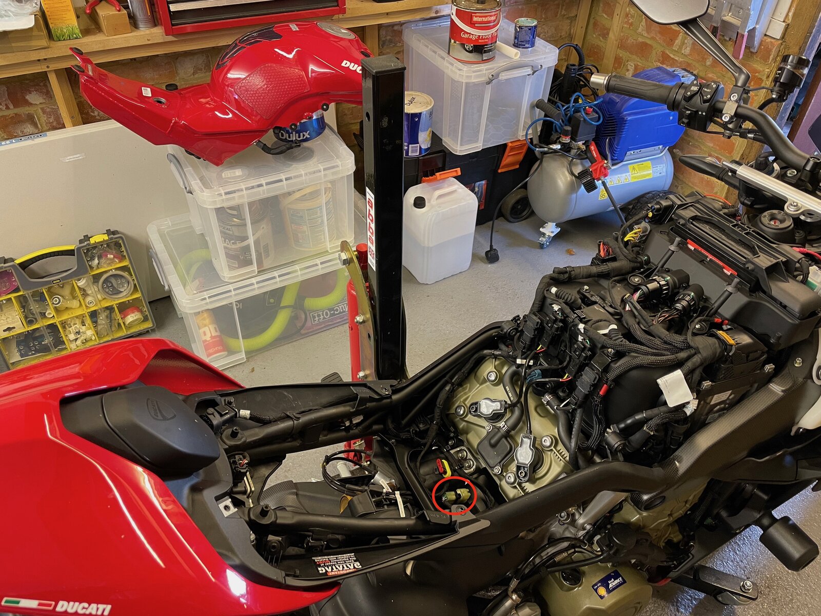

  11. Finally got everything done. Screw 13 had threaded itself in part 14. I had to remove the tank completely and replace both of them. At least that made disconnecting the under tank sensor straightforward. To be honest its pretty hard to split the connection as it is zip tied to the bracketry on the rear cylinders.
    The front lambda sensor is actually pretty easy to find and disconnect as long as you get down low enough to see it just forward of the alternator.
    I managed to put on all the crash protection before venturing out for an 'essential' test ride.
