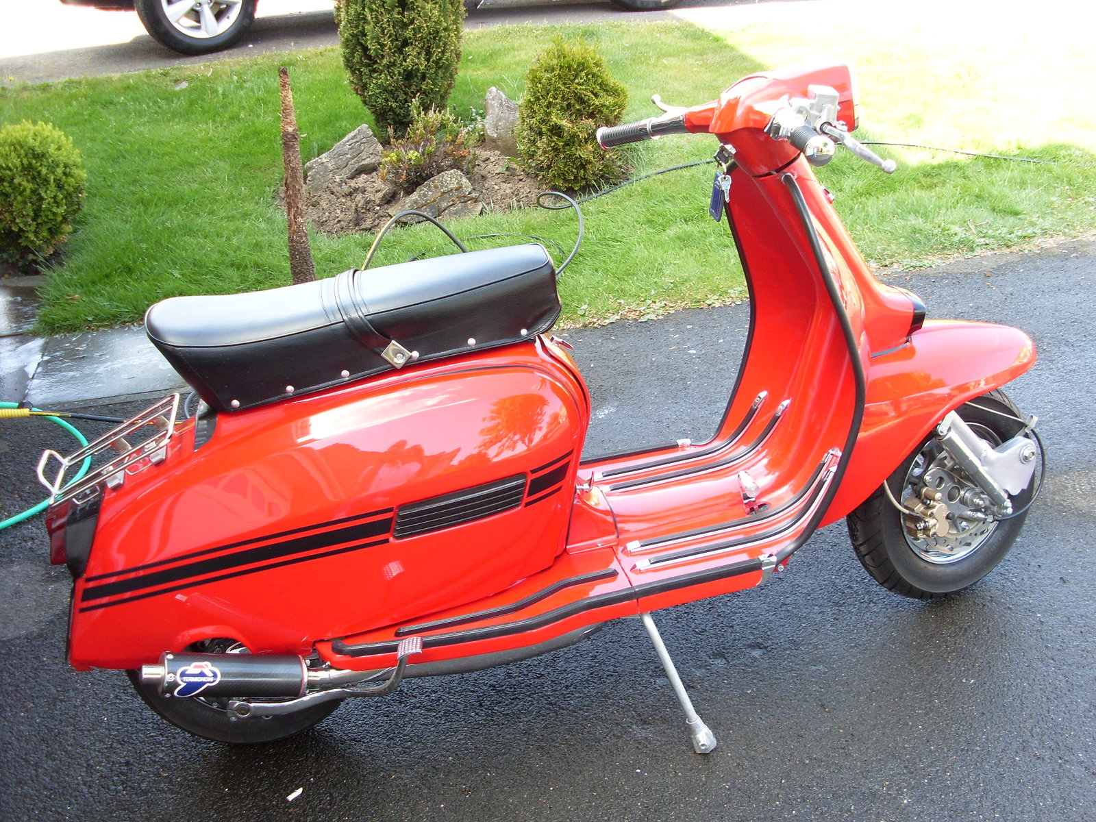

  2. I put a bit of carbon fibre wrap and a Termignoni sticker on the Vietnamese exhause of my scooter a while back. :)
    100% genuine it was , guvnor. :laughing: **
    **Well, maybe the sticker. ;)

  3. Thats a lovely scooter mate :upyeah:

  6. Lovely scooter Robarano.I had a Lammy back in the sixties,was great fun.
