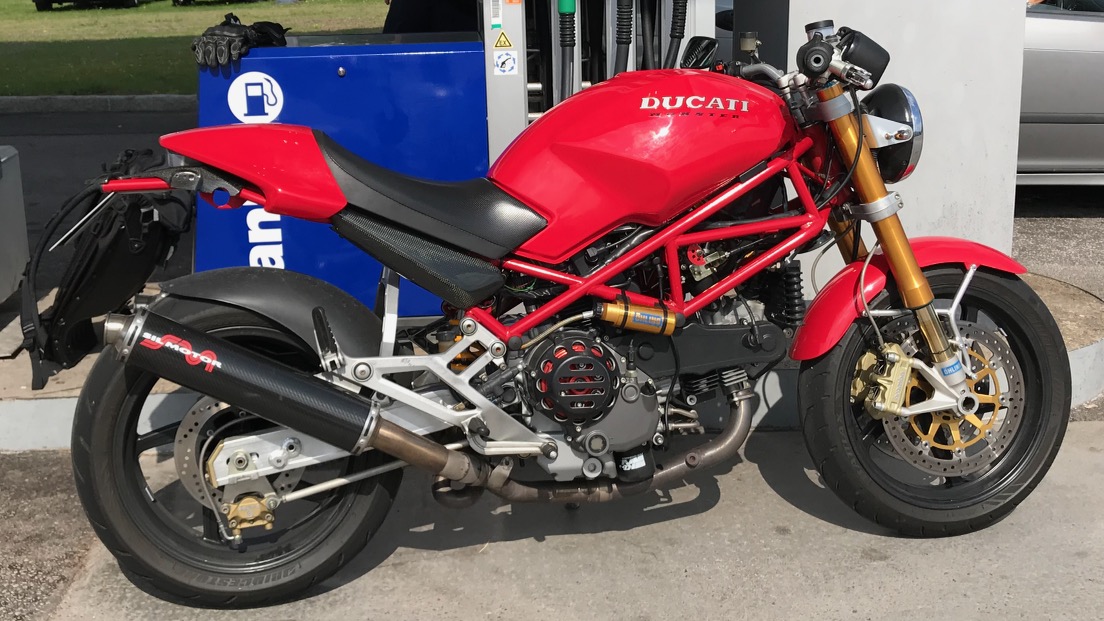

  12. I have owned 2 monster 1100 Evo before. I wanted an 1100s now, considering öhlins front and rear, among other things. I have bought myself a fantastic 1100s, but I have been unsure what is the difference between the engines on these? That's why I started this thread. When it comes to mapping the ECU, as well as the air filter combination, I have very good experiences with the following combination. MWR air filter together with Hypertrick mapping from Italia Bike Center in Arboga in Sweden. 20210212_123608.jpg 20180214_152806.jpg 20180215_152109.jpg

  18. The monster has been owned by an Italian who has worked in the motoGP and SBK circus. Through his job, he has had a unique access to both components and competent employees. This is some of what has been done with it.
    - Ohlin's fork tuned by SBK mechanic
    - Mupo rear shock
    - SBK slipper clutch
    - HPE exhaust
    I really want to mount an NCR FACTORY RACING CAMSHAFT KIT in the engine. What is realistic power boost with this kit? It is claimed 20% power increase!
    A race map, MWR filter and HPE race exhaust will also be fitted What do you think about this hnracing?
