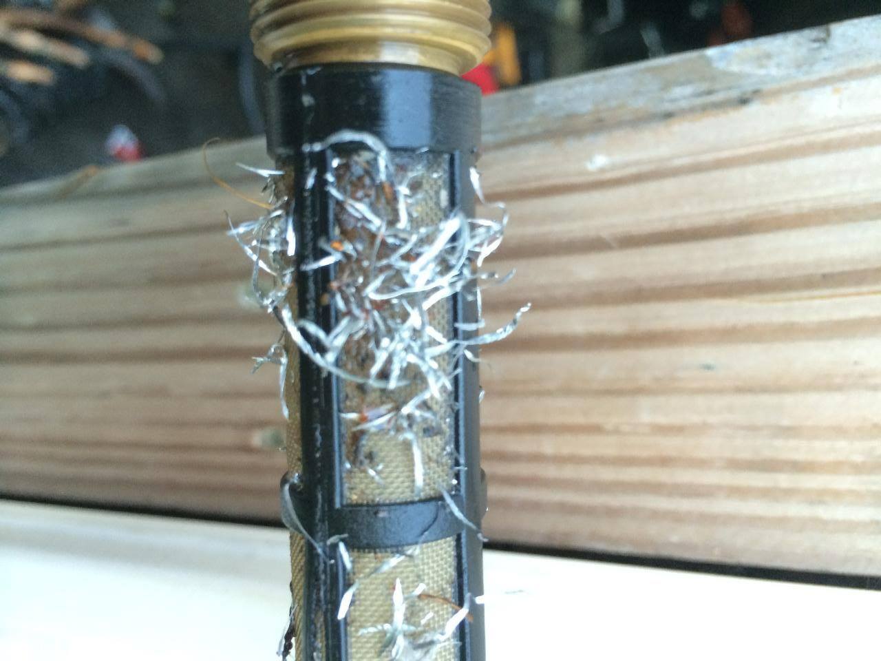

  4. It's not about fixing it without splitting the cases - and you're right; that isn't possible. It's about checking it without stripping it. I spotted the plug on my 996 was loose and wearing on the main bearing by luck while I was refreshing the top end, and up to then it had held for 54,000 miles (that maybe answers your points too, expired road racer) so, you can maybe better understand why I don't want to rely on luck alone...

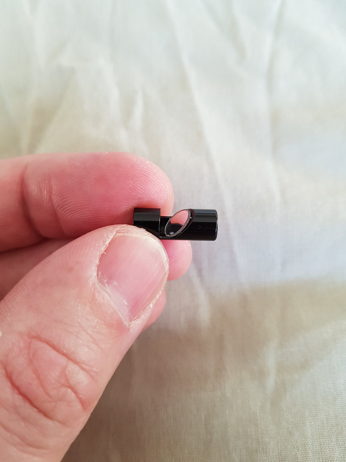

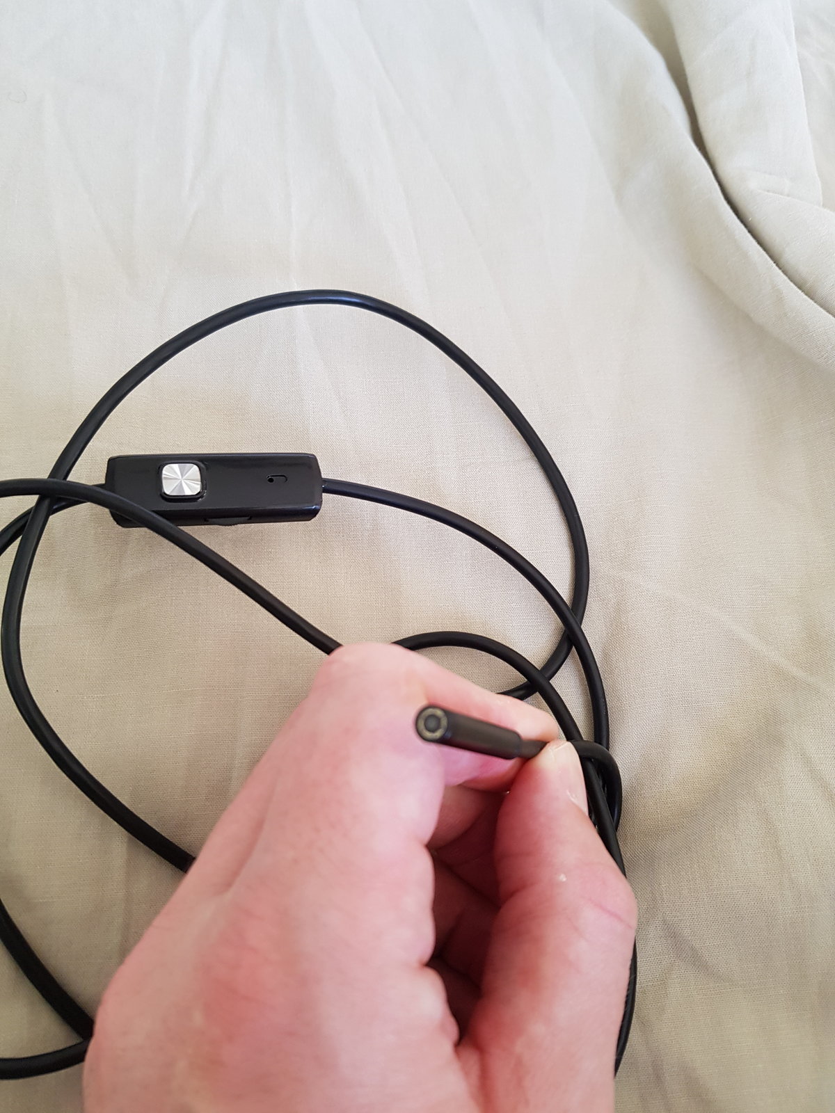

    What I may suggest is purchasing a cheap flexible camera off eBay such as the one pictured. It runs off my tablet and has lights on it. You would be able to put this into the strainer hole and probably give you a better image than a mirror. Cost me about 5 quid. You hear the stories of these backing out but mine was in there really tight as it was aluminium punched around the edge so it was pretty good. I replaced it though as the 2 smaller plugs on the crank were a mess, someone had chewed up the allen key hole so I drilled them out to install new, I then had to replace the larger plug to get all the shavings out. I punched the edge and used thread lock. It's not moving. If you can check it here it'll give you piece of mind.
    Just found the little mirror attachment too. Came with it. If my engine hadn't just had an oil change I would test theory out.

  12. Hi Jon, did you get a boroscope and attempt to view the gallery plug?
  13. image.jpeg Hi Mk9. Yes, I got one and tried every which way from the coarse oil strainer cavity, the oil filter recess and through the sump plug hole, but I could not find any place where I could get a view of the gallery plug without taking off a cylinder. It may still be possible, but I didn't succeed. As there was no evidence at all of alloy shavings on the strainer screen on the 900ss, and I was just checking as a precaution, I am just going to run it until I have a reason to remove the top end, and will check it then.
    In contrast, the coarse screen on the 996 had been a real swarf factory last year despite only the first mil or so of the loose gallery plug being turned down, as you can see in the pic, so if that is typical behaviour, it looks like it gives a good bit of warning well before it gets terminal and you lose oil pressure.
