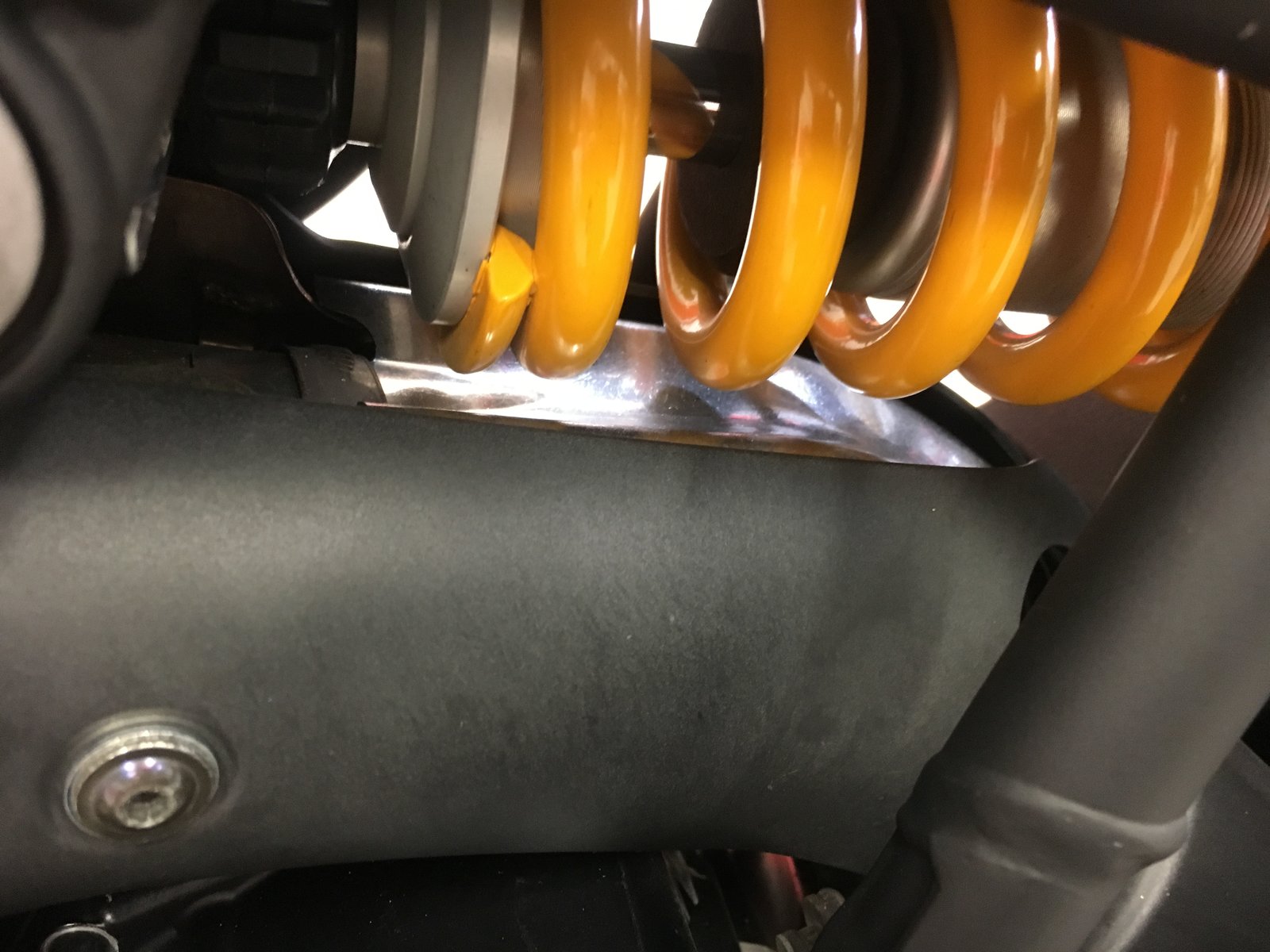

  1. Didn't know how many of you were aware but there is a recall to fit another heat shield above the rear header and under the shock. The issue is overheating of the rear shock absorber, the standard bike suffers worse with bump stops melting. Mine was done yesterday when it went in for heated grips to be fitted.

  3. I got the heat shield fitted today along with the heated grips. No wonder the grips are so expensive. I though that on the RH side the twistgrip tube would be replaced with one with the heating element in it. But no, the whole throttle assembly gets changed c/w with the RBW potentiometer. Ah well, I've got a spare now.

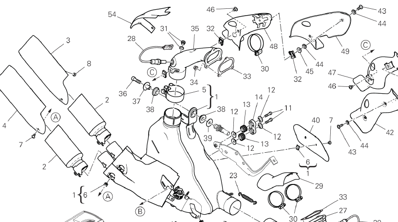

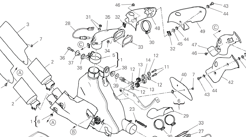

    I brought a Supersport 939 in December , second hand. Last week I got a Termignoni and a couple of days ago I went to replace from the original. When putting I back together I notice a metal top shield but could not find where it is. Why did you had in the first place?
  5. I'm not sure what you are asking but this diagram from the 2020 parts list shows the shield, item 54.
