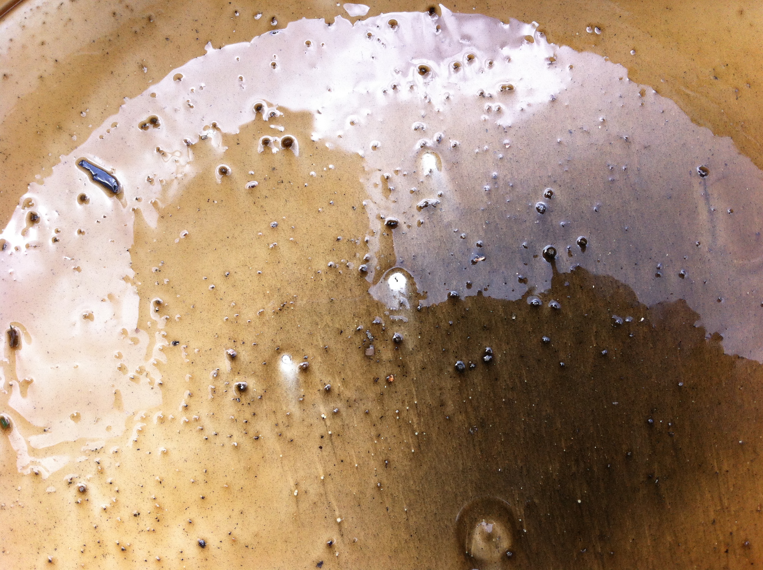

  1. My 1098 suffered a loss of power and an unexpected stop on Saturday morning....:(
    Panning for copper....:eek:

    Did you go?
  4. No. I'm too skint for the near future. My mate Jack did on his 675 trumpet.

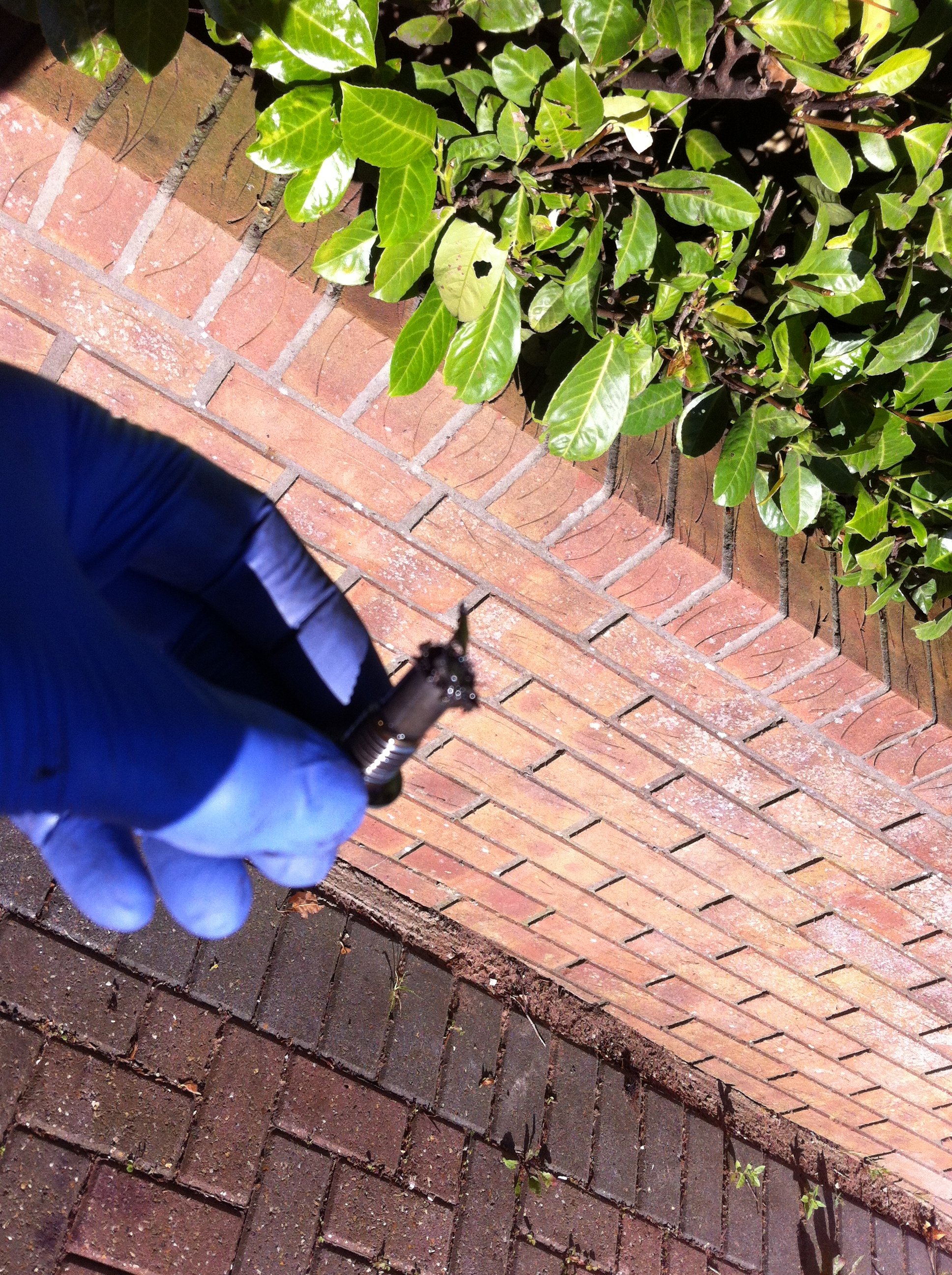

  7. That looks as if it could be expensive, i'm thinking i'd be better off keeping my SP as an ornament (not that its done f all this year).
    Is it crank or gearbox bits stuck on the sump plug?
    Good luck with it,
    kev.
  8. Bike will be harvested for a few parts then broken.
    Looks like big end bits.
    The sad tale....
    I was out for a ride sat morn and the bike suddenly kind of felt wrong and under powered, I rolled off and came to a halt, (sure I could hear some metallic sounds) the bike then just stopped/cut out on it;s own,
    I tried to restart, but the bike, sort of sounded like it had a flat or low battery.The AA man arrived and tried to jump it, but exactly the same, even of a jump pack.
    Got the bike home and had a fiddle with a new rec/reg and even a new ecu. Bike started very briefly but still exhibited the same metallic grating noise, then stopped again, then back to slow/lazy turnover on a good batt.
    I can only assume the bottom is seized, although it will spin with the plugs out!?!?!
    Drained the oil today and you see the results...:(
