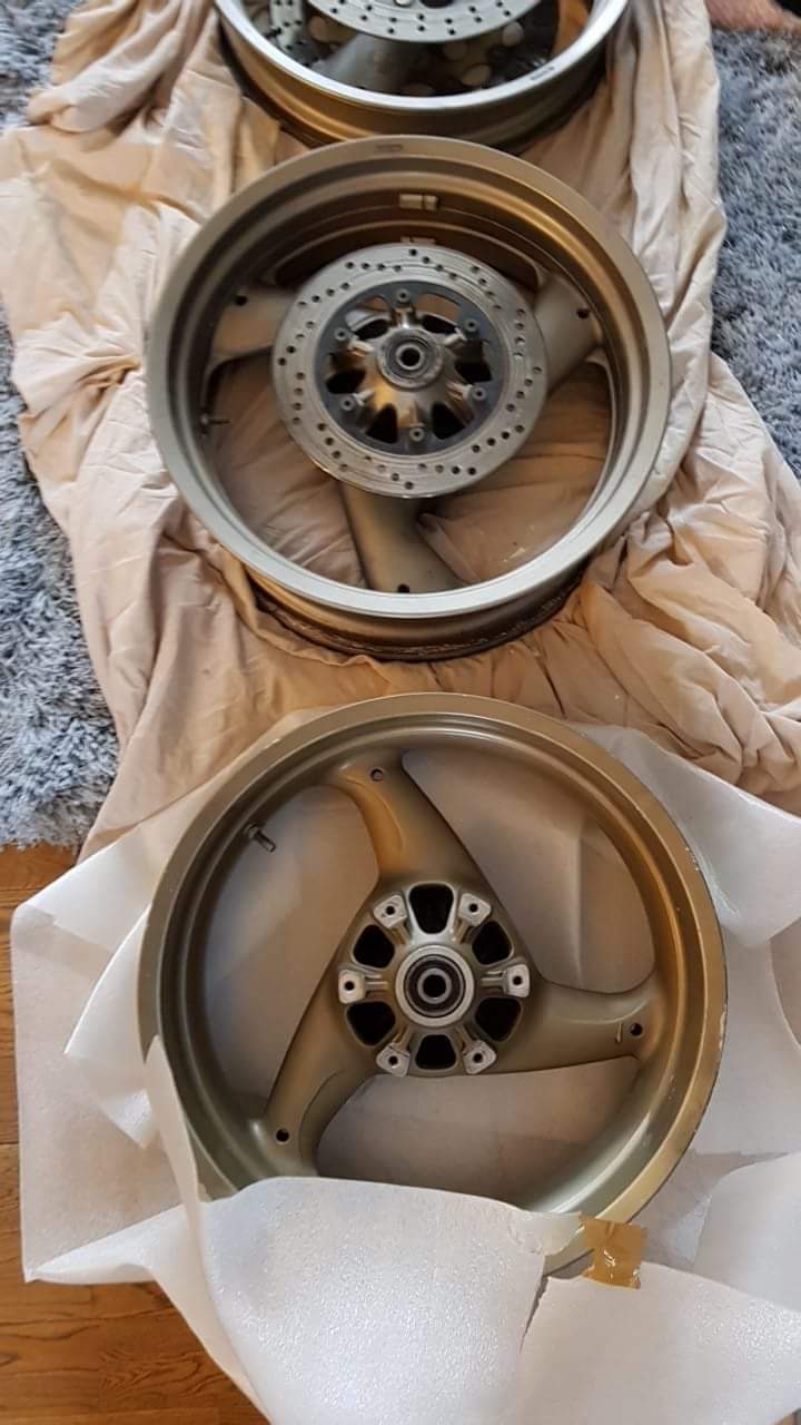

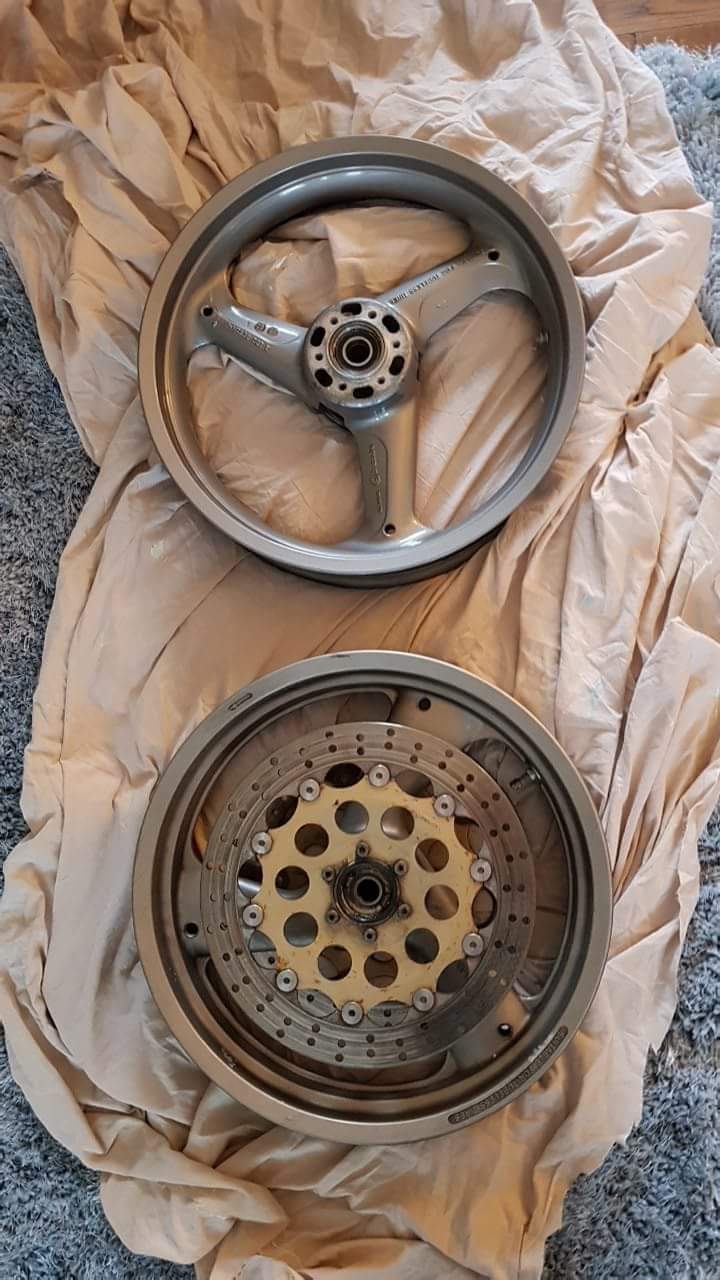

  1. Finally got round to weighing these today, something I've been meaning to do for some time. The thick spoke Brembos are the standard on my SS, the thin spoke from the later IE model, for anyone who is not familiar. There's allegedly a worthwhile difference in weight so I wanted to see for myself, being a bit cynical. Weights without discs but include spacers and bearings.
    Thick spoke Brembos
    Front 5.1kg or 11.2lb
    Rear 7.4kg or 16.4lbs
    Thin spoke
    Front 4.8kg or 10.6lbs
    Rear 6.7kg or 14.8lbs
    Total difference
    FRONT 300 grams
    REAR 700 grams
    Question is, is it worth me go in to the hassle of changing them? I have to get the front spindle sorted as it's a different size, and get the wheels powdercoated so it'll likely cost a couple hundred quid, or do I save for OZ Aluminium or similar which will give me even more of a substantial saving. Can anyone with more experience in these matters, possibly racing where any weight saving counts, tell me if this weight saving of a 1kg (effectively 4kg of lard due to rotating mass) is worth swapping them for?

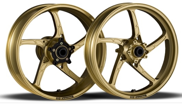

    I've lusted after fancy wheels for too long. In a moment of clarity/stupidity I pulled the trigger on these. It's bike likes yours Sev, that influence me on some choices. 8 weeks till delivery.
  7. If you are considering spending money on the bike then putting it into lightweight wheels is definitely worthwhile and one of my top priorities on any bike. You really notice the improvement on track when going hard but even on the road you can notice the difference especially when getting a bit of a lick on.
