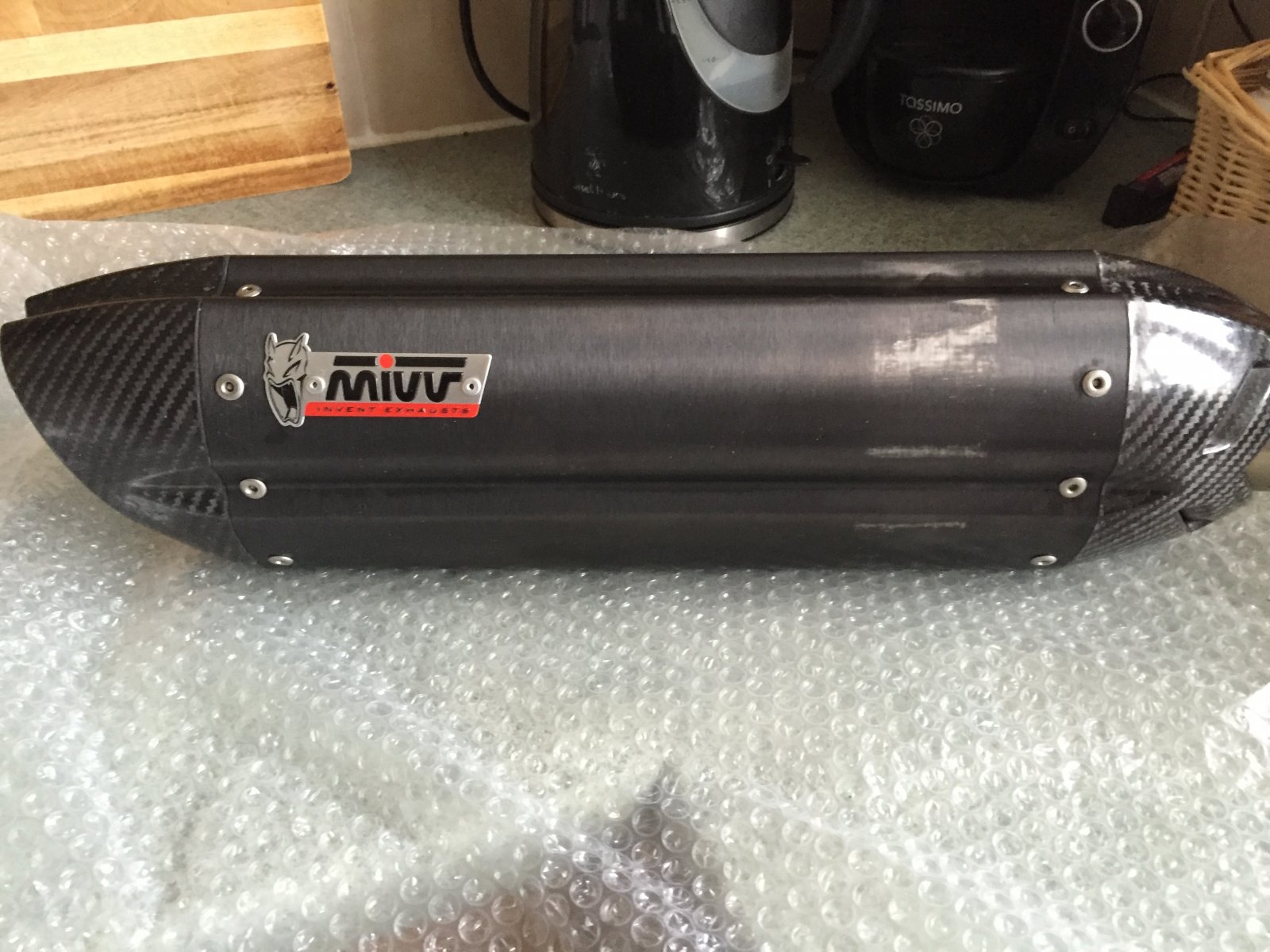

Does anybody have a good idea for what i could use to help protect my Mivv Suono exhaust? The carbon hanger supplied is extremely coarse and has taken off some of the black coating on the can itself. I purchased a generic exhaust hanger rubber strap off eBay to line the carbon hanger with, but its too thick and the hanger won't clamp fully to bolt up again. I need something almost as thin as a push bike inner tube which i can then stick on the underside of the hanger but I'm struggling to find something suitable..... other than buying an inner tube and cutting to shape and glueing using something heat resistant....god knows what Whenever i search for adhesive rubber i get lots come up about 'self amalgamating tape' but having never used it, i wouldn't know whether it'd first stick to carbon and then also not melt on to the exhaust can?

Some great ideas gents thank you. Just so you can see the damage it's doing take a look at this : That's only a week old.....not great is it. I think they've dropped a clanger with the hanger (see what I did there) Far too abrasive in its raw carbon form with no under protection. I might get it shortened if I can get a fix
