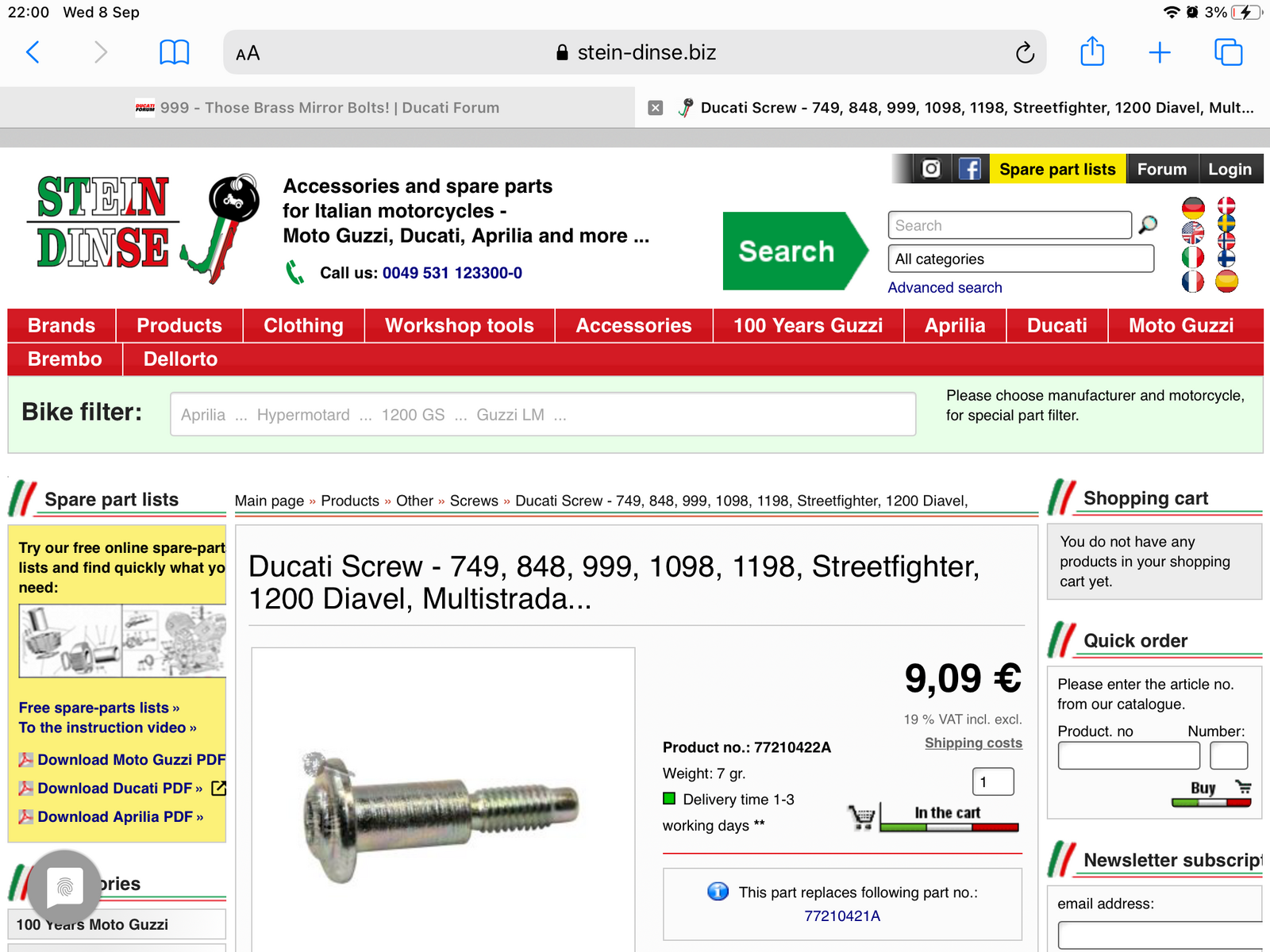

  2. Look like these?
    https://www.stein-dinse.biz/product_info.php?products_id=11659
    Fast edit if anyone has another pair after wasted has taken the first pair I need a set. :upyeah:

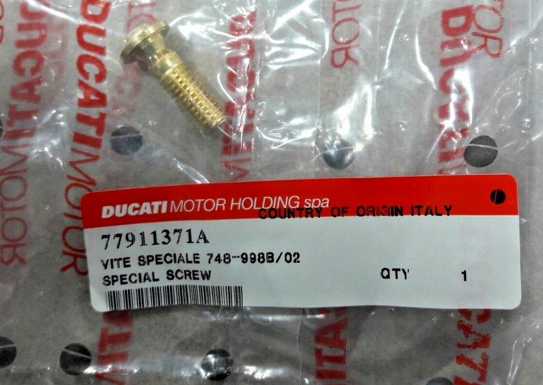

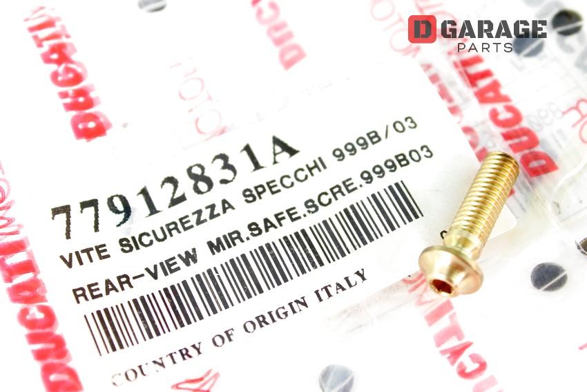

    when you said brass it made me think of the 748 type of fixing, and lo and behold it does look very similar if not identical and using Sev's number it could be just a superceded part number.. maybe. :thinkingface:
    As Chris said, vastly cheaper than £30 - these came out at just under a fiver (UK).
  6. Not sure, it appears the 748 are different. At least to me they do the break appears to be further up the shaft on the 749 than the 748?:thinkingface:

  8. dem two pictures are there N, and look mightily similar to me, and even if subtly different, prob still interchangeable?
  9. Ah all is clearer, those 2 pictures are the same but different from the Stein Dense picture below. The part number is different between the 2 pictures in your post but the same product to fit the 916 based design? Which won’t fit correctly or break in the correct place. It’s a fair reach before you reach the thread on the 749 mirrors.
    DAF173A2-7338-4087-B975-855C7885B443.png A3D6E236-460A-454E-A821-A5B721047D16.jpeg
    #9 DucatiScud, Sep 8, 2021
  10. 748/996 etc are different to the 749/999. Thread is the same I think, but length is different. 1098/848 are different again.
    All still available and from what I see, cheaper from your dealer than eBay ;)
  11. Thanks for clearing that up Nigel, strange that it's shown in* an official looking Ducati bag with that part number on it, (and obviously wrong then).
    *i've just twigged, it's on top of the (77912831A) bag.. :rolleyes:
